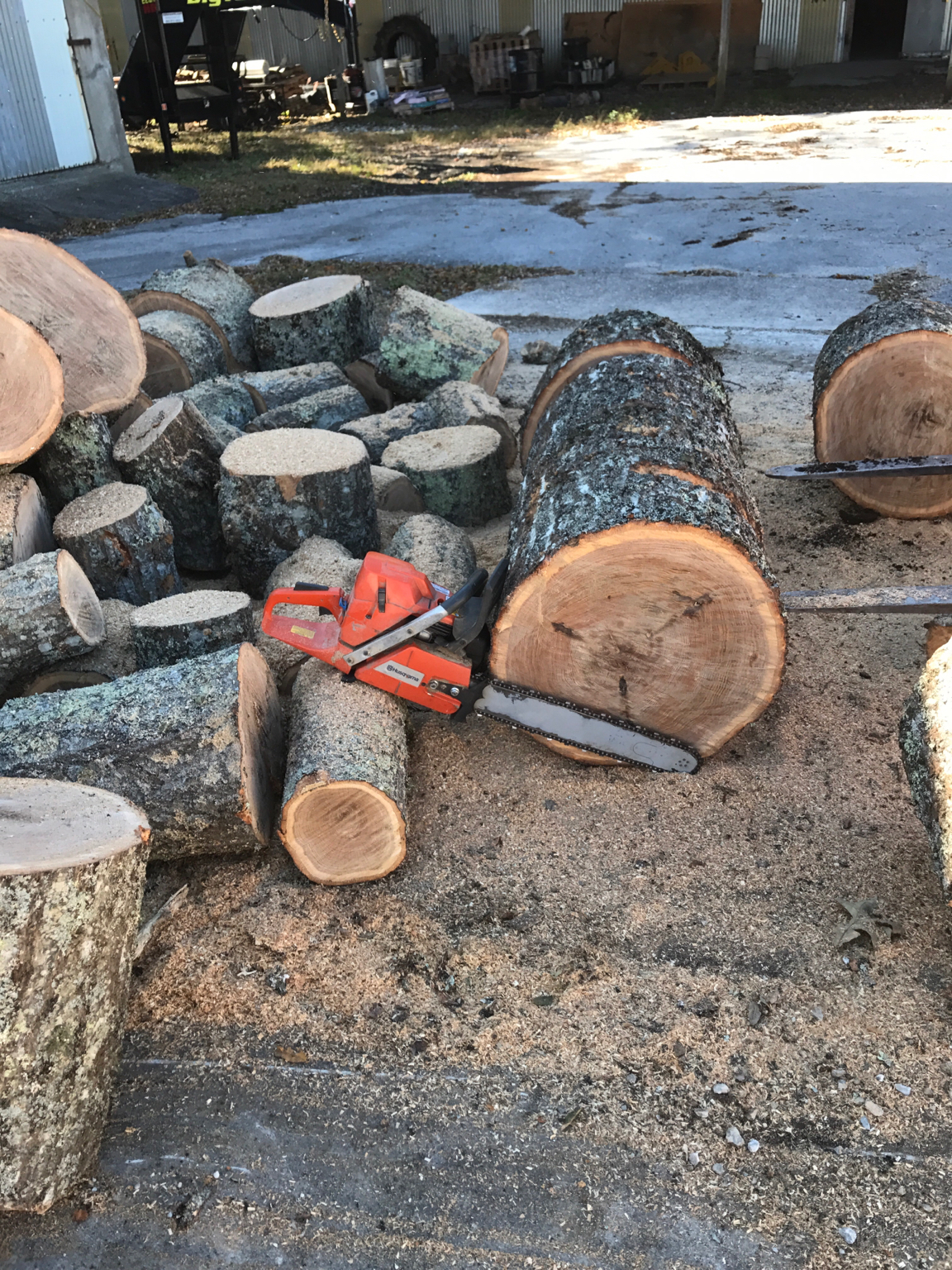

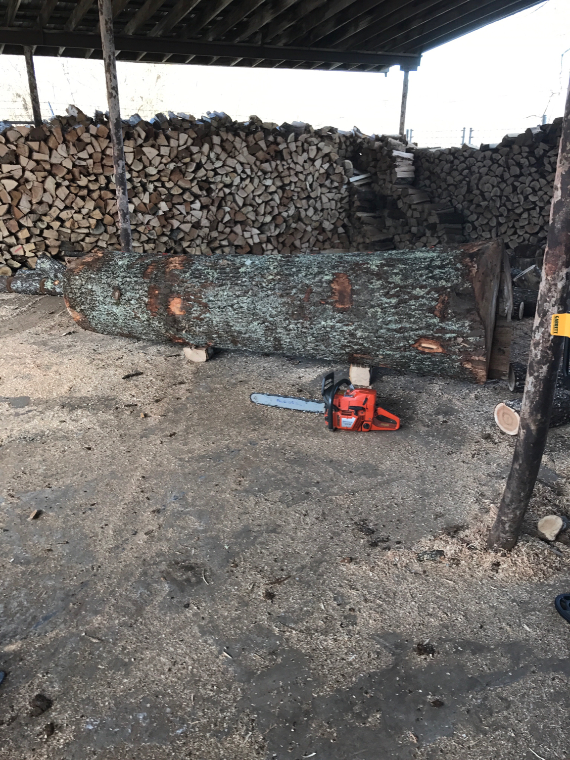

8” is the number I made up. How big of a stick can you lift into the stove? A 20” round at 42” long weighs 380 pounds assuming 50 pounds a cubic foot. That’s more than double my body weight. No way could I lift it in a stove. I guess if you don’t have any it’s not a problem but I’ve got plenty of trees like this. That’s another reason I’m in the anti cheap saw camp. I usually cut the firewood I’m selling 16” long. I usually cut the wood I burn 24”. My splitter will do 30” but my stove won’t. IMG_0601.JPGIMG_0821.JPG
