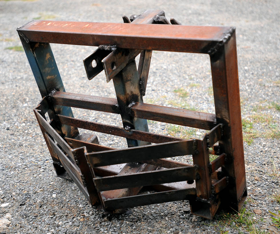

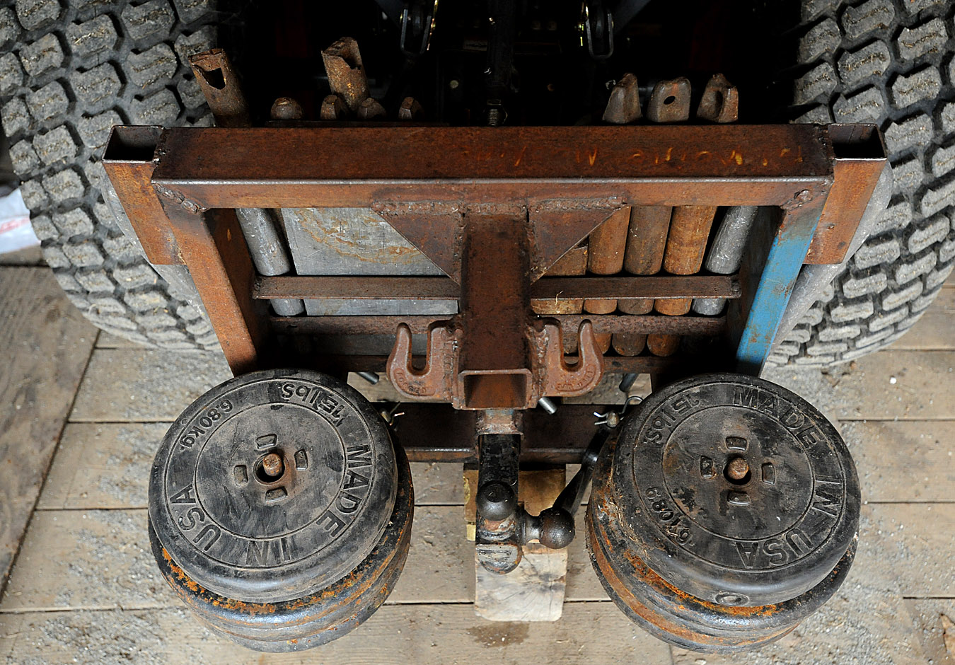

Here is what I built a couple of years ago. It uses old window weights, gym weights and various hunks of cast iron and a lead. The Max weight I can pack in there is about #650 but I'm trying to find more weights at yard sales to add up to about #800 for real heavy loader work that does not happen too much for me. I must mention that the rear tires on my tractor are also loaded and the max loader capacity is about #900.
First picture is the frame itself.
Second one as it looks when I haul firewood using the hooks on the frame and the chains in the picture. In that "mode" I only make the ballast weigh about #300 or so as I don't need much just to keep the rear firmly on the ground on the way to the log to be pulled.
3rd is at it's current max load. As you can see there is another receiver on top awaiting the extra #150 I hope to get some day.
