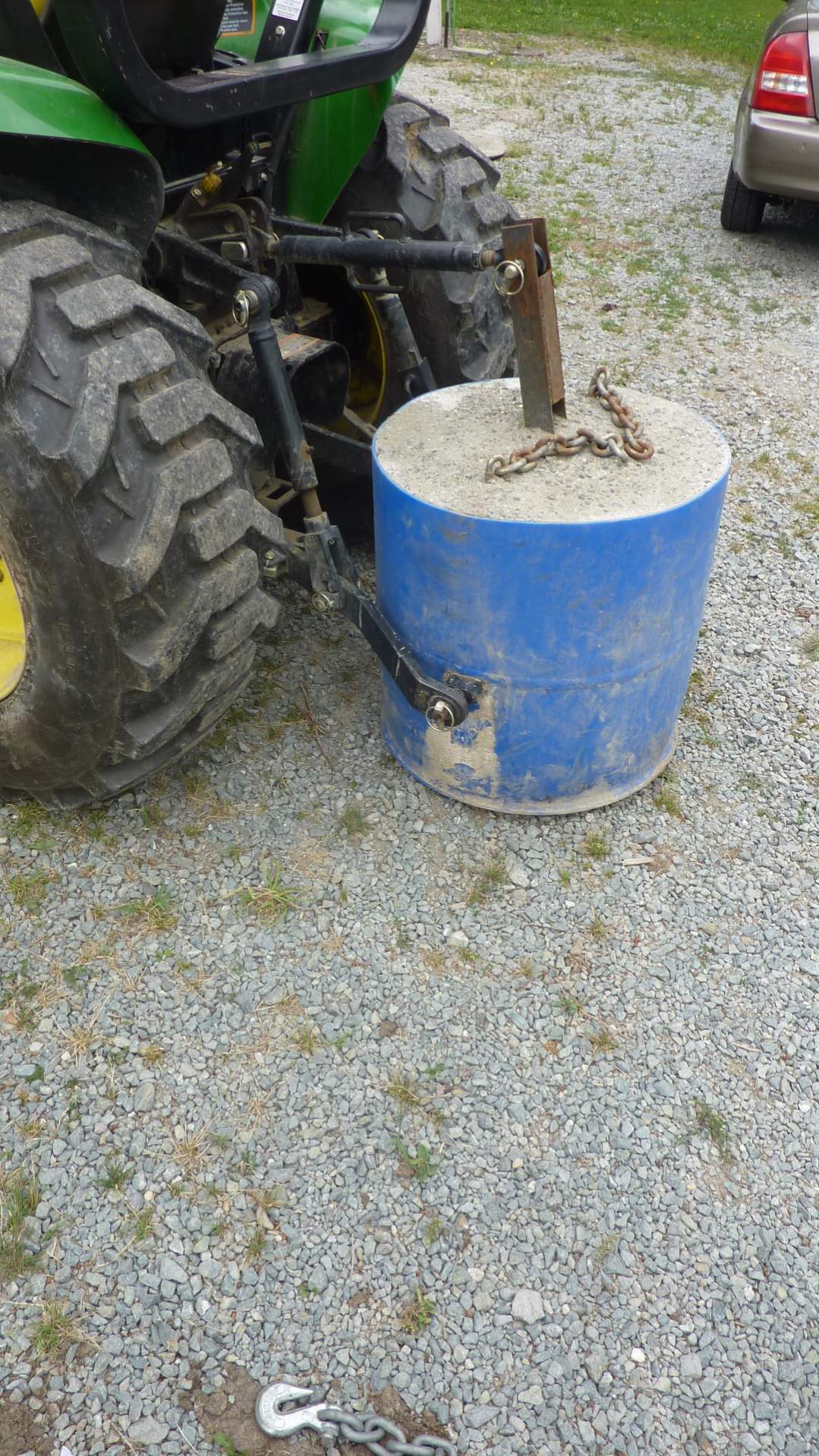

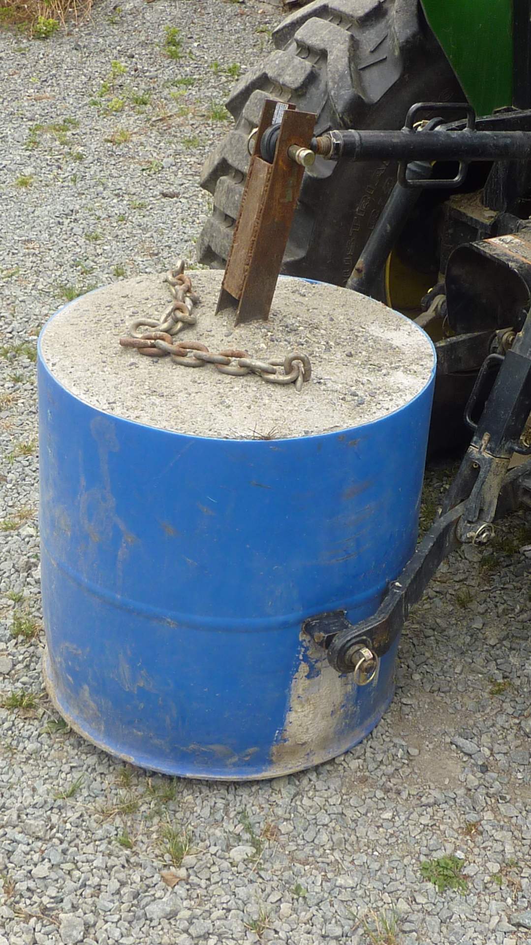

Here's mine. You can see it was/is pretty simple: Old 55 gallon drum cut in half, some scrap metal lying around to weld to a draw bar (the only thing I had to purchase other than the Quikrete).
Before adding the concrete I threw in old barbell weights that were lying around and some section of chain so I could pick it up and move it around with the front loader without too much trouble.
