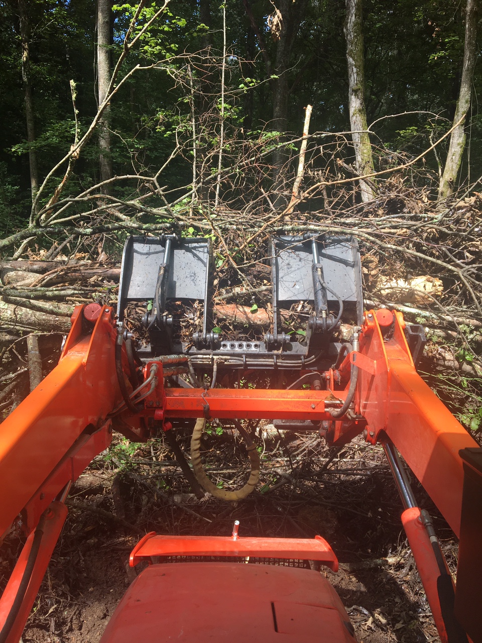

Anyone changed their hydraulic cylinders on their grappler for more grab.

And I’m not suggesting a bigger cylinder produces less force. I’m suggesting exactly the opposite. If it takes your loader 2500 psi to lift a ton with the current cylinders and you changed the cylinders to bigger cylinders how much pressure would it take to lift the same ton load? Certainly not the same 2500 psi. Since the bigger cylinders are stronger they require less pressure to do the same work. I never called you an idiot but it’s starting to look that way.

Just look at Log splitters, most have same pump pressure, only the cylinder size is increased to increase the Tonnage capacity. it is all about the surface area ot the piston in the cylinder. For example, for 2,000 psi of hydraulic pressure, calculate the surface area of the bore diameter, which is 3.14 X R2. If you use a 3-inch bore cylinder, calculate the radius (1.5 x 1.5 x 3.14), which equals 7.065 square inches of surface area. Then multiply this number by the 2,000 hydraulic psi being used = 14,130 psi force on the rod end. So if you do change to larger Cylinders make sure the Material and Design of your grapple can handle more PSI.

Messicks’s grapple feedback pressure from misuse video is good information. I’m guilty of grapple abuse. While the hydraulic systems are protected by relief valves from the hydraulic pump pressure, They aren’t protected with closed valves and external forces on the cylinders...I think, not positive for all. Likewise for backhoes, top and tilt, snowplows or other equipment unless an additional relief or cushion valve is installed. Backhoes are powerful diggers but chain a log to the bucket and take off down the trail the cylinders become pumps and the shock load can damage your system because it is not designed to see forces, “pressure” externally applied. There are grapples and equipment designed that can take the shock load if you want to play with the big dogs.
