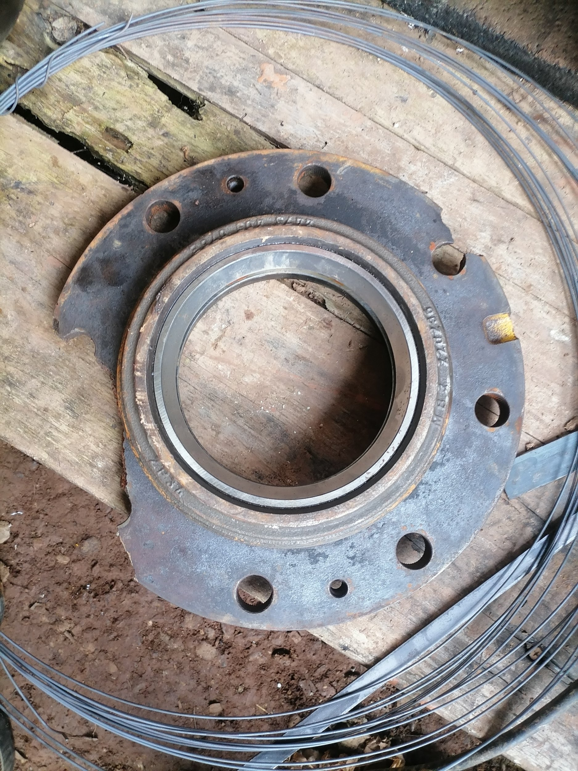

So that's the piece in question, it's part of the front hub. Not certain it's cast or iron, but the way it's broken looks like cast something. There are lots of cast pieces on these machines.

Yeah, that piece does indeed look like it's cast. It should be easy to repair.
Looking at your part I see a good opportunity to make the part come out right. Since there is a large machined surface it is obviously important. It is also perfect for keeping the two pieces in the same plane. If I was doing this repair I would clean all dirt, dust, paint, and oil from the two pieces. Then I would clamp them well to a piece of thick, FLAT steel. Clamping well meaning in this case not just securely clamped to the flat steel but also clamped together, using the broken faces to accurately locate the pieces. Then I would vee out the break about 3/4 of the way through, leaving the last 1/4 to maintain location. when brazing I would make the bead proud of the surface the same amount as the thickness of the 1/4 left as well as double the width of the vee. This is of course only if you have the room. If the brazed assembly is then left to cool so slowly that it takes several hours it will be unlikely for the part to have warped, cracked, or pulled. I think you will do a job you can be proud of and will be confident that the part can be returned to service.
Eric
   / Anyone ever gas weld without flame arrestors? #30
Best bet for a part like that is to remachine it after welding it brazing. But if you're careful enough it may be good enough without
