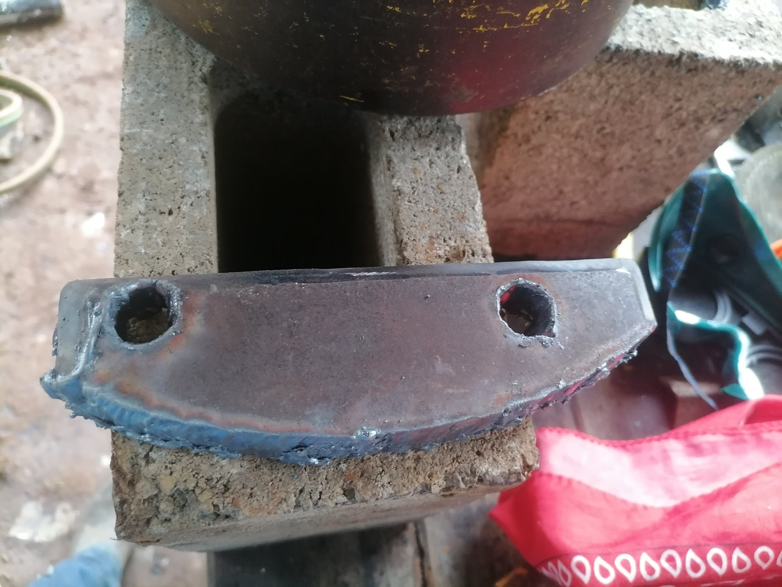

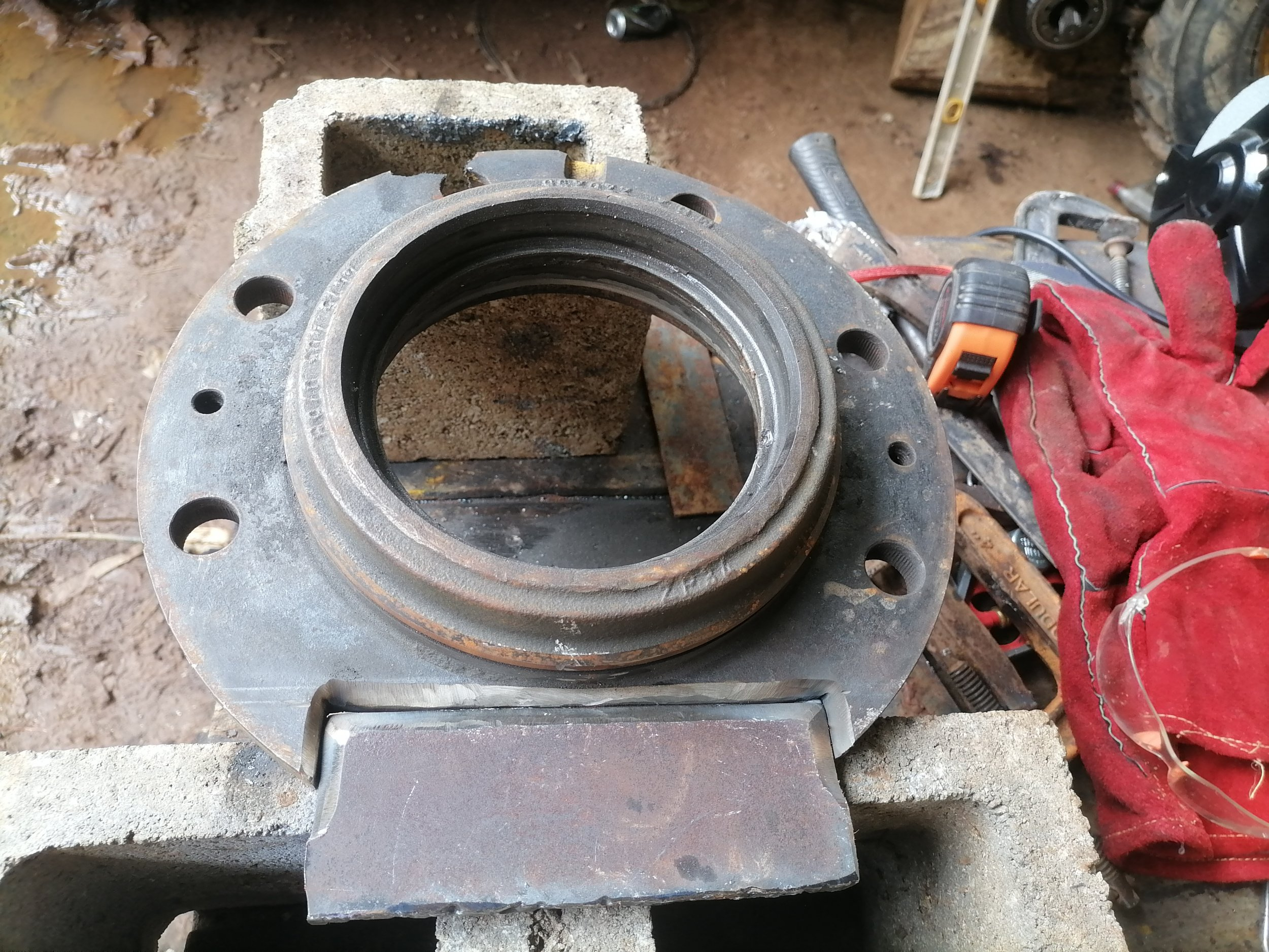

Prepping the patch, sorta tried drilling with a big bit but that was a total no-go. Poked holes with the torch and cleaned them out a bit with the bit. Even that was abusive work.
Looks good so far. I'm sure you know but for other folks looking at this to learn they should know that the torch cut surface must be ground down to clean bare metal. All the metal to be brazed needs to start off as clean bare metal. No oxides, no oil, no dirt.

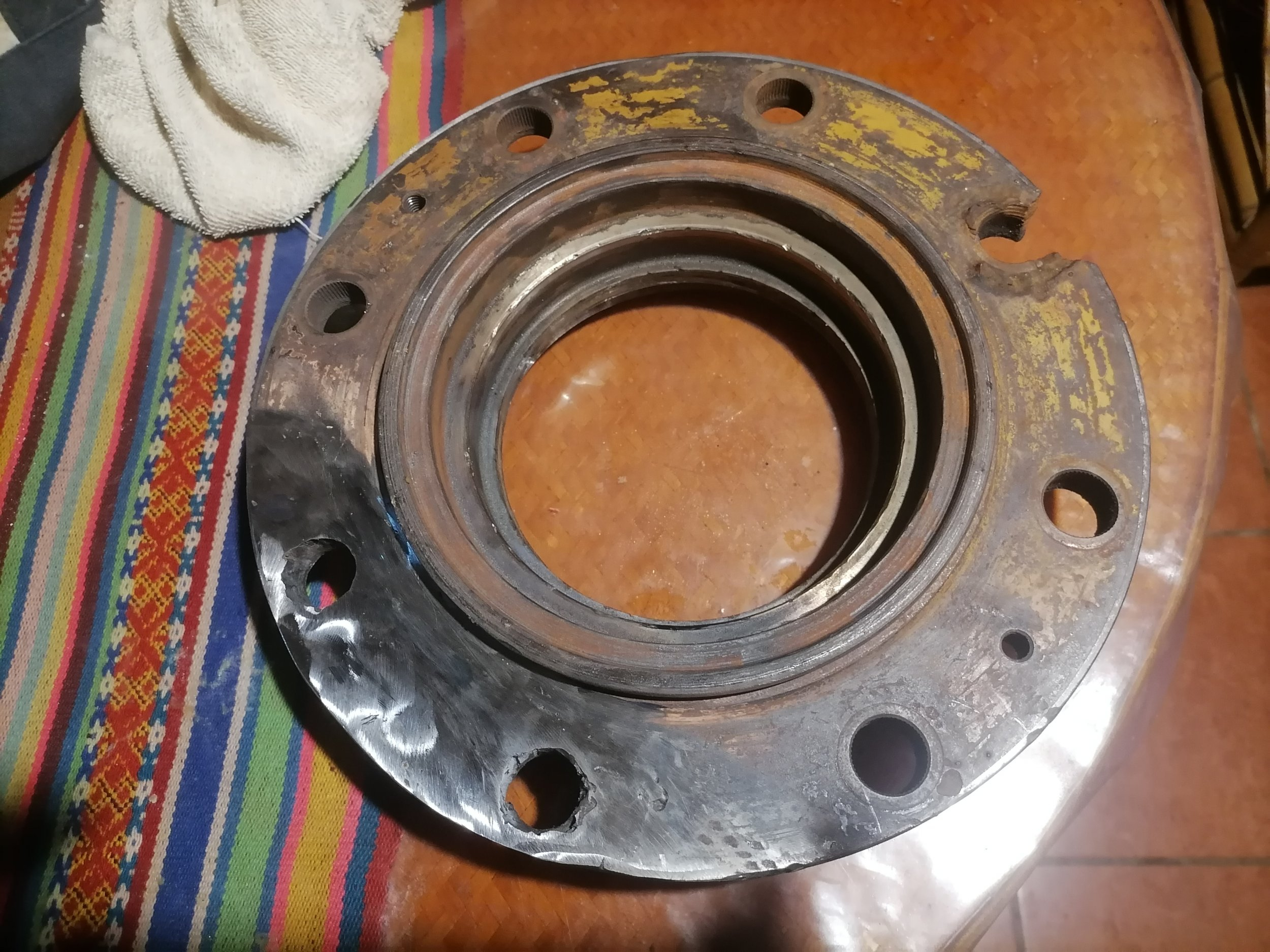

Sooo here is the "finished" product. Bolted the hub and patch to the outer housing and heated it up in the kitchen oven for close to an hour. Put down one bead of 1/8 nickel rod with a stick welder on the backside. Sorta like a heavy duty version of tacking it in place. That nickel rod is very poorly behaved, cursing and spitting all over the place. Maybe it's actually the cast iron that's the poorly behaved part but it's always impossible for me to put down a pretty looking bead. Minimal slag inclusions at least. Wasn't worried about one bead overheating the thing. A half dozen or more beads on top of each other, yes.
Once the first nickel bead on the backside was done I unbolted the hub from the outer cover and threw it back in the oven for a bit while I got the torch and workbench ready. Then I filled in the big bevel on the front side with bronze.
I wouldn't say it went badly, but definitely not as nicely as I would have hoped. Used a cutting torch to do it cuz I found it heats a larger area than the pointy welding tips, based on my minimal miniscule inconsequential amount of experience with the acetylene torch.
Anyways the small cutting torch didn't heat the thick metal as effectively as I wanted and the bronze wasn't flowing as freely as would've been optimal. But I muddled through it and hopefully it stuck to the cast iron sides. Afterwards I threw it back in the hot oven and ten minutes later turned off the oven and let it cool down in there overnight.
I'm using the logic that if the hot bronze wasn't beading up into annoying little balls and rolling away from the work area, then it was flattening out and sticking to something. I hope it stuck. When I ground it down it looked pretty well fused, for what it's worth.
Took it to my machinist buddy around the corner and they machined the inner face for me. That way there won't be any stressors on the repair when it's bolted up tightly against the outer hub housing.
Tomorrow is reassembly day for the hub!
Eric
Actually i didn't know that, if I had done that maybe cutting the patch out would have been less "spectacular". Was a bit of a fireworks display.
Thanks again Eric, and everyone else, for all your advice through this process. It really helped me get what I think is a solid repair for what was an ugly break. I really appreciate it!
