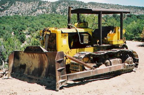

Okay I was thinking about this overnight. Not trying to be a complete idiot here but what was the primary purpose for a cable in the first place? Was this used for logging or winching or some kind of safetey?
I agree I could think of a lot of uses for a cable.
   / Anyone got a compact dozer????? #36
Oh, the cable just refers to the fact that the blade was raised by a winch, usually rear mounted, with a cable run to the front, either under or over the cab and engine, and a set of pullies ... no hydraulics. The attached pic isn't too good but you can just make out a round thingy behind the cab which is the winch.

Way back in the old days, they used cables to control the blade. No hydraulics. Most people avoid these older dozers because of there age, difuculty in finding parts and extreme wear.
