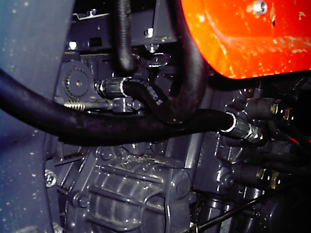

i don't have the remote on mine but i did put a hydrolic loop on it. i believe red4now has the factory remote on his. if you do it yourself you will need a british pipe thread adapter for the input to the 3pt hitch. i don't remeber what size it is though. The other end on the valve bank used a jic fitting.
Rob

I am seeing alot of pictures of the rear hydraulics for a Kubota B3200 but none of the pictures are showing the lines hooked up to the pump. I just got a Kubota Kit(I know I could have pieced it together cheaper). the kit has 3 lines going to the valve. the instructions that come with the kit are terrible and the pictures in the instructions are worse than the verbage. does anyone have a good picture showing where the 3 lines in the kit go on the pump and return? I am seeing 2 lines in some of the pictures but I cannot tell where the third line goes. Hope someone can give me some help.
   / Anyone have a factory rear remote valve on a B3200? #9
Apparently your tractor does not have a hyd blk, and the OUT hose is the pressure line for the next valve.
They must consider the loader OUT port high pressure. So if there have been no failures, then is should be OK.
http://www.tractorbynet.com/forums/...-anyone-have-factory-rear-remote-dcfc0140.jpg
Using these pictures, the flow comes form the pump and goes to the loader valve and from the loader valve to the 3pt.
You need to remove the hose going to the 3pt and install it into the IN port of your remote valve.
The PB adapter flow will go to the 3pt IN port, and the OUT/tank line from remote will go to tank.
