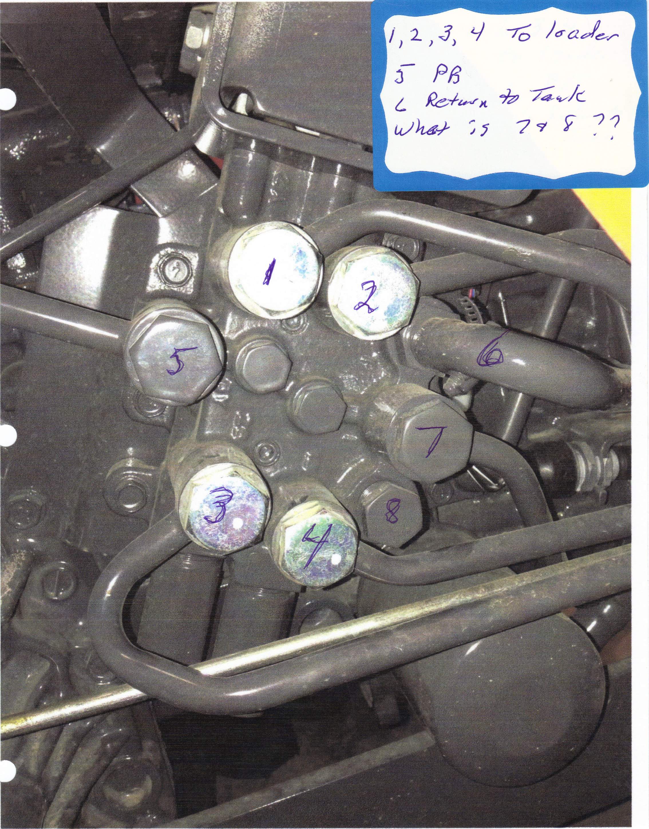

Well there might be a spot that he can tap into on the rockshaft to run the remotes.

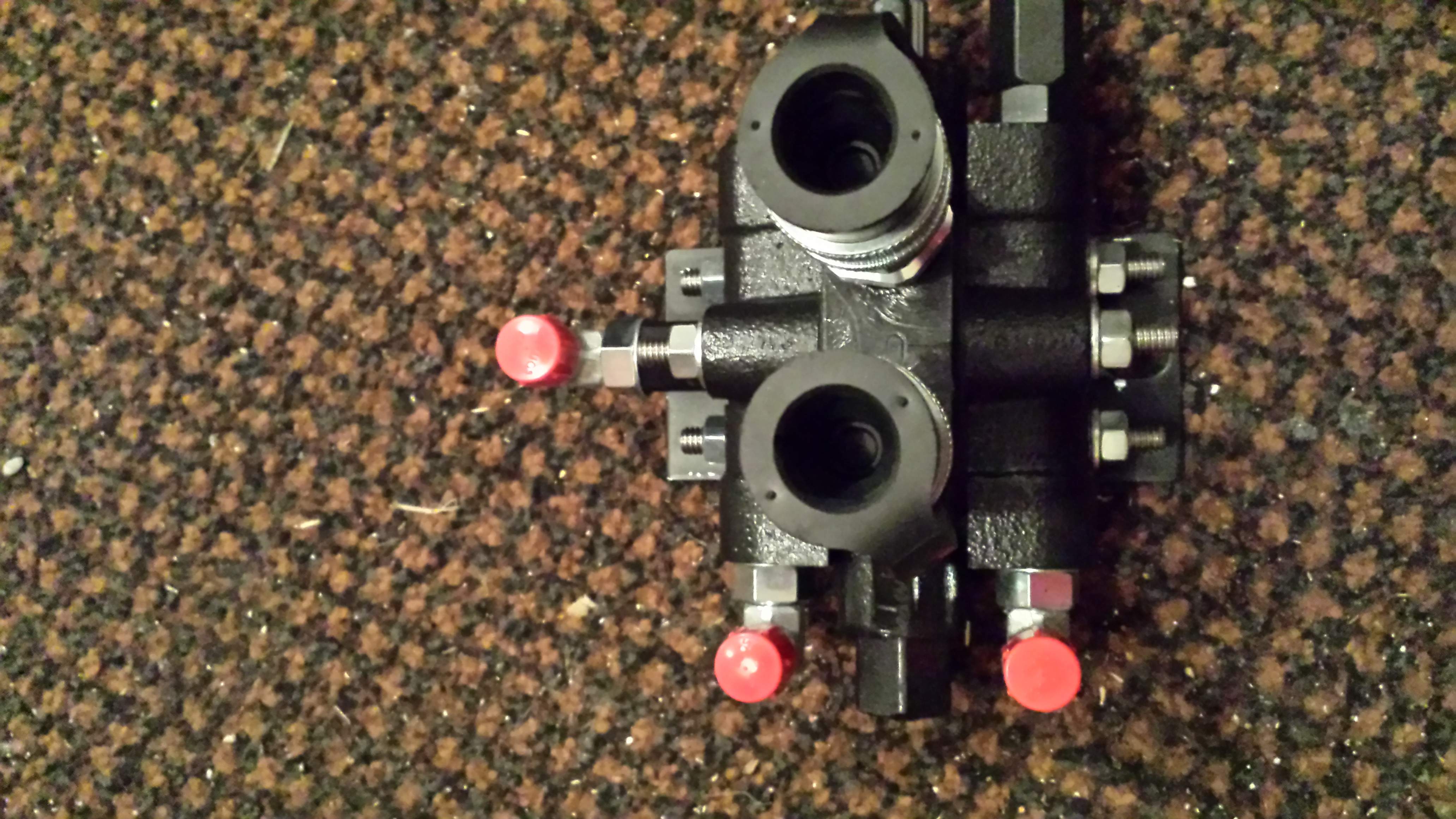

I am understanding the removing the hose from the 3pt and installing it into the remote valve and the PB adapter going to the 3pt In port and the out/tank line from the remote will go to the tank. The thing I am still trying to figure out is which outlet on my valve goes to the 3 pt and which goes back to the tank. The valve is marked with an IN and OUT and then there is another fitting and it is not marked. I am not sure where the OUT goes and where the fitting that is not marked goes.the 2 fittings side by side are marked IN and OUT but the one fitting on the left in the picture is not marked so I am not sure where it goes. Believe or not I rebuild old cars as a hobby and rebuild everything from the frame up including rebuilding the complete engine but this thing has me baffled. 20131016_065737.jpg
This may help you

I got my rear hydraulics all hooked up today. Once I tore into it, I realized where my confusion was. In the instruction number 6 from Kubota, it says to reuse the rubber return hose. Instruction 6A shows using a 16 inch line for the return but it was not clear that this was in place of the rubber hose. It looked like it replaced the return line going to the rear hydraulics control valve. The only other challenge was mounting the rear hydraulic cab. Kubota's kit was not made for a tractor with a cab. I have a Curtis cab on my b3200 so I had to fabricate my own mounting system but it turned out really well. Anyway it is done and working great. This winter I do not have to get off my tractor to angle my front snow blade.
