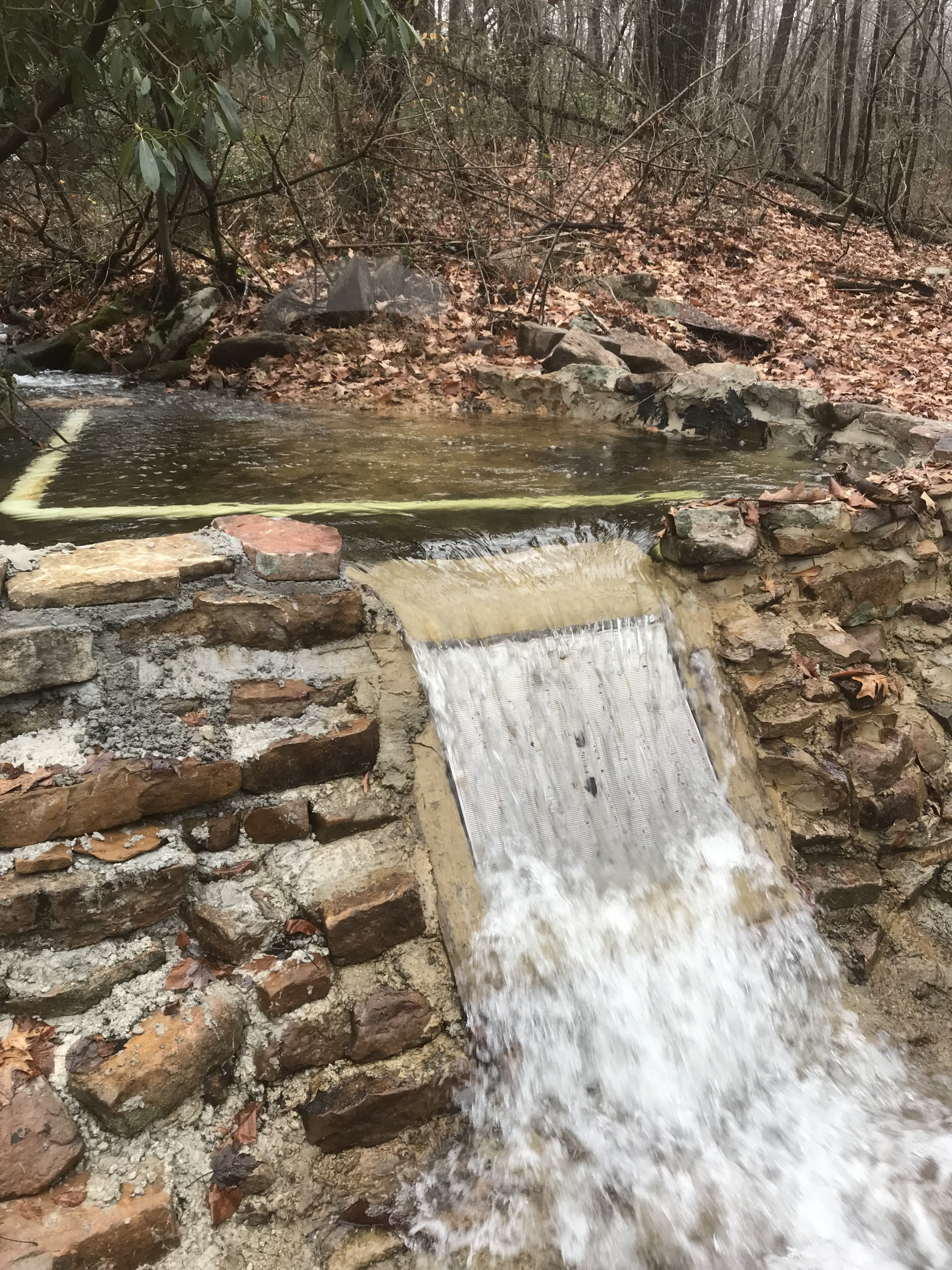

Here is a pic of my weir and Coanda box. This is my typical flow from now till June. I don’t have the valve open yet in this video however but everything looks great up at this end
Boy that's nice! (y)
