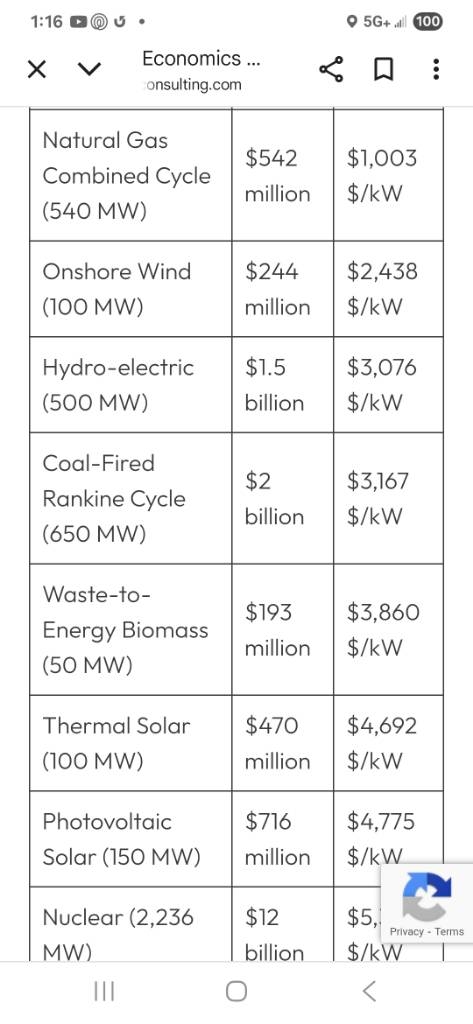

I'm not sure where these numbers came from, but they don't seem to align with other sources, e.g. NREL;
$1,500/kW for utility scale PV capex
($3,000/kW for residential PV capex)
Other technologies here;
All the best,
Peter
A quick Google search, and thats the first thing I found. I dont vouch for the source, or the results; but its not like Solar farms are Vastly out of the range, when you consider the low operating costs. Ugly, maybe; the best thing available, maybe not; but they arent simply a dumb idea. Maybe not the best idea, but not the worst either.
