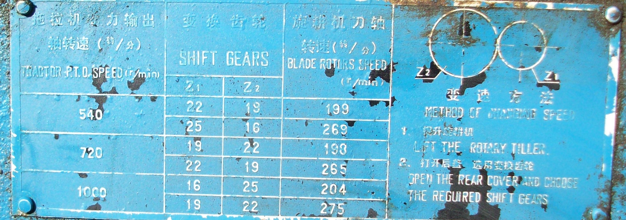

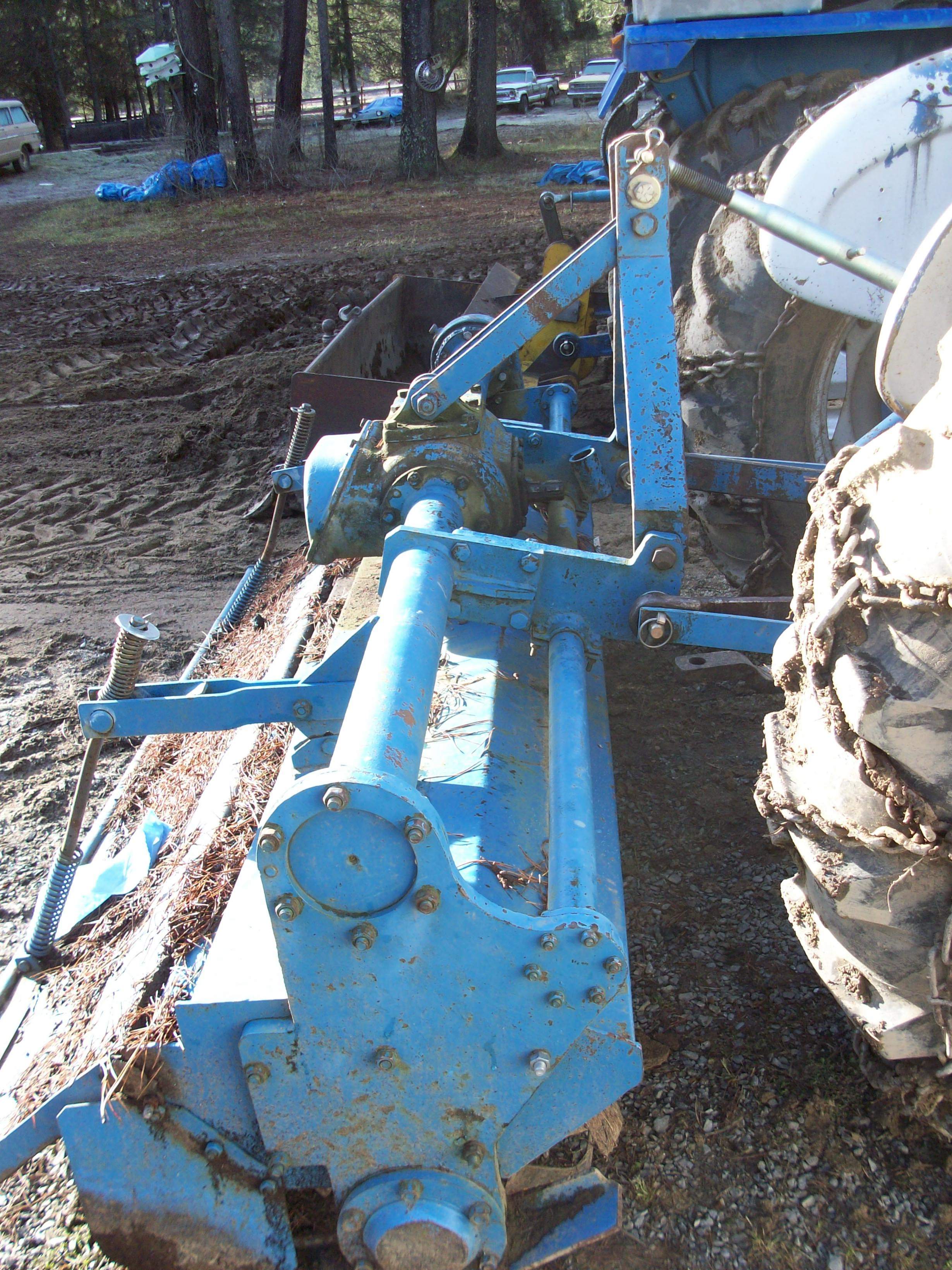

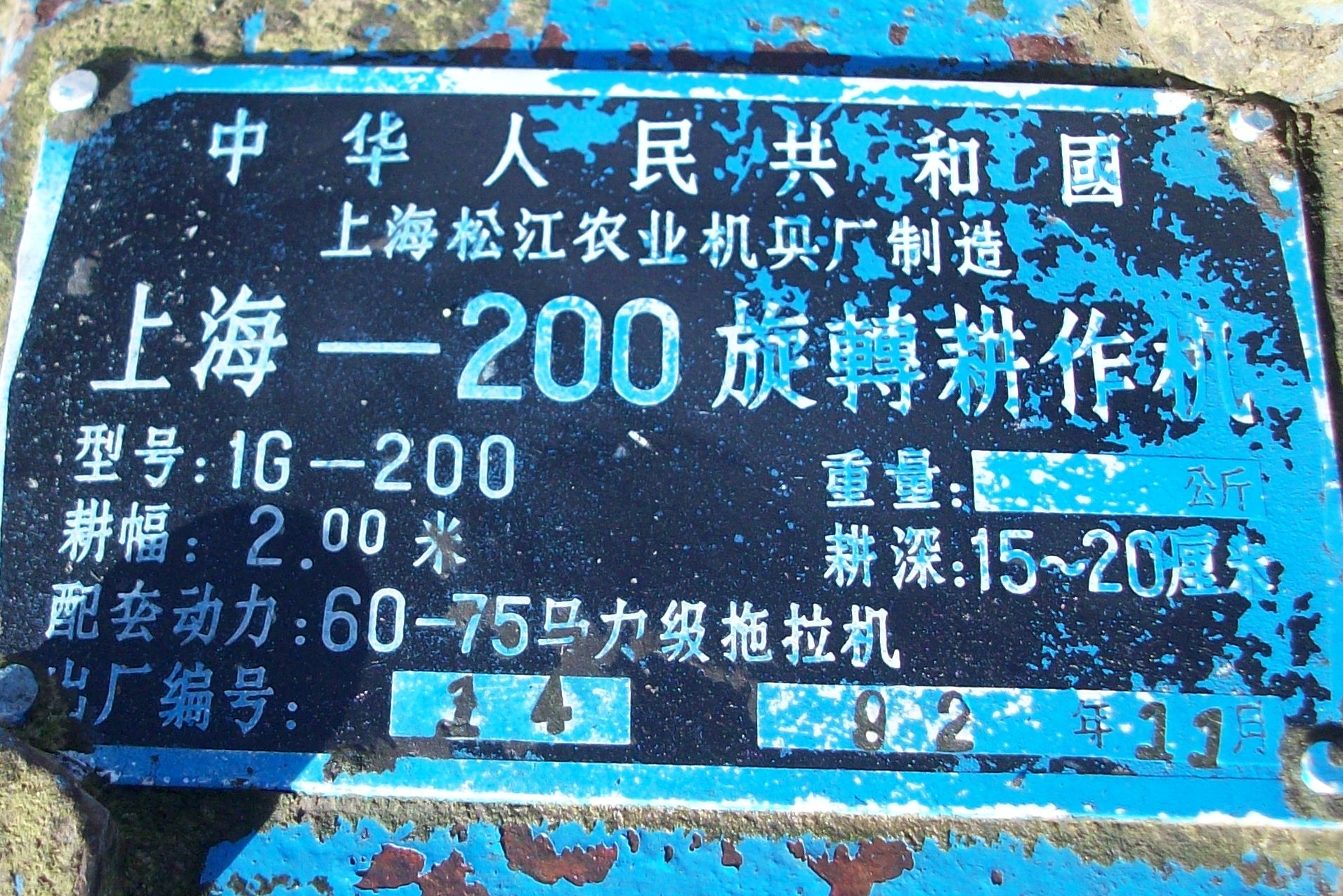

Here's the chinese tiller, rhino-tiller 005.jpg can't seem to identify it was bought with the Rhino tractor at same time in 1993, the nut backed off of the mainshaft to the gear drive on the left side of tiller when that happened it broke a tooth on the two spider gears that turn the power 90 degrees. doubt parts are available. Here's the only data plate on itrhino-tiller 002.JPG looked thru rhino servis-site can't find it there??

Dan, if I am not mistaken that tiller looks to be a Ieski model!

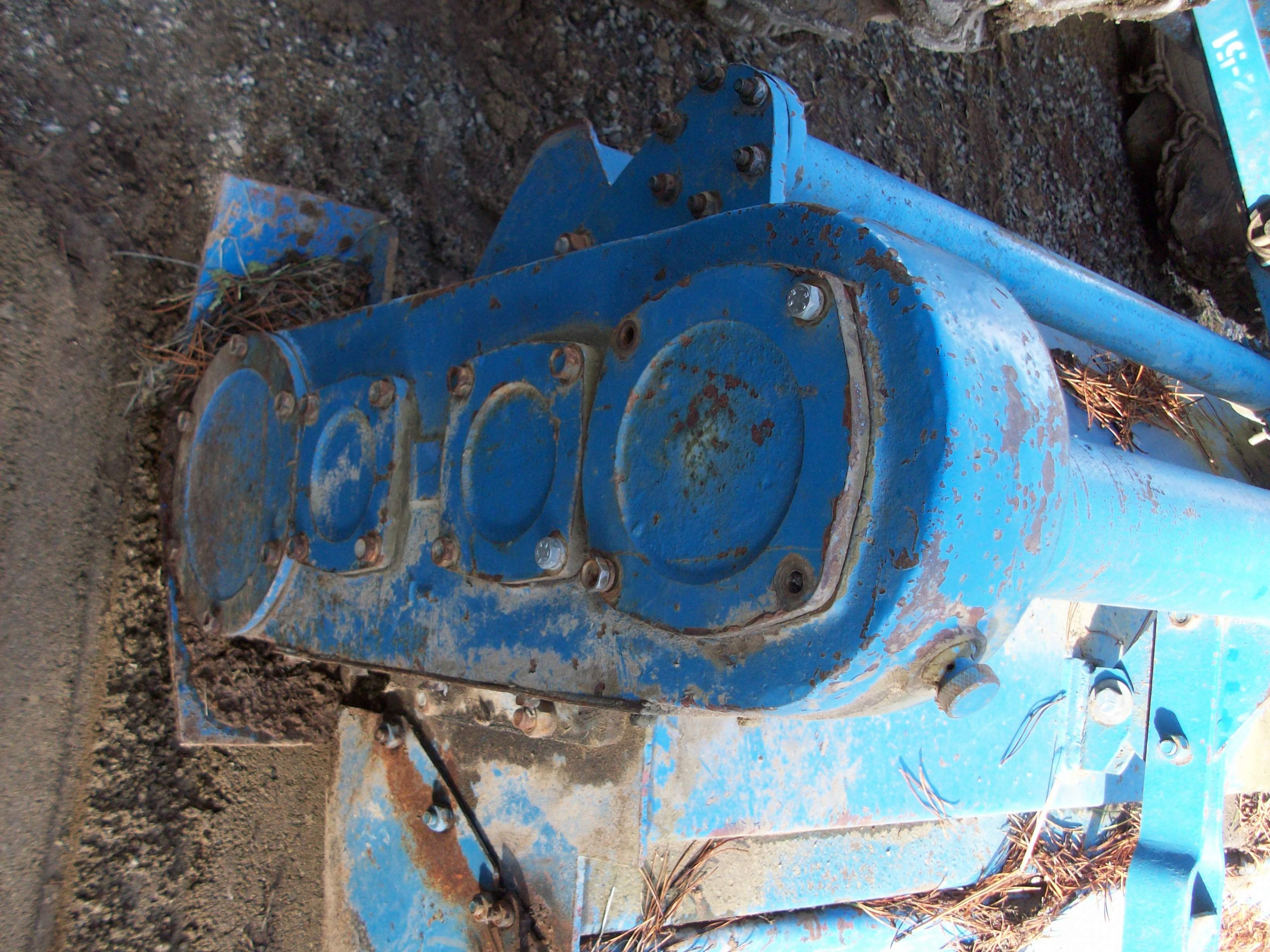

Wow ! really, I had assumed that since it was bought with a Rhino International Tractor and the implements the dealer was selling that were in the fliers that came with the tractor referred to Rhino Servis tillers and such I just assumed the writing was Chinese not Japanese, The plot thickens!! This tiller's a full 85" wide does Iseki build them that large?? here's a shot of the gearhino-tiller 003.jpgrhino-tiller 001.JPGr covers it also is a 2 speed unit the gears under the center cover can be exchanged for a second tilling speed, would really like to fix this tiller...

Dan, google Danny Parker Equipment Co. Thorsby Al. He might can help you out on the tiller. He has over 500 tractors in his salvage yard and I understand most of the grey markets came with tillers when shipped. By yours having chinese writing, it's a grey market tiller.

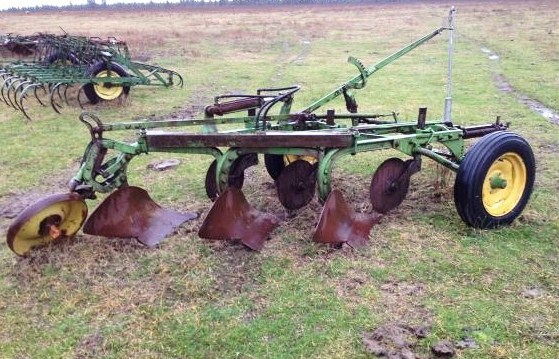

I think that's my problem, kind of hate to cut up , the only JD piece of equipment I own View attachment 309204
I have decided to take RW and 6011 Artists advise, and not rebuild the plow into a 3 point. Going to just go ahead (at least for this year) and use the plow as is, run out of time.. Thanks everybody for the advise i do appreciate it. :thumbsup:

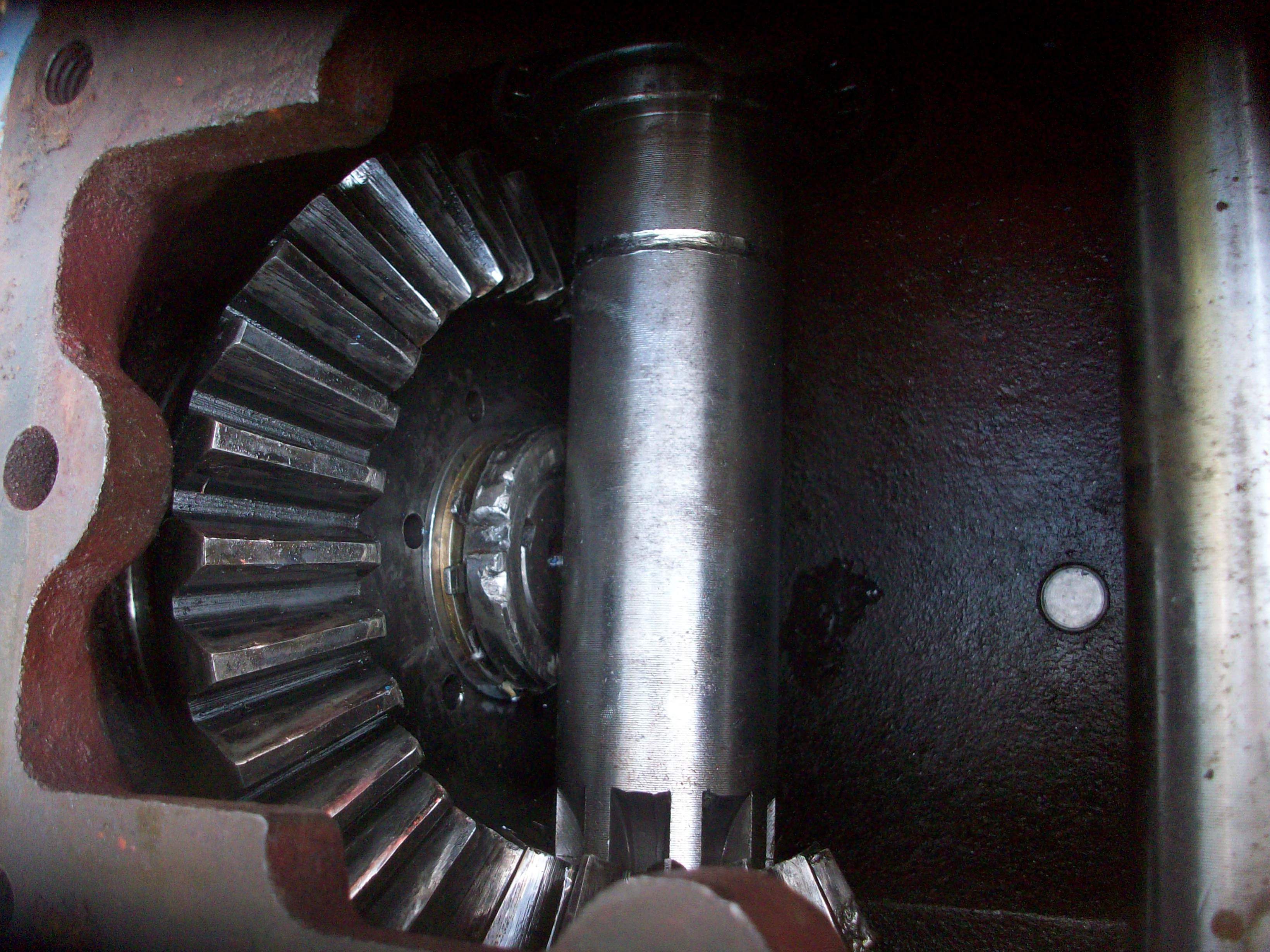

Update - went a head and plowed the field with the JD pull behind 3 bottom but there are areas that are just to hard to back the plow into so i went ahead and bandaid repaired the tiller .
Once I got it apart, it was the same problem that caused the gear damage the first time, the nut that secures the ring gear to the horizontal shaft that drives the auger gears came off...sooo this time I found another retainer and used the red- high strength anerobic threadlocker and placed a small weld on the second retainer to the nut! the pinion has some chipped teeth but There is enough engagement to drive the ring.
put it all back together and it seems to work ok here's the internals rototiller repair 003.jpgoh i did get the silicone gasket chunk out of the case before it got sealed up and also how this isn't the top notch repair , but this tiller has been bent,broken and welded six ways to Sunday and left for dead at least 5 times over the last 20 years.
Plus it was free to me, Originally as just a 3 point weight- so I could plow snow with the Ford 3000
