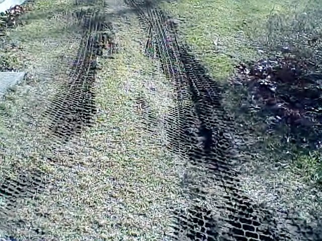

Here's what loaded turf tires on a B3030 can do to your lawn during the spring thaw. I did this while hauling firewood to my front porch.
My zero turn will do that much damage or more during spring thaw. I leave footprints walking on the lawn when the frost comes out.
Once the ground stiffens up from thaw, I mow the lawn with a JD 850 and a Kioti DK 35 with loaded R-4's (both similar in size and weight to an L-series) and it doesn't do any lawn damage.
