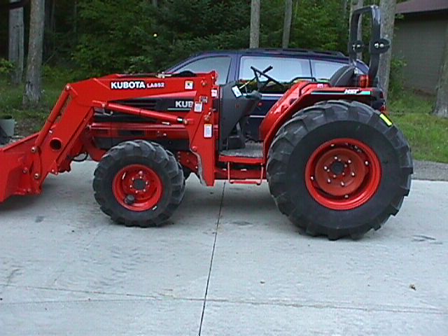

Had to rework the loader frame for more room. They are just bigger. See photos.
Rich

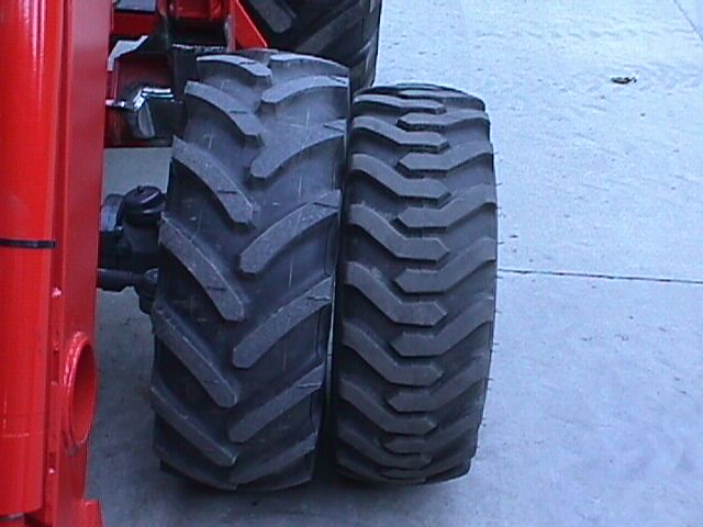

One other photo

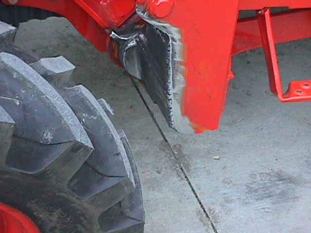

Same rims? What loader frame rework was required?

Nope, you have to get new rims. heres a photo of the work that was done.

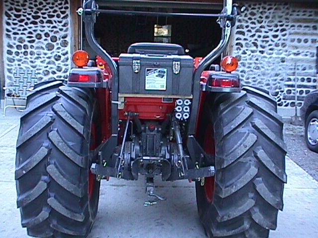

here's one other shot.

looks kike it didn't go? ILL try agin.
