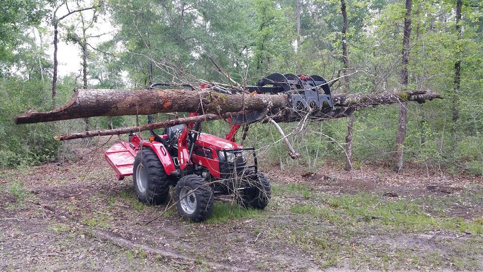

I love the 2538. HST was a must for me as I do only a little true straight line ground engaging. Mostly loader and cutter work in the woods where i need to moderate speed frequently. A cab would be great, especially in the summer down here, but I would have it torn off in about a week in the tight woods.
As for implements, I find that I use my low back and a stray 2x4 that might be laying around, probably should get a big crow bar as that would make things a lot easier. Quick hitch is something I am interested in as well, but I use a 3 pt mounted drawbar to move my transport trailer around, so there would still be lots of on/off. In all honesty, I have found hooking up the 6' MD cutter and 6' HD box blade easier on this machine as compared to my prior Max 25 with 4' implements. That was a much smaller setup, but more pain in the rear. I am certain it is because of the clevis pins and brackets I went with on the heavier duty implements. I can back into where I last dropped it off, (as level as possible), and then lift the arms till it basically lines up. Then slide pins in through implement clevis brackets. Some wiggling involved, but much easier than trying to wrestle the lower 3pt arms around the permanent single pins on lighter duty equipment. Just my 2 cents.
Now on what I needed - I did add two things. The suspension seat from the 2540, as I do a lot of rough terrain work, and also a cruise control option. The seat was +/- $300 after sharing cost with dealer on the initial purchase. The cruise control was around $150 installed and is an electrically actuated magnet that grabs and secures the HST pedal at the speed you desire. Makes long mowing passes and transport down the county road a breeze. It is a utilitarian/basic machine with not too many frills like cupholders, but it's heavy, powerful, and sturdy for a mid size CUT. (And it's very reasonably priced too!) Some others may have more refined Hydros and loader controls, but this beast has suited me just fine. Also if you drive it around again, note how tight a turning radius it has. I think it can corner as well as the smaller Max did.
Not sure if it matters to you, but this machine with implements can still be hauled around with a half ton as well - barely...

Snowback: You mention haulling around a half ton, I assume you mean logs like your picture or a trailer. I cant imagine you have many hills in your area. I wonder how the 2538 would deal with the load on a hill. Might be a bit much.

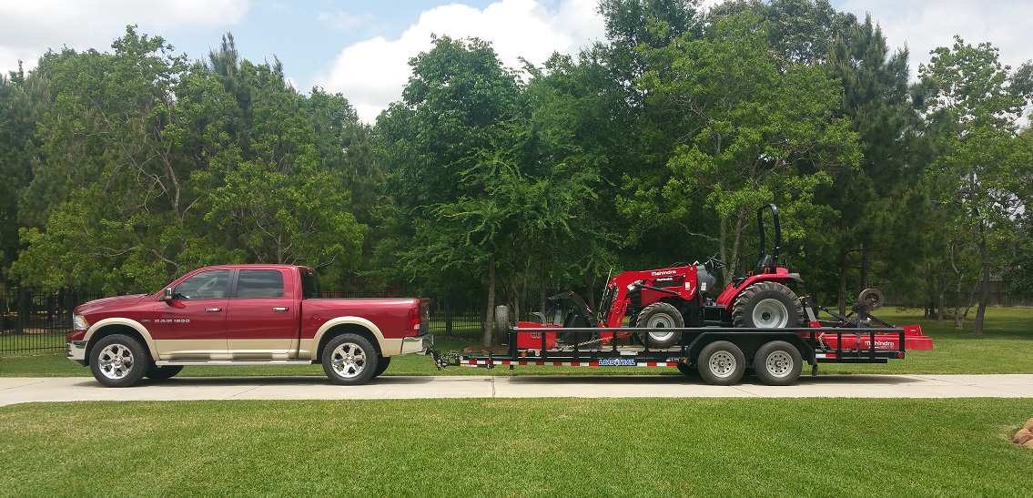

For clarity - when I said "this machine with implements can still be hauled around with a half ton as well - barely..." I meant that I can move a fully loaded 20' trailer with tractor and implements safely using my Ram 1500 half ton truck. Sorry for being unclear, but that is funny... :cool:
As for the tractor, I am certain it can haul around many tons on a trailer. It pulls my 2,400# equipment trailer like it's not even there in mid range. Our property has no really steep hills, but I do mow brush and tall weeds up and down a little bit of a grade from front to rear of the property in mid range, and there is no discernible difference from when mowing going down the slope. It would really be great if the dealer would let you try it out for an hour or two to make your final decision. Always is best to be certain that the machine will meet your needs. If you think about it, this mid size CUT with 38HP has a very high power to weight ratio relative to the very large CUTs. It's still a medium large CUT with lots of built in weight, but its a bit more nimble and lighter of foot than say a 3540 HST or something of that sort. (Plus it has very similar power...)
Below is final clarification of my "half ton comment".
