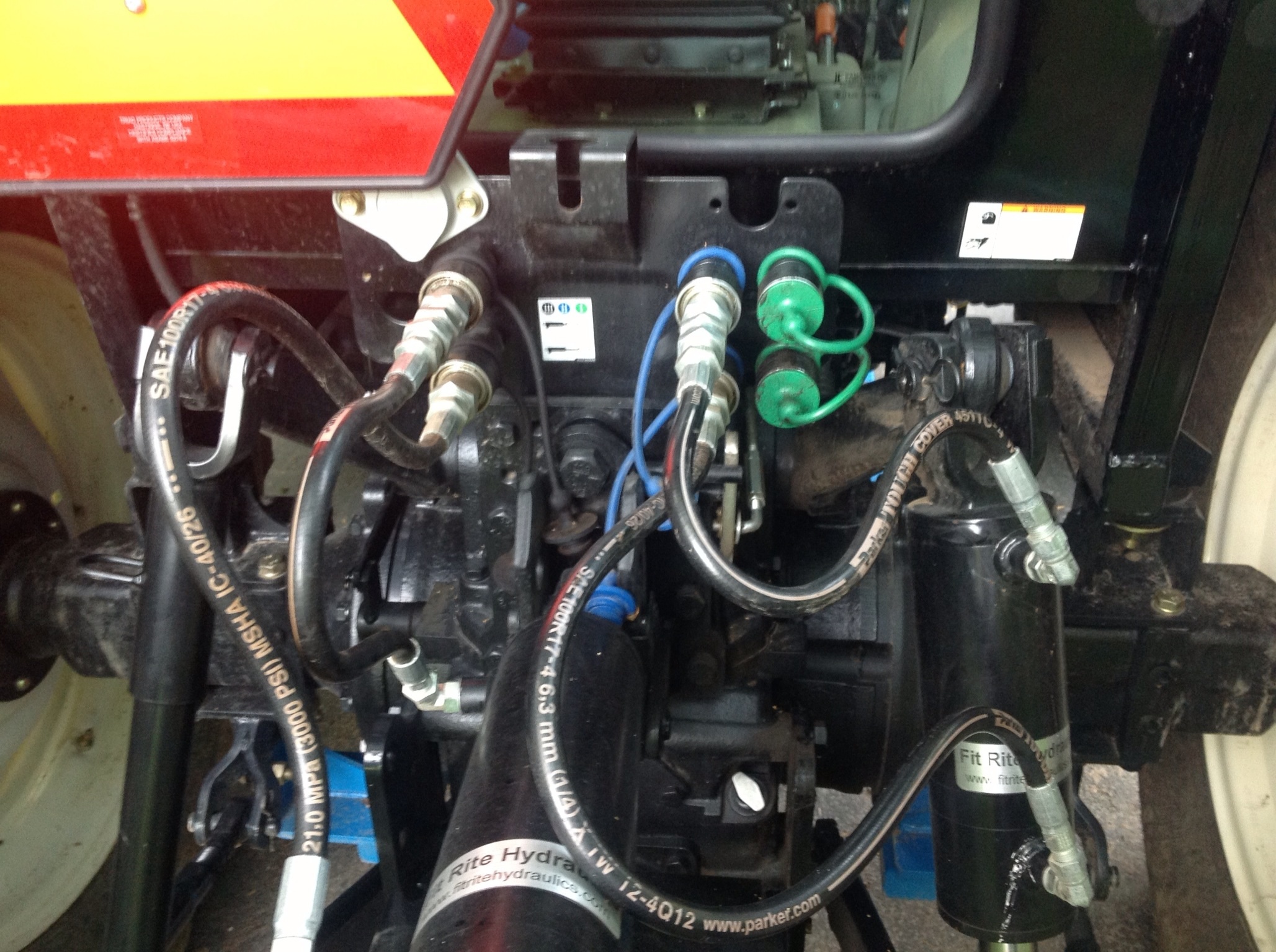

I am a little confused about the number of rear remotes needed, I currently have three. Two are taken up with Top and tilt. From what everyone seems to be writing I would disconnect the Top and tilt and use those functions on the blade? I guess I was wrongly thinking that I would still use the Top and Tilt for those adjustments.
Brian mentioned I would need a fourth remote, maybe to retain the hydraulic top link? Does one do much adjusting of the top link while using this type of blade?
I will go out and take some pictures and post them of the tractor and maybe I can get some ideas about what to do for this fourth remote.

Here's the photos and I don't really see how to add a fourth remote.
   / Anyone own the new Land Pride LR37 rake yet? #15
What I'm thinking about your hydraulics is you keeps the tilt cylinder on your tractor plugged in and get Manual tilt on blade as the tractor will do the tilt. And unless you want to keep your top link connected you will need a fourth remote for your sideshift. If not you could just unplug your toplink and use that for your sideshift.

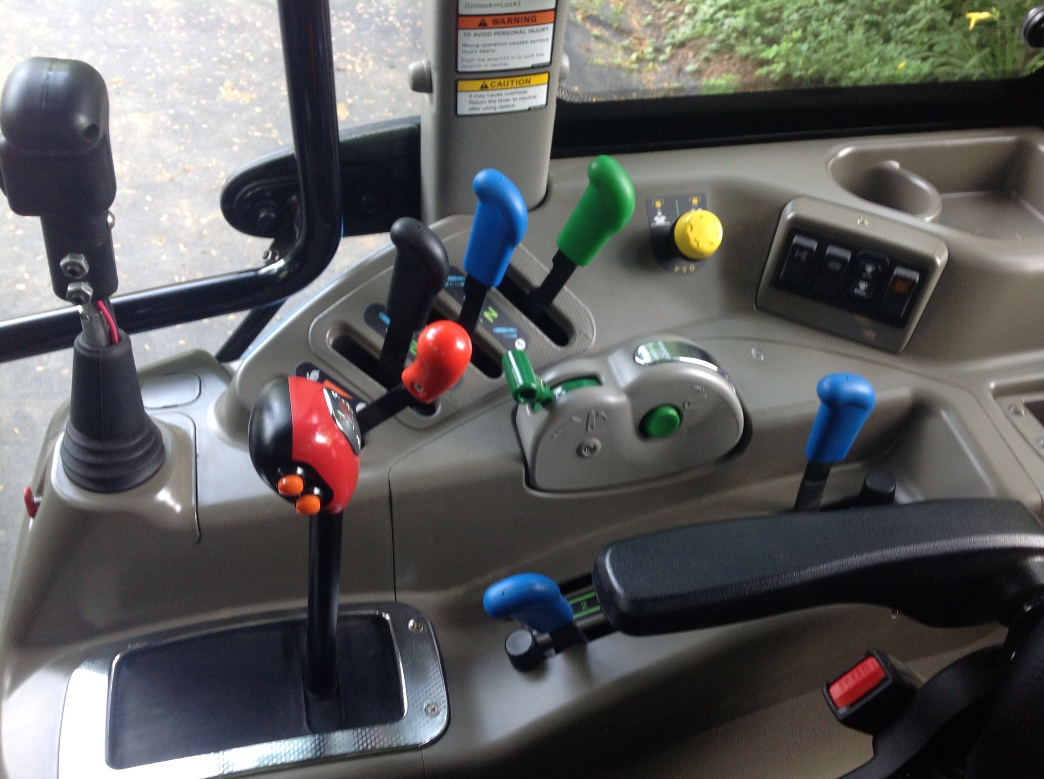

Here's the photos and I don't really see how to add a fourth remote. QUOTE]
Electric diverter, simple, easy, about $500. Do it all the time. ;)
For those of you who have the word "Hydraulics" in your business name it may be simple and easy, but I think I'm going to need pictures...:confused2:
My limited understanding is a diverter valve lets you choose between two separate functions while a third function lets you do two simultaneously.
When I purchased the tractor I had a W R Long third function installed for a snow plow and grapple. (You can see the ungainly ugly bulbous handle in the second picture.)
Would I need to add some kind of "button" to an existing lever to switch between functions like the WR Long? Or could I buy a Scorpion hand grip with an extra button or two to handle the switching of the diverter and third function and get rid of that ugly handle? (Which I will be replacing anyway)
Also for the rear of the tractor are there add on brackets for the additional remotes?
