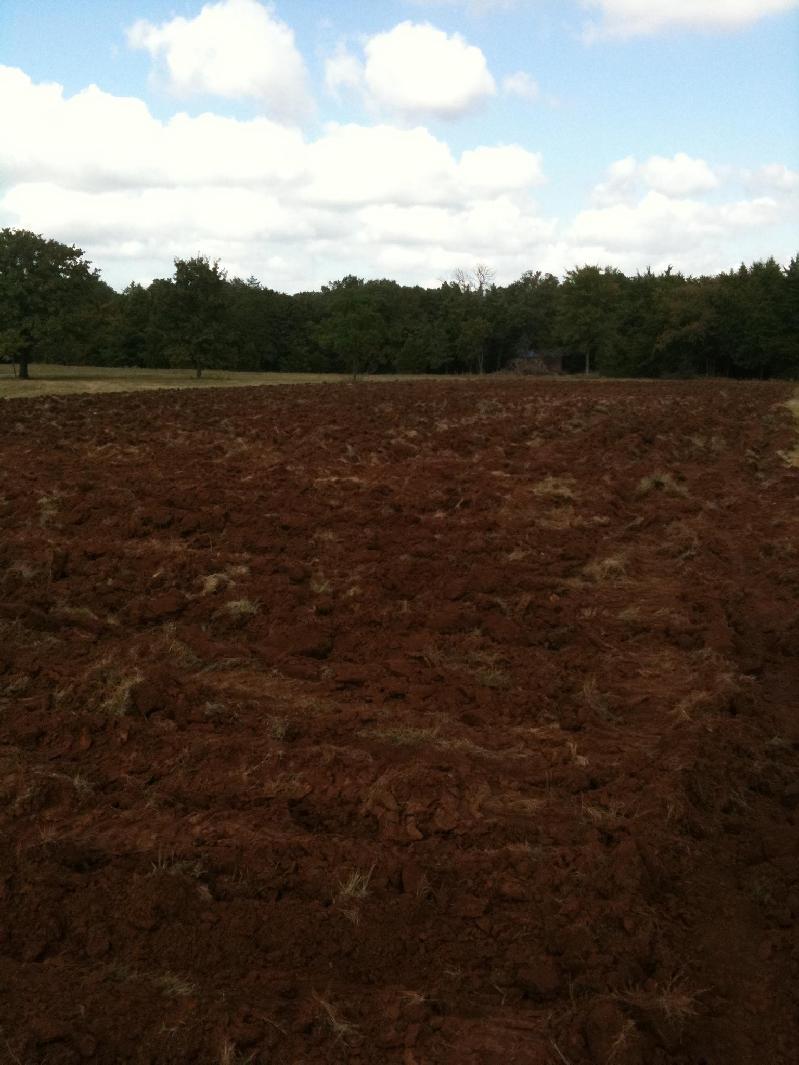

I'm really pleased with it. Check out the results

That really looks nice. How hard does she pull? Ken Sweet
For the most part smooth as a hot knife through butter...and that's at speed 1-3, at 1-1 it was just too slow. A few times I found it trying to go too deep so I might need to adjust my toplink. I hit a few spots where the clay was dense and I noticed when I was done there was a clay buildup on the upper portion that was preventing the turning over of the soil. I'll have to watch that closer next time and scrap it off as I go.

Sounds Great, As the plow "Scours" off it may eventually not stick. Always grease the plow surfaces between plowing. Ken Sweet

I used sandpaper and my drimmel tool to take the top layer of rust off the foot part of the blade, I was able to sharpen it a bit too. See pics above for my first time with it in the ground. Overall, I think it's going to work out perfectly...especially when the upper portion gets "scoured off" as Sweettractors mentioned.
