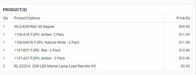

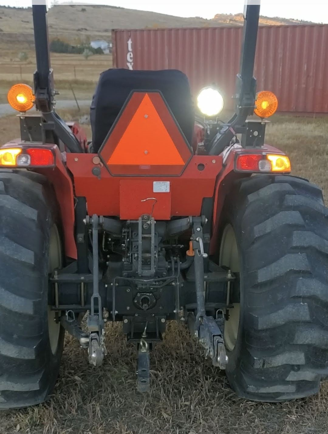

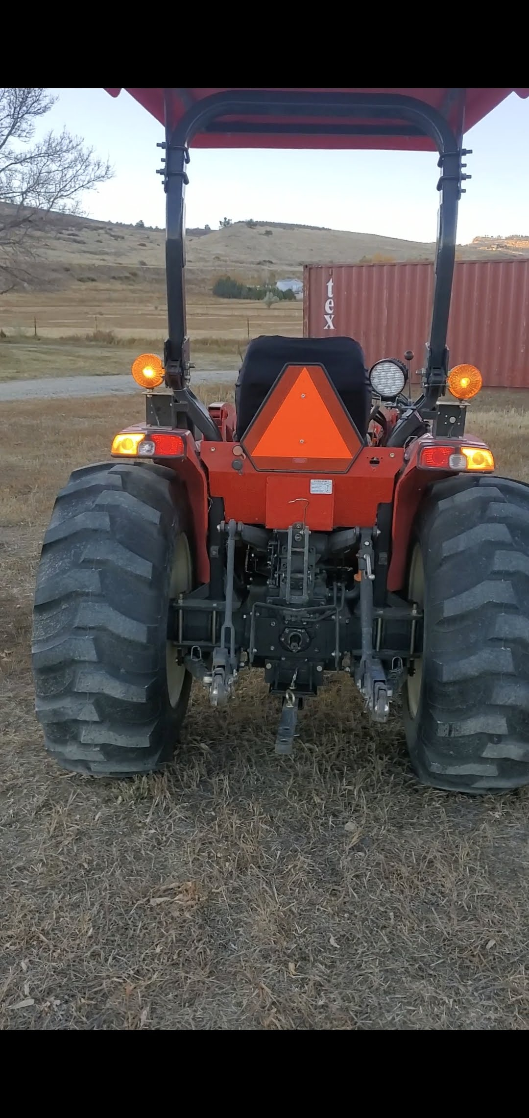

got my led's installed. the work light with the switch seems pretty heavy duty. nice cast housing, big stainless hardware.
the lights are brigter to the eye, esp. the back up lights. the blinkers are a bit faster, but not enough to make me put the resistor in. the 4 way flasher is a nice speed now and before it was quite slow. left side is LED and right is stock (work light side). hard to get in a picture, but the LEDs are brighter. reverse lights are much better, hard to show by ones self though.
part numbers: did not use the resistors. YMMV on that.

I replaced the rear work light with one of these: Amazon.com: OZUSA 3" Round 12w Osram LED High Output Exterior Interior Utility Work Light Flood Beam with Toggle Switch for Offroad SUV SxS Truck Trailer RV Marine Vessels 12-32 Volts : Automotive
The switch is easier to operate than the stock light and it's brighter.
It bolts right on. The factory electrical connectors appear to be 3.9mm bullet connectors like are found on Japanese motorcycles. I had those and a crimp tool so it was extra easy to wire it up.
