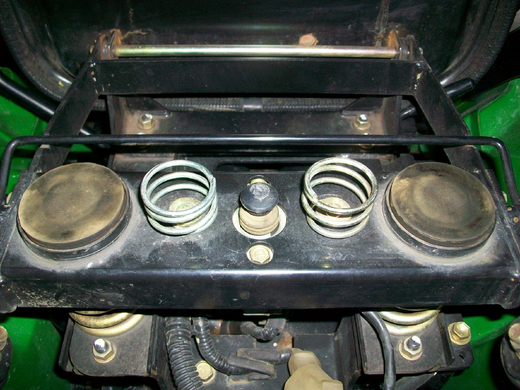

How did you fix it with a paperclip??
flip up the seat, you will see the connector to the seat switch. Pull it out, use paper clip to jumper it, but don't let it touch anything else or it will blow a fuse.
Disclaimer, I do not advise doing this, if for some reason the mower is on you could lose a foot, if you have loose clothing it could get caught by the shaft and kill you, those and a hundred other things that could go wrong around a PTO.

Here are some pics of the seat switch that I mentioned that I have on my 4115. I'm sure that most Kubby's and Massey's etc., will be similar. You pull the knob up, raise the crossbar, and then lower the seat down onto the cross bar-
I wish my 2305 had a feature like that.
   / anyone use a JD 2305 with a wallenstein bx42? #25
My 4110 and 4500 were the same way as this 4115. It is nice to be able to just lift the knob, raise the crossbar, and lower the seat back down. If I had a 2305 I would make a jumper wire too. I have had to do it for other machines I've owned in the past.
