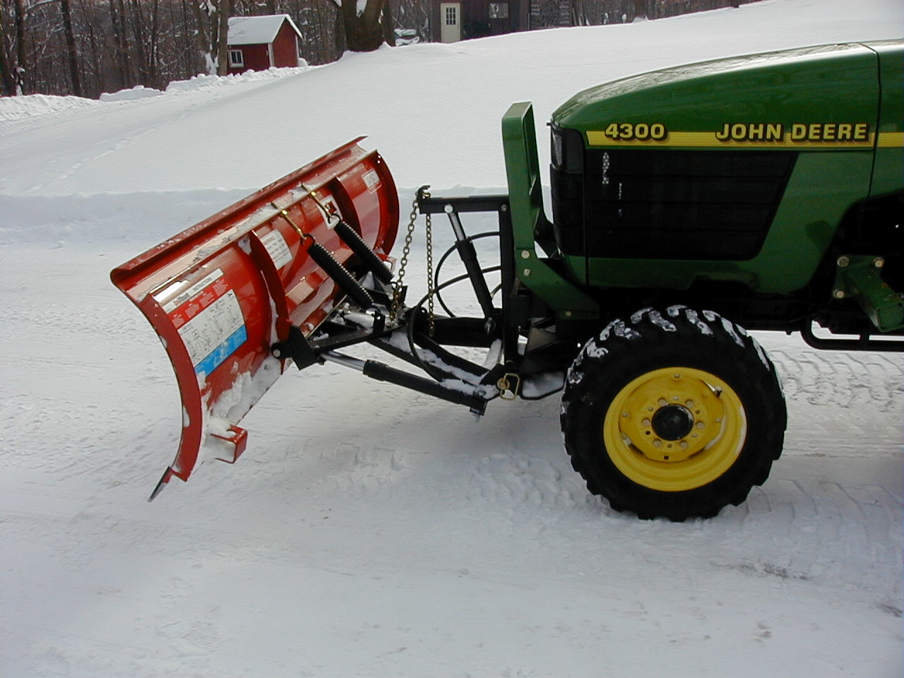

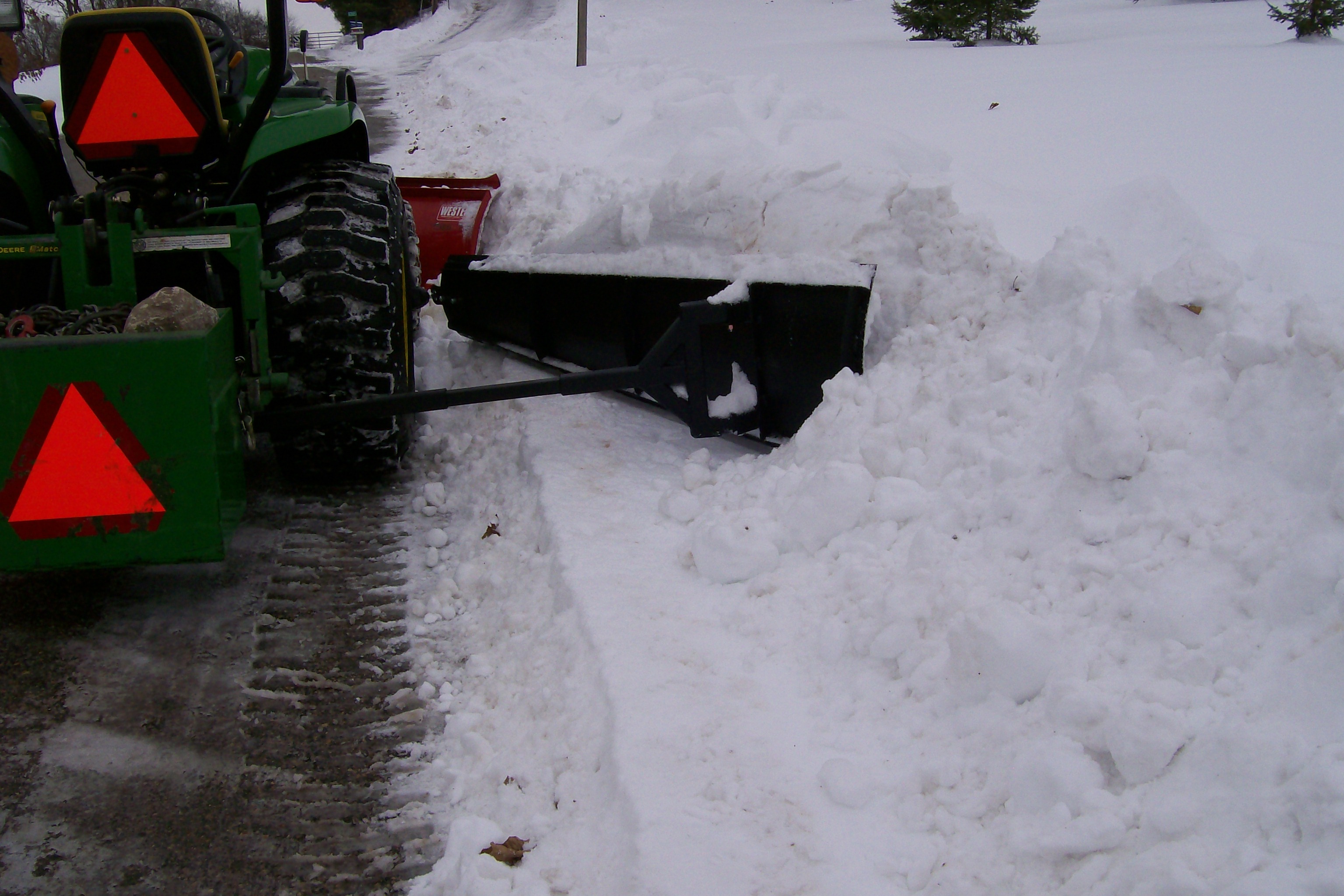

Many year ago I put 7' Western plow on a quick hitch that I fabbed. Kept the blade close to the tractor, and has plowed through everything that mother has thrown at me. 1/4 mile road/drive and two turn-arounds to clear. Later I fabbed a wing plow to push back any banks of snow built up, and not a lot of cost involved.
That's a great set up! Nice job.
