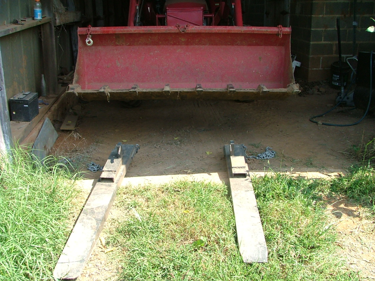

These are probably overkill for what you may need, but I got the "forks" for $20 each, C-Channel and flat steel I got at a fabricators shop. Load binders from Lowes....
