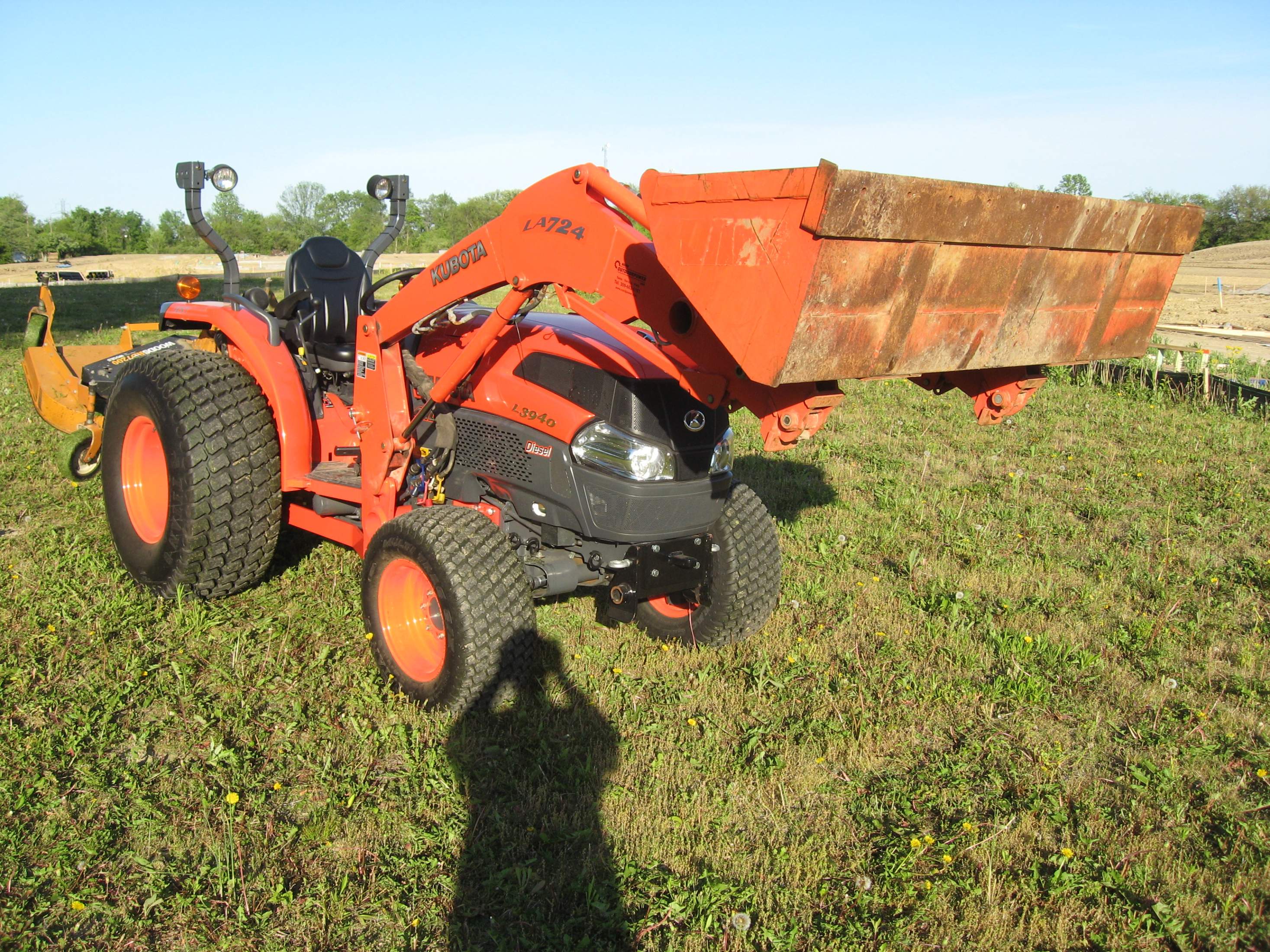

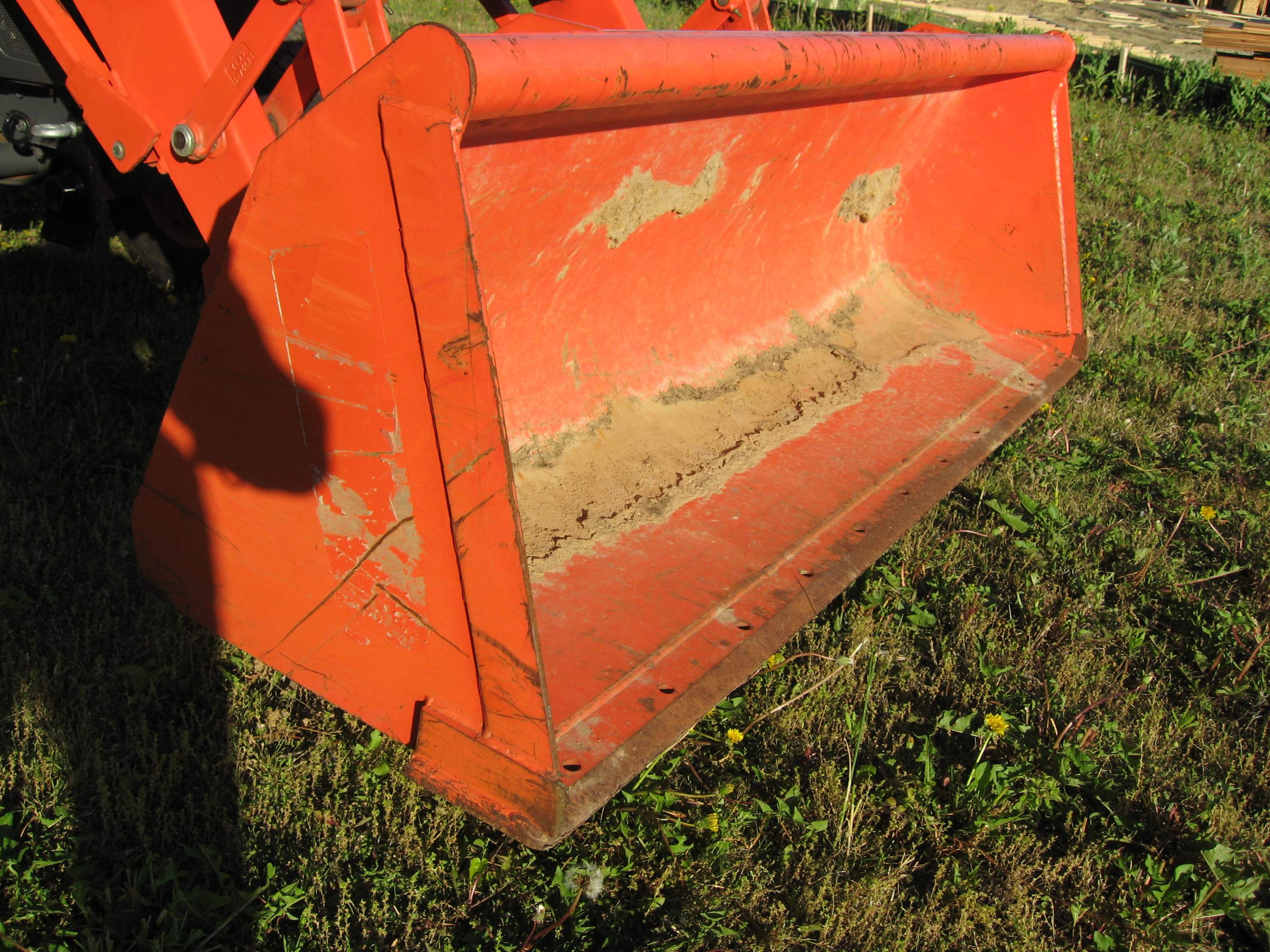

Here are some pics of the heavy duty round back bucket for the LA724. Bought tractor new, but bought loader used. Bucket has seen some abuse from unknown past, but is still straight. See if you can trade your bucket in for a HD round back. Might be worth a little something. Used ag equipment is usually sold as is, and I am sure there is no warranty on a bent bucket. Philip.
