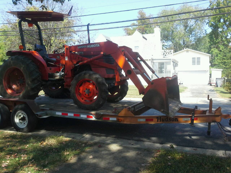

If I could figure out an easy way to attach an equipped cab w/ heat, a/c, radio, sound proofing to my M4700 for low $$ I'd get one in a heartbeat. But I only paid $11.5K for the tractor and a $4K cab would be gilding the lily. Plus it would be a hassle in the woods. My son already bent my canopy,
notice upper left corner, and when I removed it the tractor fit's in my low garage door w/ less than 2" to spare.
But I'll be doing a LOT of driving in the woods and I can't imagine driving with a cab. So I'd want something that popped on or off in a few minutes.
