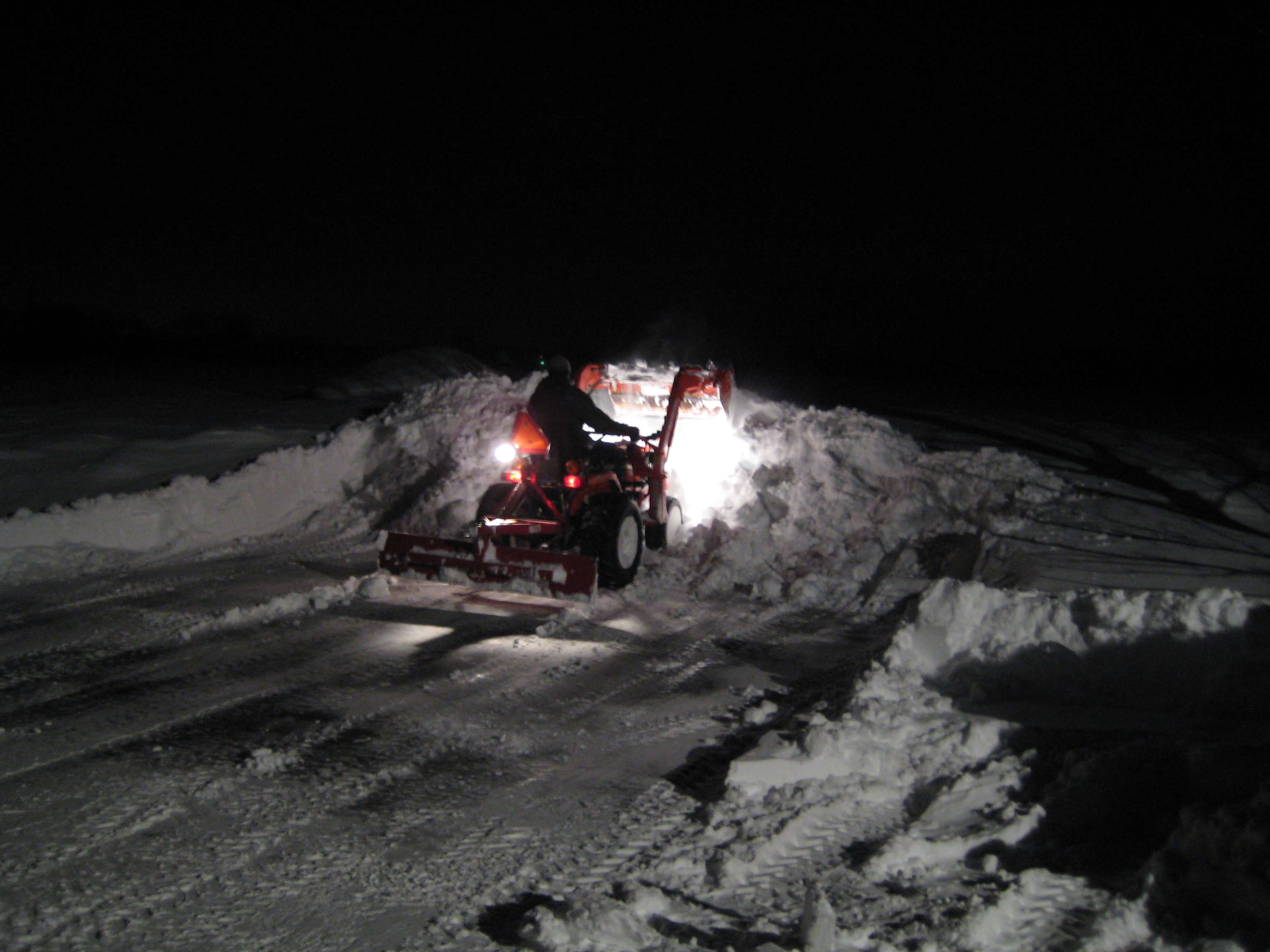

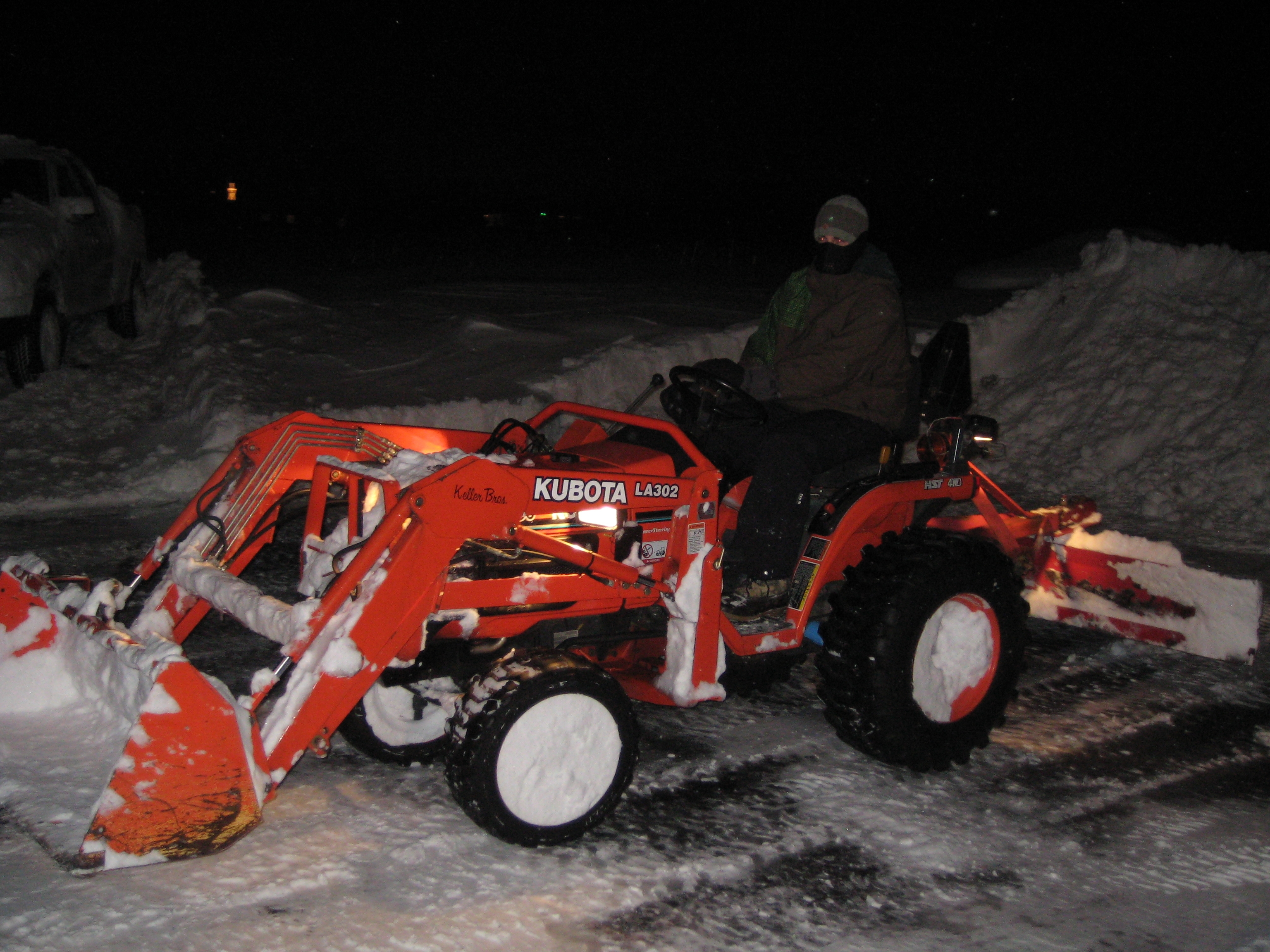

On a B7500 years ago I mounted the lights on the part of the FEL frame that stayed on the tractor. That worked better than one would expect. The lights did hit the back of the bucket, but the only daqrk spot was behind the bucket (view blocked there anyway). The headlights were not effective at all. Maybe because they were too close to the bucket?
