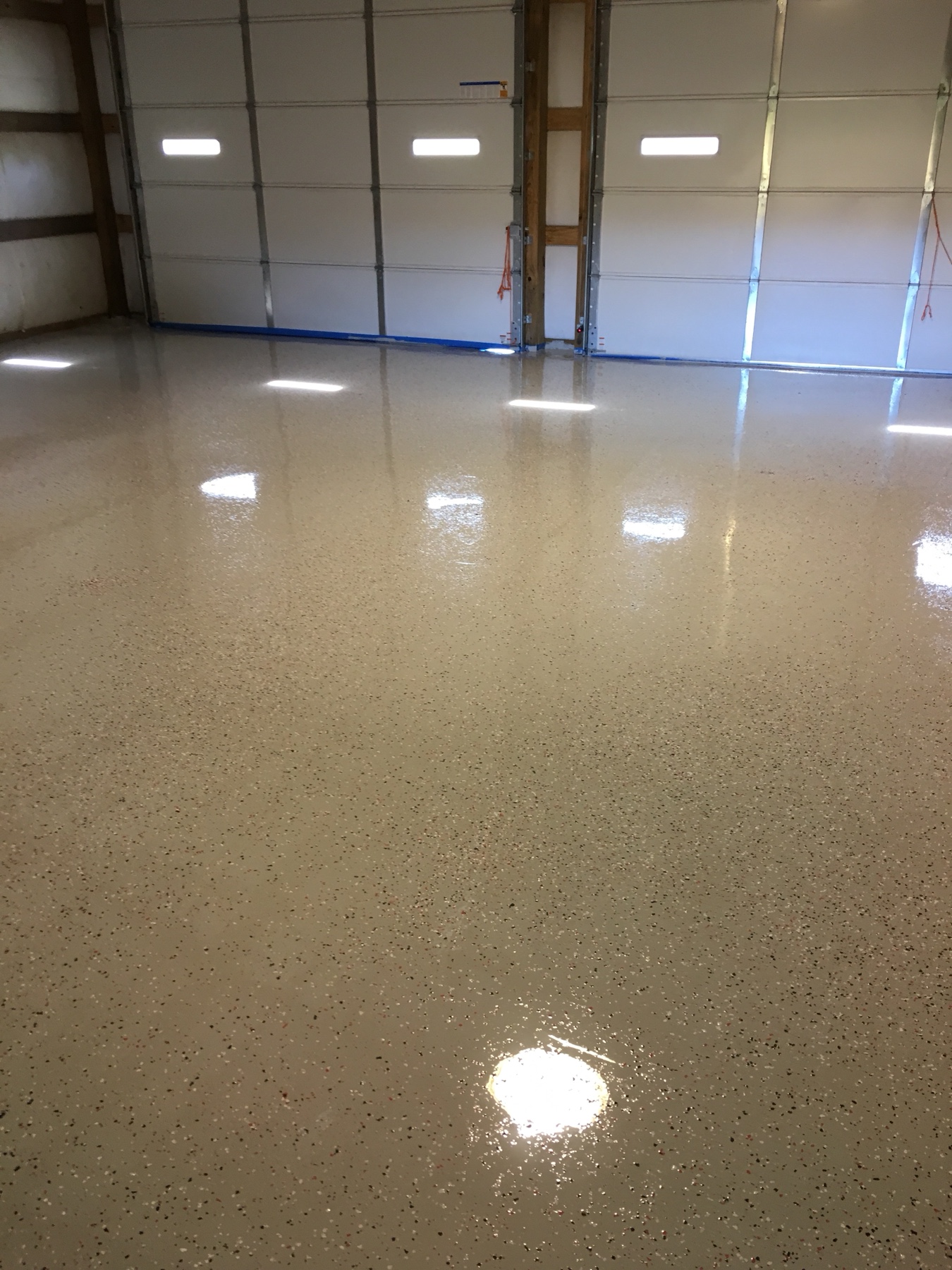

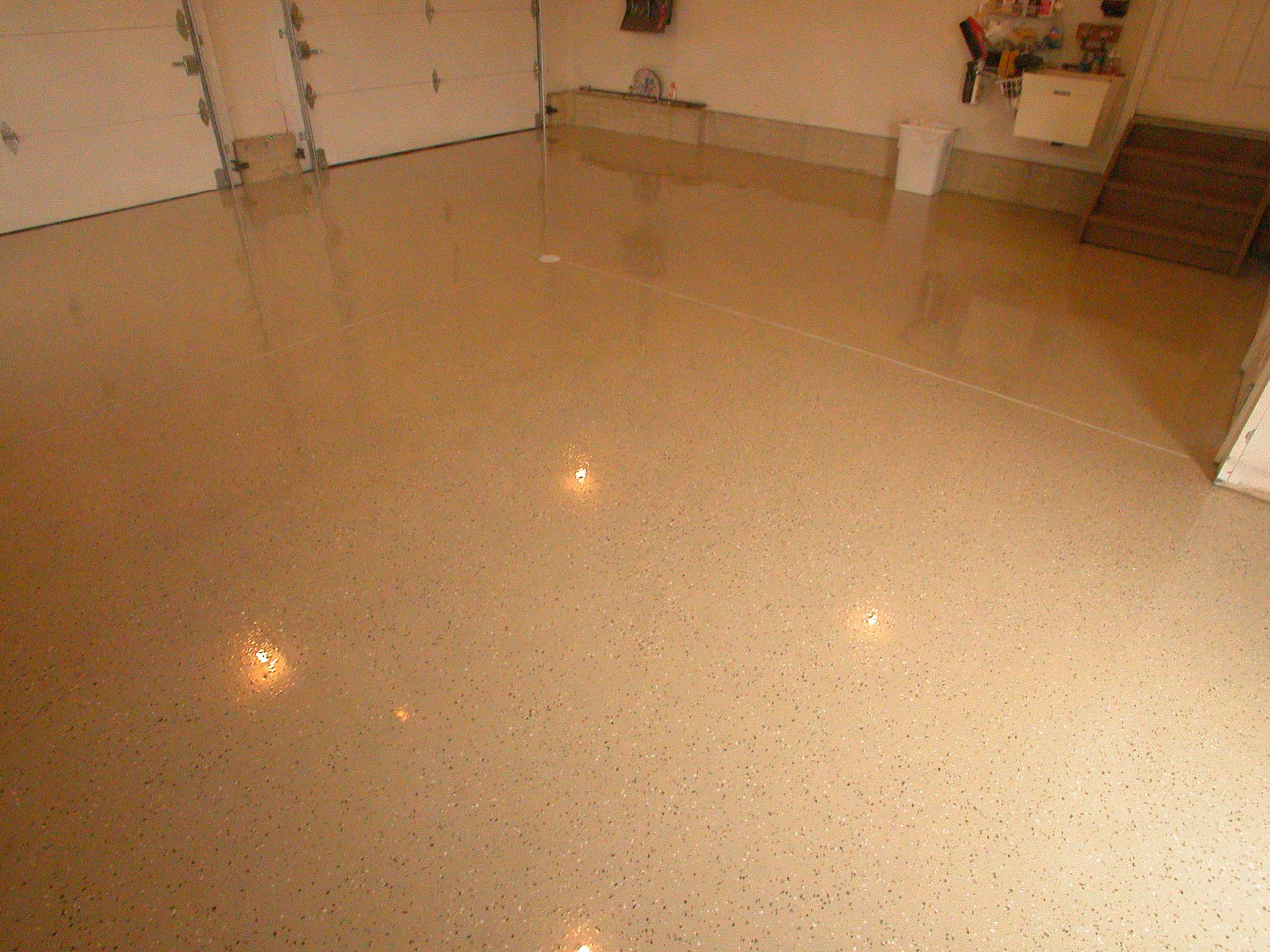

Finally got around to doing the floor coating for my shop it’s only been sitting 3 years waiting for me to make a decision on which coating and also the time to do it.
I ended up going with Armorpoxy brand and there armor ultra kit, it’s a 3 coat process. So far I’m really pleased how it turned out, how ever it was a LOT of prep work for 1 person with it only being 1200 Sqft.

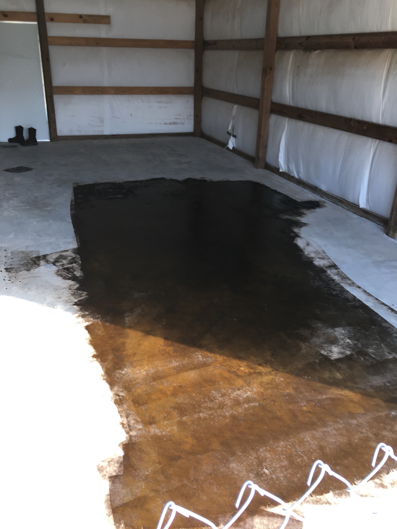

First was many power washings of the floor and scrubbings , I then lightly went over the entire floor with a 7” hand grinder with a diamond cup wheel. The shop had only been used to store my tools and shop equipment since it was built but I did find a couple of spots were some oil leaked out of a tote and a piece of shop equipment. After cleaning many times I still could not completely remove the stain , so I ended up using a 2 part oil spot primer over the area were the stains were just to be safe.

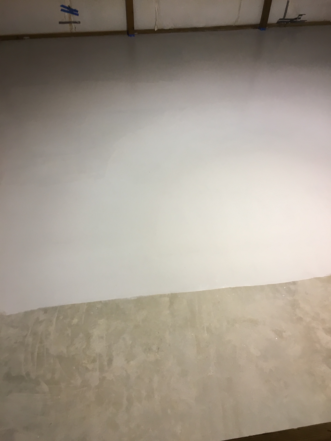

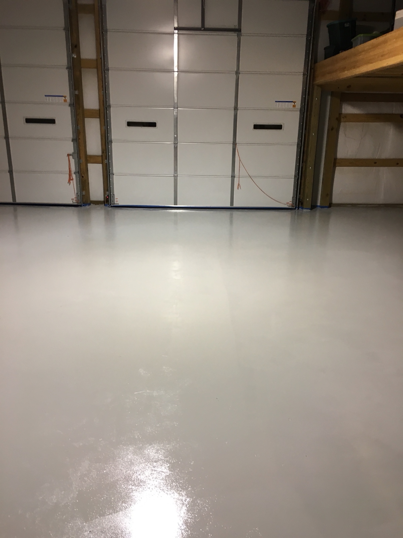

The next day I did the entire floor with the 2 part epoxy primer.

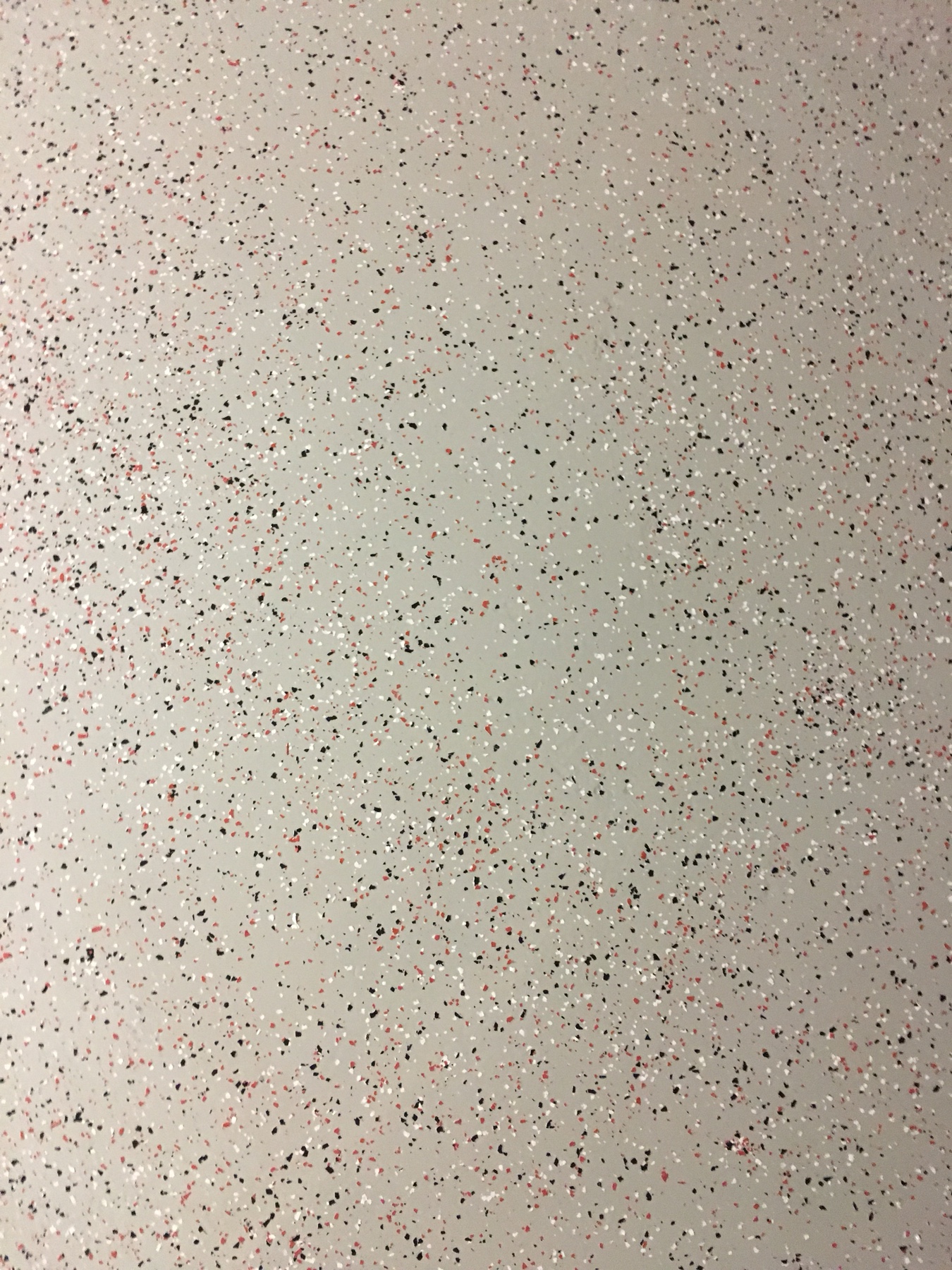

On the third day I put down the epoxy and color flakes. ( The lighting in the pic makes it look tan for some reason but it’s light gray.)

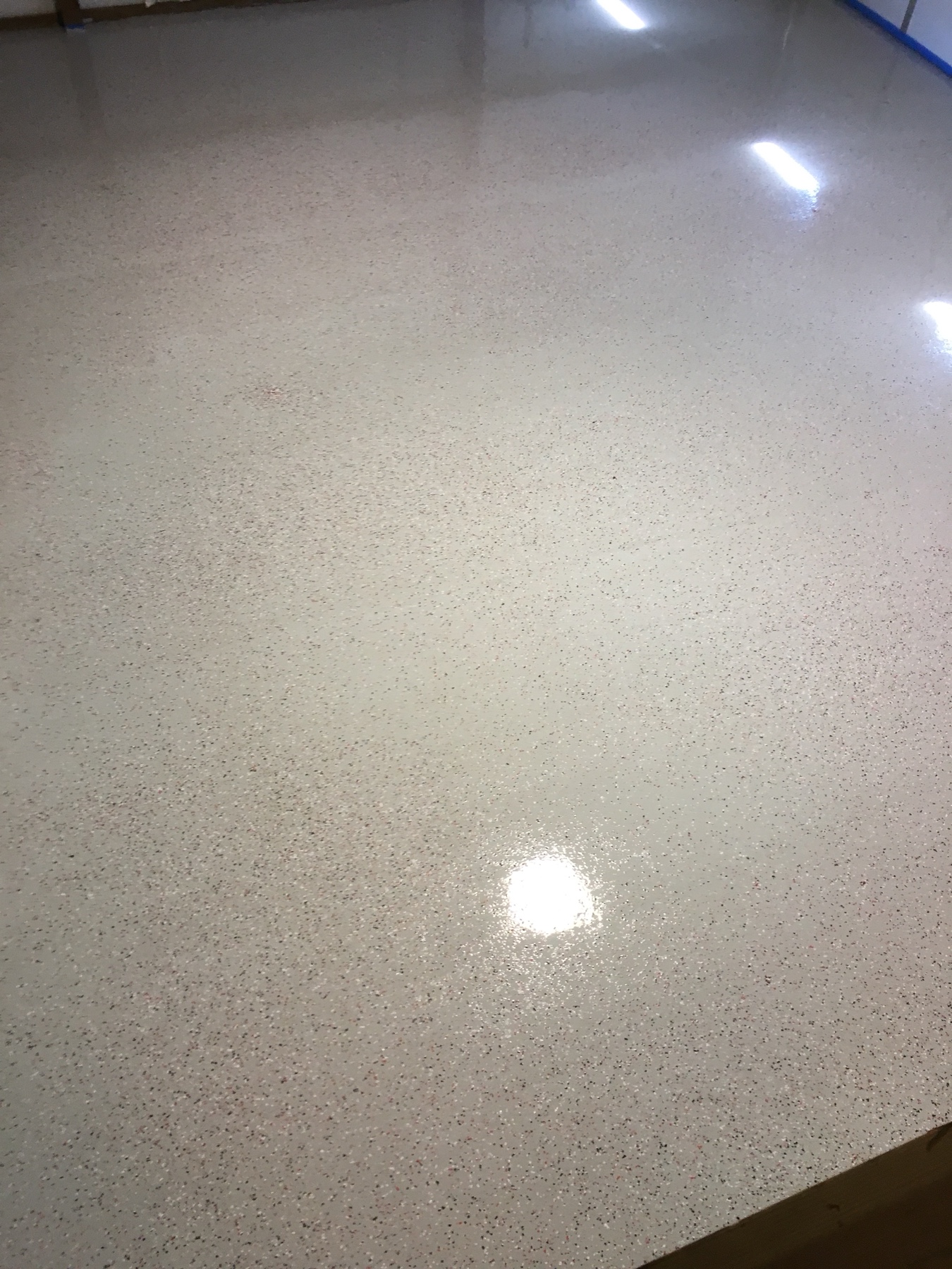

Fourth and final day was the 2 part military clear top coat.
This was after a couple days of dry time.

Floor has been down about 4 weeks now and I’ve finally started doing electrical work and started putting the white wall metal up. Should really start to brighten up inside.

Yes it can be scratched by heavy equipment, nothing on the market is scratch proof. According to armorpoxy there are ways to get the floor into a usable condition to install a coating. If I were going to have heavy equipment with tracks and such I wouldn’t have done this type of coating. Also welding sparks and slag from cutting torches will put burnt spots in it.

I did my garage about twelve years ago, with Epoxy Coat high solids. https://www.amazon.com/EPOXY-COAT-FULL-KIT-BEIGE-500/dp/B00C7VX2V4
I used the single coat system. Clean it, grind it, vacuum, paint it, flake it, dust with in traction sand, done.
There is some wear, in the areas where the car tires run, and trash containers are stored. But, has stayed down, it's still shinny, and looks good.
/ Armorpoxy Floor coating. #14

How did oils that may have soaked into the concrete clean up, assuming you had that?
They give you a prep to clean it with in the kit. That worked fine except one spot, where there was a prolonged power steering leak on one of my old vehicles.
That spot fish eyed a little. I dropped some paint in the fish eyes with a small brush the next day. It's not noticeable.
I did not anticipate a problem, or I would have soaked it with solvent, and used compressed air to remove it, prior to painting.
It's hard to get the paint spread out thin enough to get the 500 sq ft coverage the say the kit is good for. I have 450 sq ft, and I just got it all covered.
If it's the first time, I would figure to only get 400 sq ft, out of the 500 ft kit, so you don't have to sweat having enough material.
I also recommend buying the spiked sandals, so you can walk out in the wet paint, to broadcast the paint flakes, and sand. Buy extra, and practice spreading the flakes, and sand, the day before. It does take some practice to be able to keep your coverage even. Throw them upward, so they disperse more evenly.

We have the same stuff the OP used on his floor in our shop. Gravel road, skid steer going in and out. It scratches the floor and dulls the finish. Takes a while to get to the point where you need to go over it. 10 years for us. We just went over it with fine floor sander. Then thin coat right on top. Did not cost anywhere near original job. Happy with it, makes cleaning oil and grease much easier.
