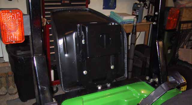

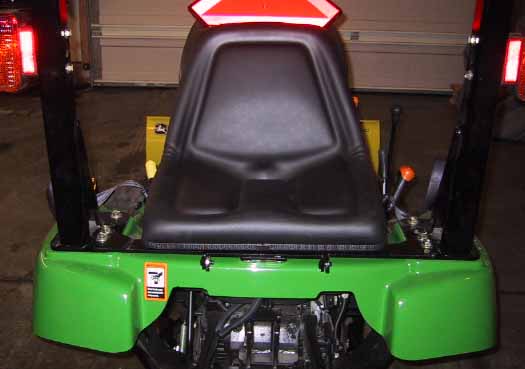

Scrounger,
The seat is removed from the tractor. The frame on the seat itself has two pins that slide through two holes in the seat support that is attached to the tractor. See attached photo.
PDe
