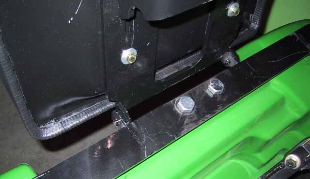

Back from the Canary Islands, my Woods backhoe has not been so rosy:
1) Woods forgot to send the sub-frame. Two more weeks delay.
2) Installing backhoe, 6 bolts missing.
3) One of the quick release pins that hold the hoe refuses to get in, despite careful alighment. Still looking into why. Using bolt at the moment.
4) Sub-frame interfere with 54" mower gear housing. Had to raise rear of 2210 with car jack, so much for 3 minutes mower setup.
5) Sub-frame 50% interfere with mower lifting arm points, making an awful racket. Very annoying.
6) The woods delivered seat was torn.
Otherwise, the sub-frame is VERY stiff, grabbing hold of the hoe and shaking it shakes the entire tractor in unison with the hoe,e.g: no bending. Recreational digging with the 2210 and this hoe presents to worries.
At least the dealer gave me a free Case cap, which is more than I can say for the 2210 dealer.
See attached picture of my lazy susan seat device which allows the 2210 seat to be swung around to use the hoe. Sorry can't show much more unless I disable it, and with the prioblems I've had, I'm not too happy at the moment! :-(

I've solved the mower jamming into the sub-frame (Woods leaves no room here) by removing and bending the sub-frame arms another 3/8" and adding further shimming plates at the front. It is still annoying though to have to lift the 2210 with a jack to get the mower under it. PDe, do you have this problem?
Attached is a picture (a fake one! that hole was made a day previous). Note the YELLOW seat, the original 2210 on a lazy susan. Yup, it's a John Deere cap on me head: I had to buy it, no freebies from JD! :-(
Anyway, have no fear, the hoe is solidly attached to the 2210 and transfers the loads properly. If you want a hoe, get one, but it's a small one, with barely a 6 foot sphere of influence! :)
