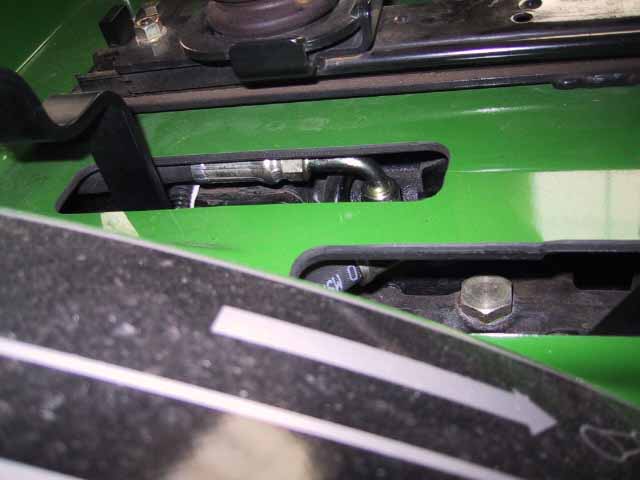

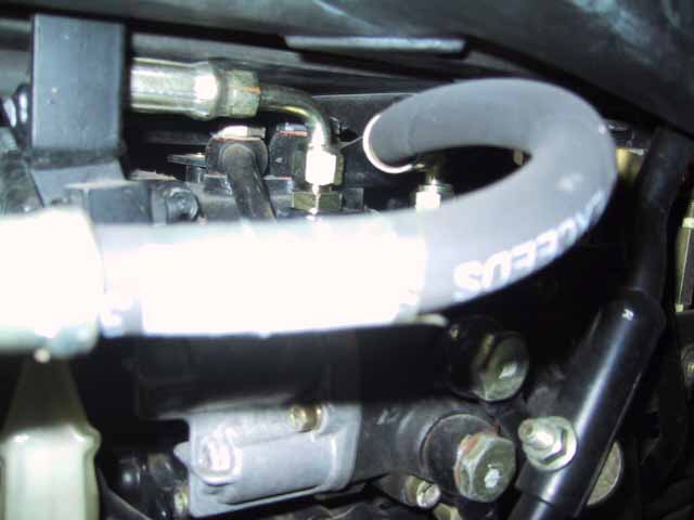

PDe,
your images have been very informative, if numerous! I noted on one that it answered a very important question for me; where to get supply and return pressure for a backhoe on the 2210 since the SCV valve hogs what was available from what I could see.
On one of your pictures, one port is clearly available on top of the SCV housing, but the other, seemingly on the left side of the case is not so obvious. Can you provide a picture of where the other hydraulic connection goes? Do you know which is supply and the other return to tank?
BTW, is the Woods much more expensive than the Wallenstein BX-600 (someone here quoted about 5K$ US funds with sub-frame). Clearly it is superior in most respects, and the sub-frame is more carefully designed and clever. The wallenstein sub-frame is un-inspired.
Much appreciated.
Cheers
   / Arrived! 2210 Backhoe
#75
sdowell,
Photo 1 of 3 attached. The second port is just left of the port seen in the earlier posted photo (not sure which is supply and return). Just a tick north of four for the bh, sub-frame, mounting kit, hoses, all hardware, the seat, delivery and tax. More photos coming when the initial dig takes place.

Photo 2 of 3...
