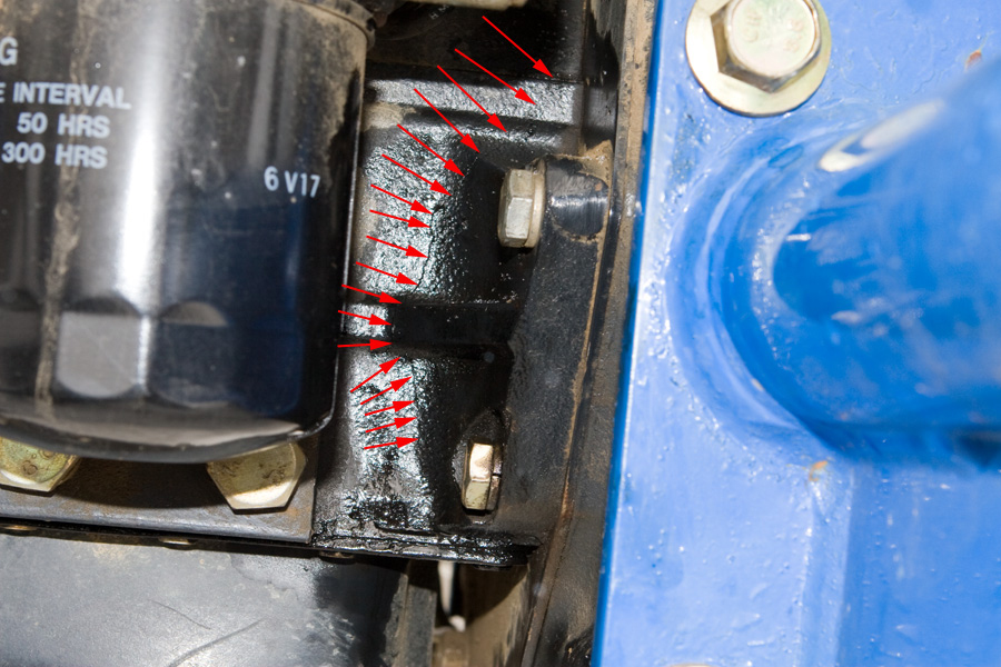

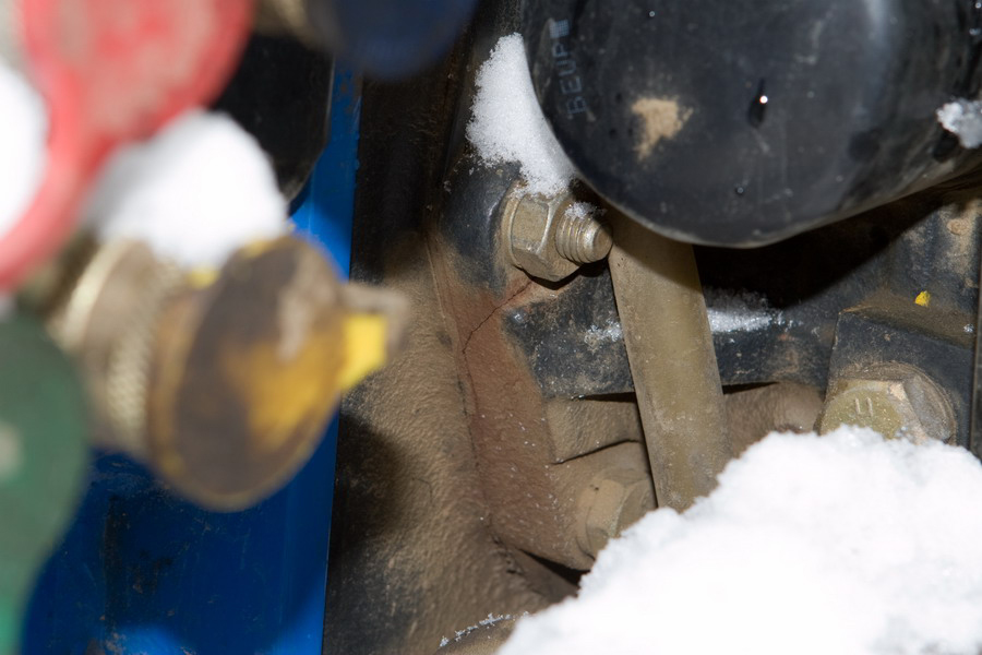

Again, thanks all for the GREAT suggestions, and listening and sympathizing. It means a lot.
Here are pics of the carnage. I added arrows to the crack on the left side, because it's somewhat hard to see. Apologies to those with slow connections (me too...) and small monitors.
It's fairly clear that this crack has been here for a while. I guess since I wasn't looking for it, it was easy to overlook in my garage whilst performing other maintenance tasks.
As you can clearly see in this shot, the lovely 'subframe' ends JUST before where the block broke. Nice design NH!
I went around it today, and found NO, repeat NO loose bolts anywhere.
And to add insult to injury, it now flat refuses to engage the starter motor. You can hear the solenoid, but no start. I can turn the crank by hand, so I know it's not seized..

Kris,
Sorry for your loss man, that's definitely a big bag of suck. I second the idea of calling in a metallurgist and a welder that specializes in castings.
You said a short block is 7600, what is the price of a bare block? If it's running fine, why replace everything below the head gasket, just swap the parts over. (checking clearances of course)
You said the it appears that it broke in a ^ pattern, how is the upper bell housing bolts/casting? There may be more damage there.
Your failure to crank may be caused by the ring gear having been popped off the flywheel from interference or starter housing damage when the block/bell housing mating flexed.
I suspect your oil leak is being caused by seepage from the crack through to the crankcase or a oil pan gasket surface that is no longer parallel, if it was a galley, oil would be forced out under pressure.
I would pay attention to the mating surface alignment and square along with dowel length when it is disassembled. Either one being an issue would cause the block/bell housing to be stressed. Not that I don't trust a dealer but I would try to be present with a good camera to document everything just in case there was evidence of improper assembly at some point.

Kris,
I agree with you that the crack been there for a while but it does look strange. Where the crack occurs is the thickest part of the engine casting. The casting is thinner where the loader mount is attached to the clutch housing or tranny. The mount should also be connected to the front of the engine/frame and in effect make a parallelogram to keep the twisting force at bay between front of the tractor/engine and clutch housing. On some tractors like most Kubotas or TLBs the sub frame is tied to the rear axle rather then engine. How is your mount connected to front of the engine? Is there anything missing there? it looks to me the parallelogram that transfer the load between clutch housing and front of the engine is missing something or somewhat bend. Crack like that might also be caused by carrying a heavy load in the bucket coupled with driving fast on a bumpy terrain causing a fatigue failure to occur eventually and what finally broke the camel's back was heavy snow and some twisting action. I'm sorry for your misfortune any time I read this thread but as all of us know only thing that can not be replaced is life and family and a tractor in the big scheme of thing is nothing.:)
