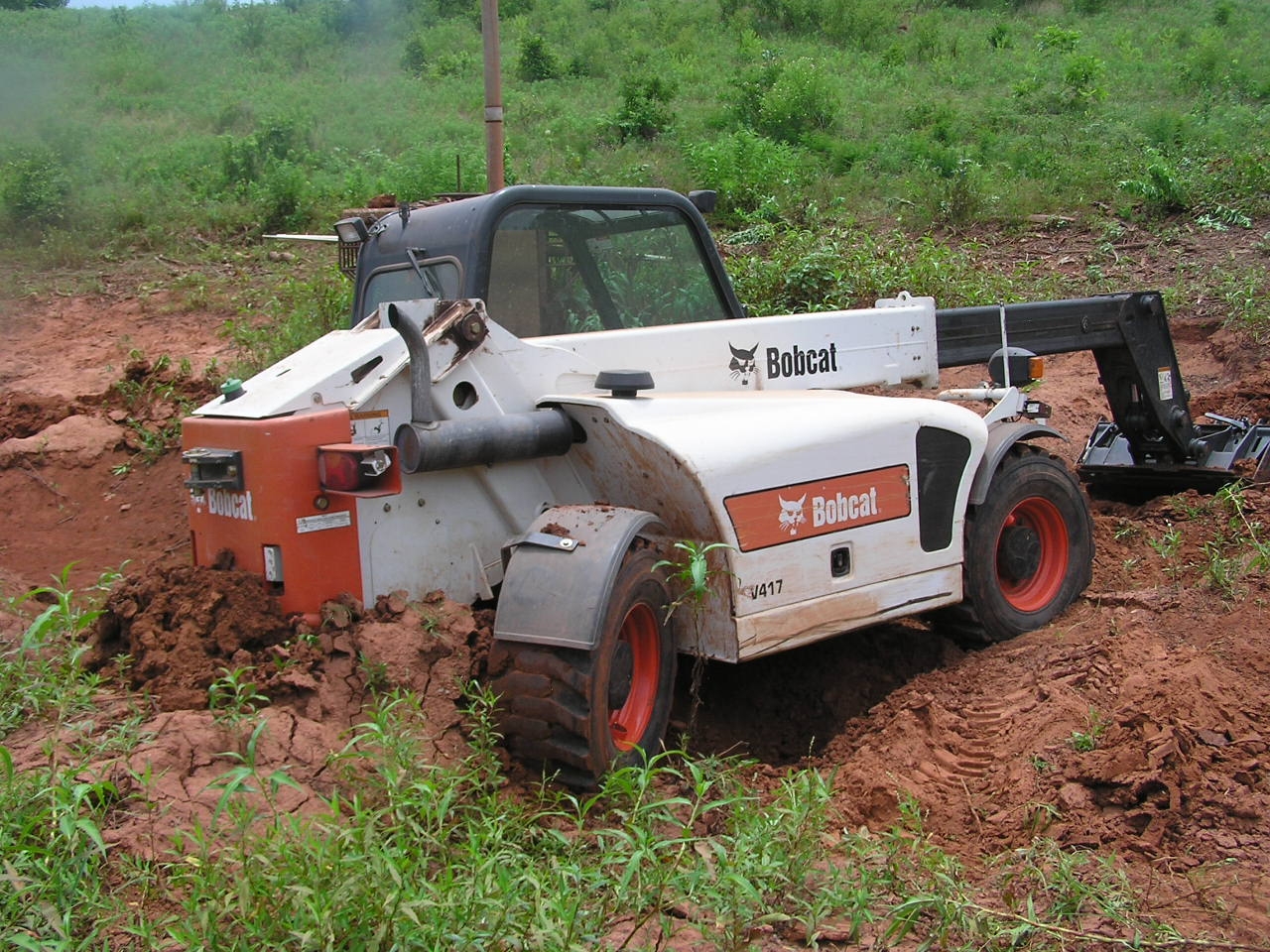

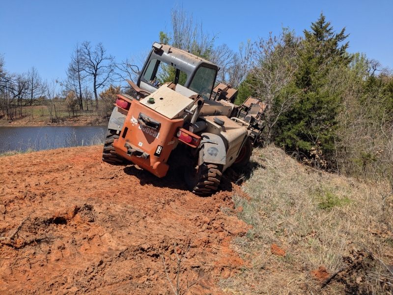

I like the compact telehandler, with the lower center of gravity and 4 wheel steering,
This is why:

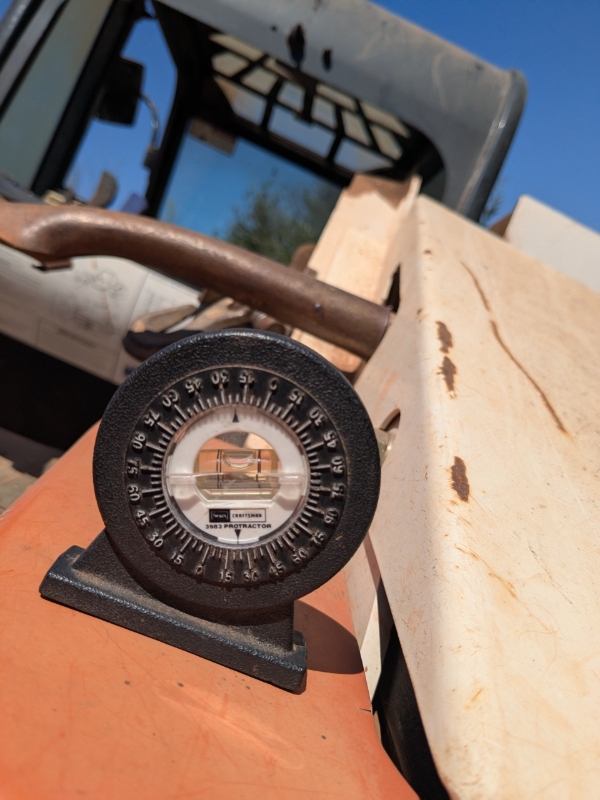

Was wheel packing dirt added to the dam.
Checked angle at 24 degrees:

what slope can your machine overcome?
The steepest known side slope was 27 degrees on the back of a dam.
It has difficulty climbing steep and rugged slopes, on friable terrain how does it behave?
No problem climbing steep and rugged slopes. On loose terrain you can turn around and use the boom to push going up.

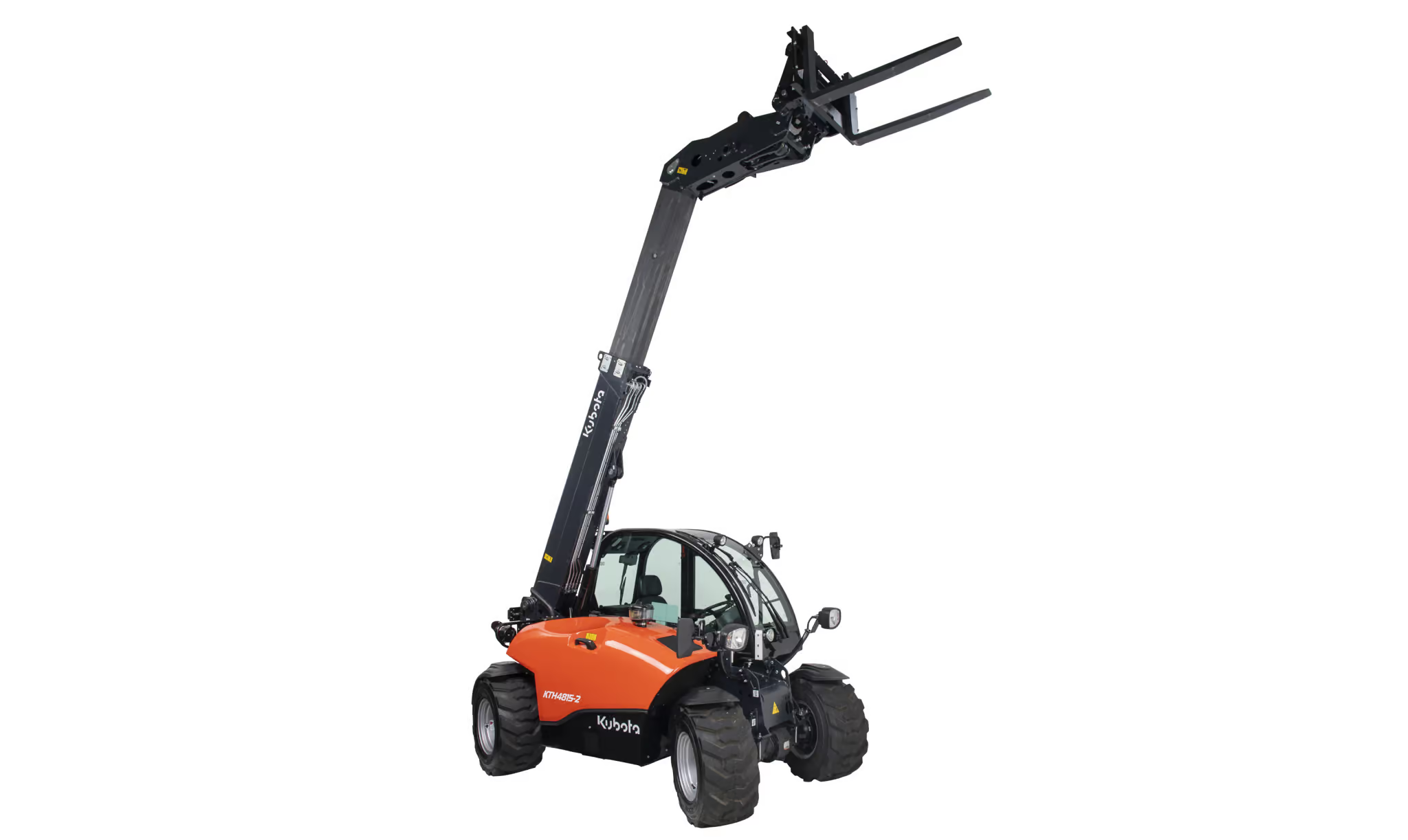

KTH4815-2?​
thanks I have to think about it. my land is on a terraced hill, alluvial morainic terrain, I have to find the right machinery thanks again I have to think about it before investing my capital.
