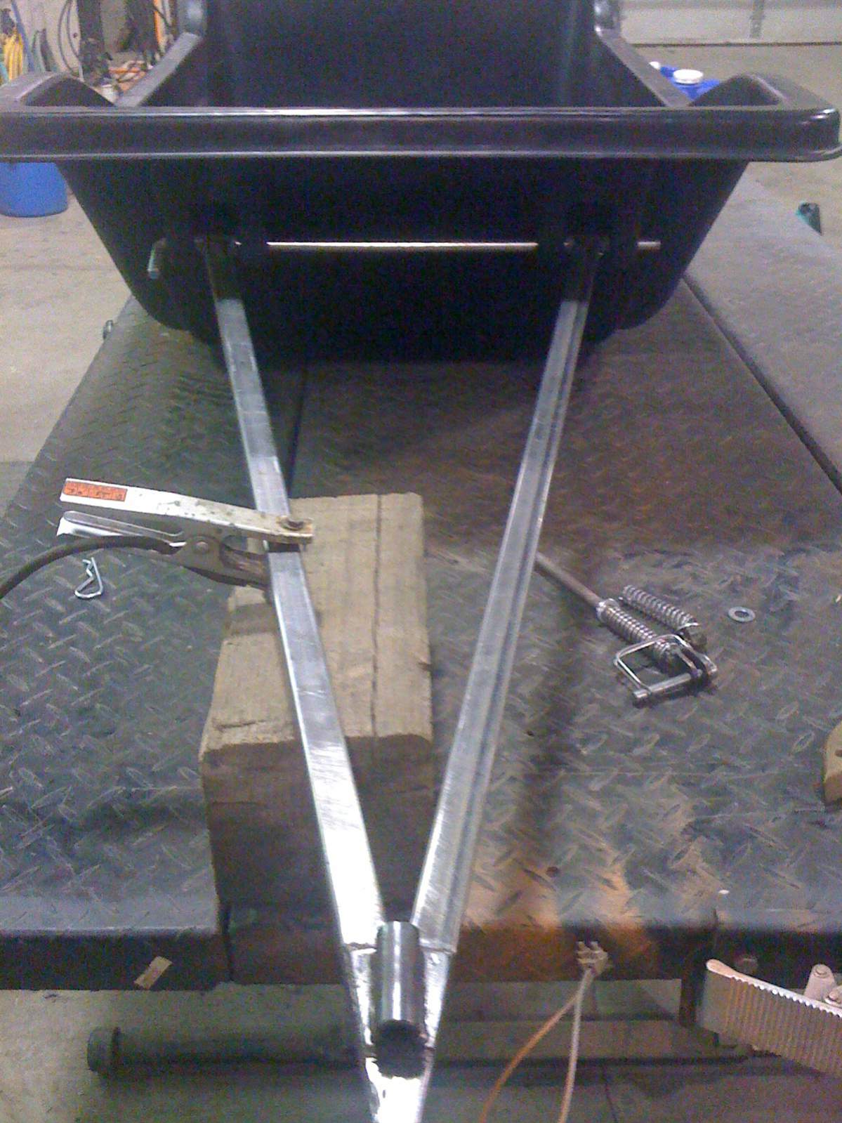

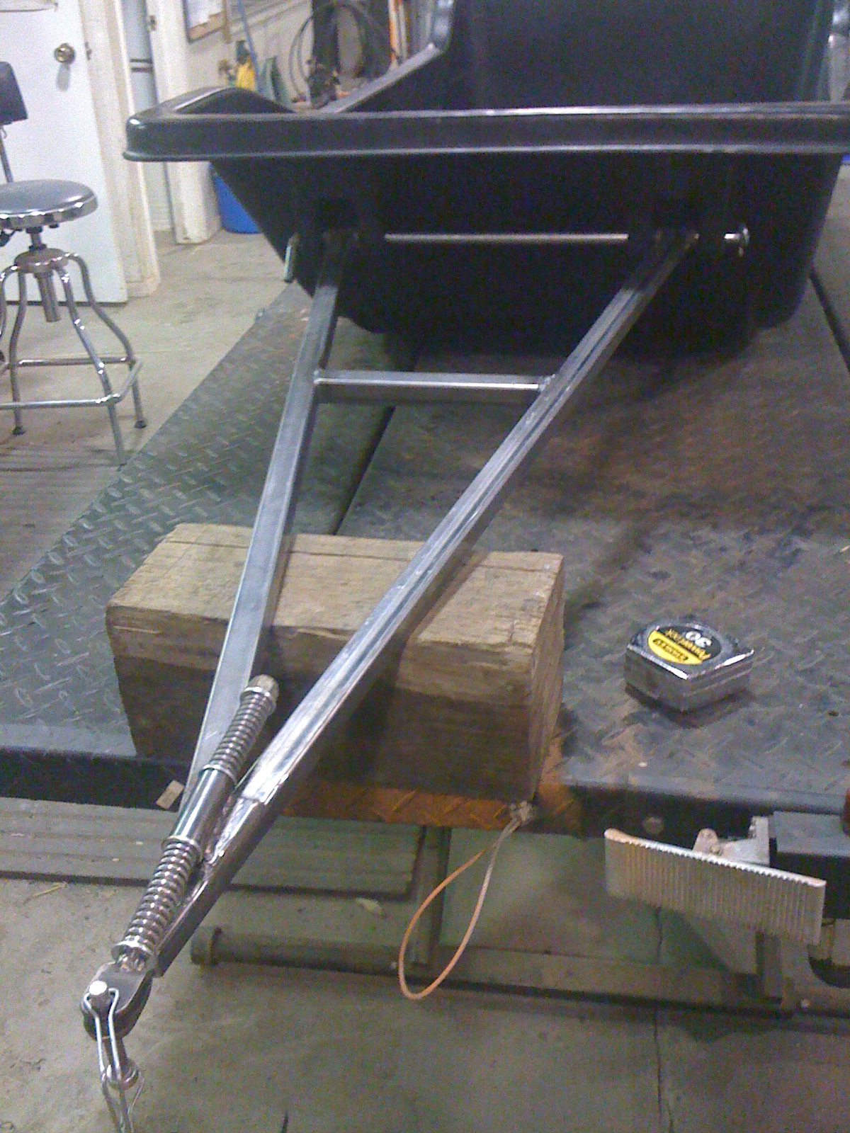

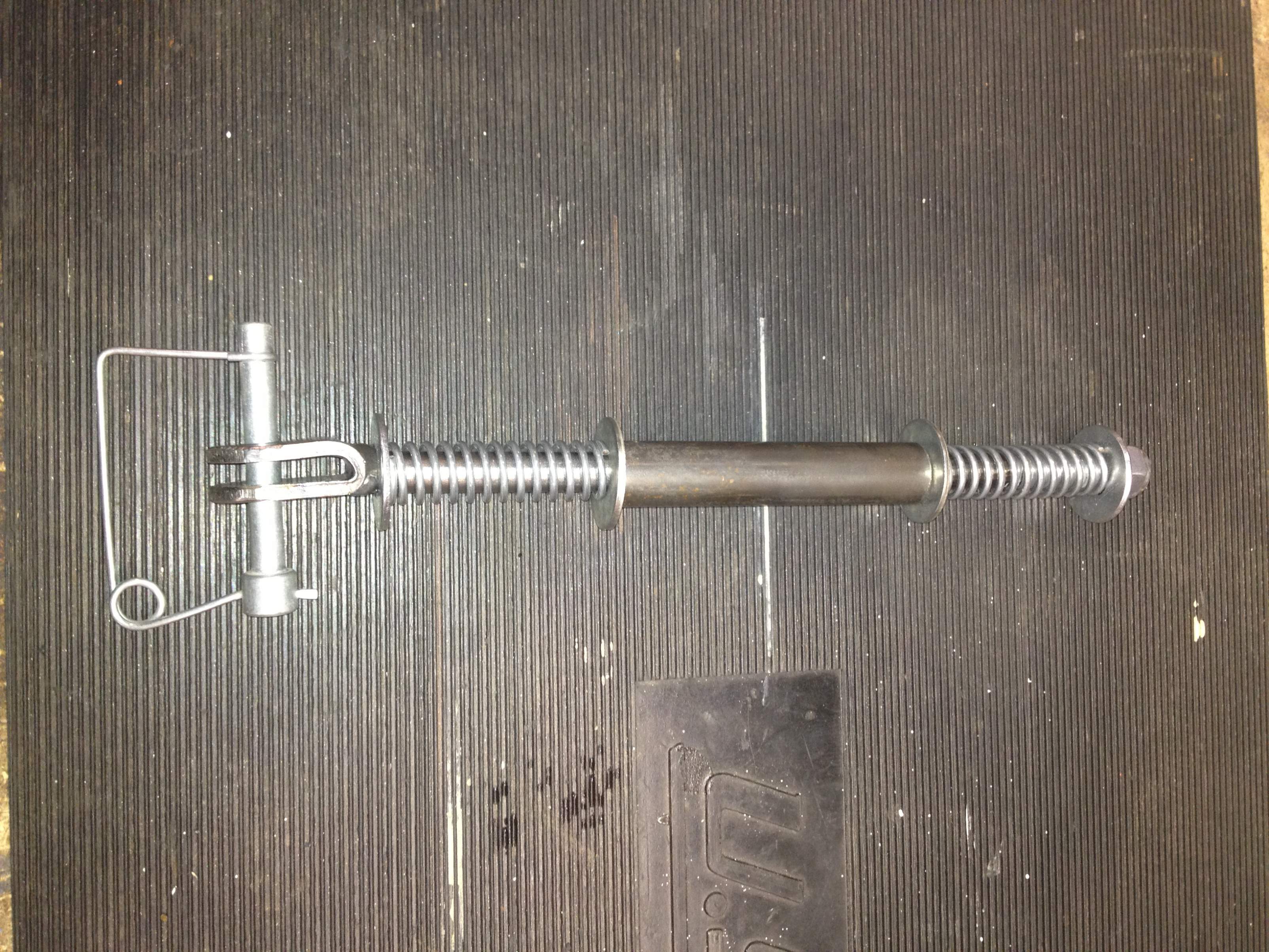

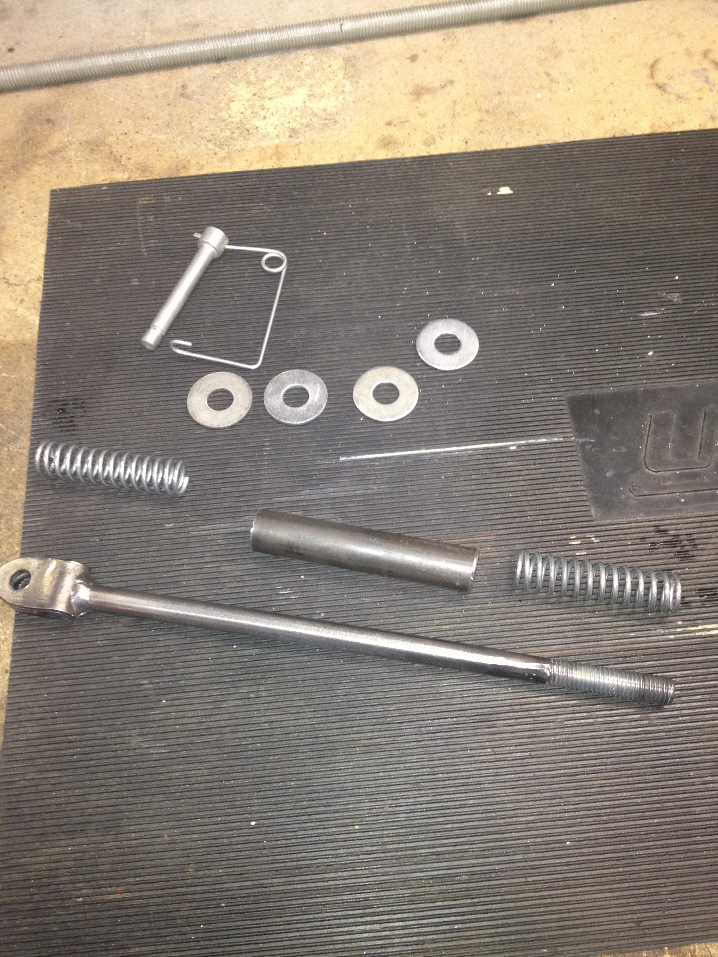

Can you build one similar to what I did on my snowmobile gear trailer? Long bolt with springs on both sides to absorb bumps and shock. It will swivel 360* with no restrictions.
I like that, only thing is i would still be limited on the up and down "folding" type motion. I am going to look into a ball joint in town here in a bit and see what i can figure out.
