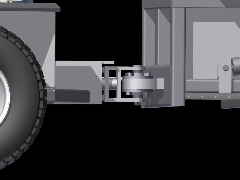

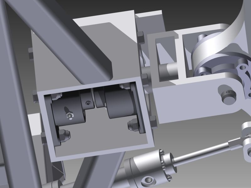

I'm building a utility vehicle that will have articulating center joint for steering. The photos show what I have now, but I don't like the design for the front part that has the downward force on the side of the bearing. I don't think they're really designed to take the load from the side. Any suggestions what I could use that is fairly cost-efficient and is more designed for that type of load. They will probably be about 1000 pounds on the joint at all times.
I'm presently using a Standard 4 Bolt Piloted Flanges Bearing for the front of the joint. That is the right-hand side of the photo.

You could use a pin and Bushing set up. A little more "primitive" than a bearing but the bigger the pin the more load you can put on it.

You need to box in the pin bracket. It will 'matchbox' if the joint gets a bending moment on it from single wheel impact loads. Yes this could 'impact' your steering/turn circle range, but that's the weakness I see...

If I'm reading this correctly you are looking for a bearing that will tolerate axial thrust as well as radial thrust and probably more axial than radial. Tapered roller bearings come to mind and the front wheel bearings in older cars, pickup trucks and trailers seem to tolerate those loads well. Maybe you can determine a way to mount a wheel hub in that location.

a wheel hub type system is definitely something I have thought about. And yes a tapered roller bearing might be my best option. And it should be fairly simple. Now just to find one that is designed to handle a sideload. Thanks

Agreed! A pin & bushing is by far the better choice here. Bushings are an excellent support for heavy slow moving loads and have the advantage of conforming to the KISS principle...something which is not to be taken lightly.

look into the front hub cassette off a newer (87 up) jeep wrangler or wagoneer/cherokee. these handle loads great! I was running (and wheeling) a stock front axle with locker and 36" rubber and never broke a bearing cassette (unit bearing) and used ones can be had cheap.

Why don't equipment manufacturers use rolling element bearings in the joints of backhoes, FELs, etc? You want a bearing that will live in an environment where it never reaches sufficient speed to create the hydrodynamic wedge of lube that rolling element bearings need to survive.

That and there is not enough rotation to get the bearing to wear right, if the rollers don't make a complete revolution within their race they will wear and become oval. once that happens they get excessive play and wear out quickly. that is why U-joints in a driveshaft have to have some angularity to survive.

Timken bearings are non sealed bearings so you would need to add external $eal$. Nothing about timkens is cost effective. I agree with others that pin and bushing is the best way to go, with greasable pins.

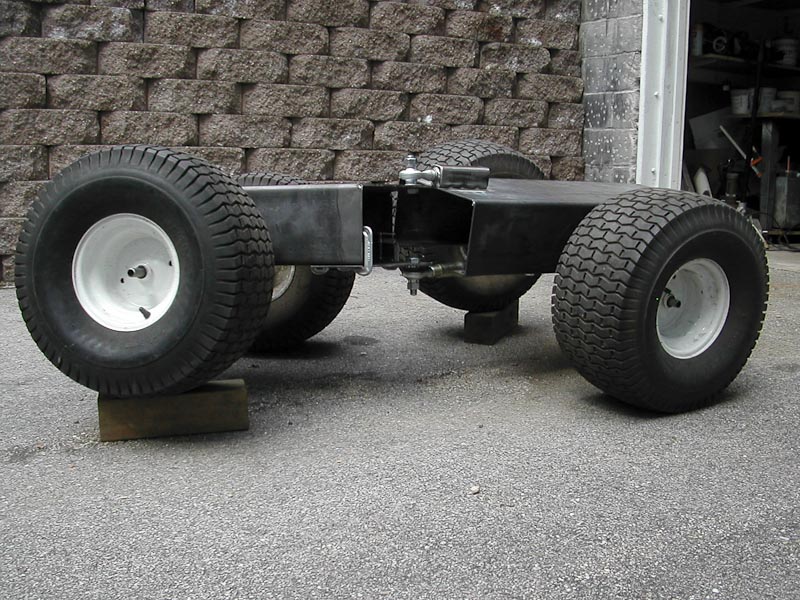

I used cat 1 toplinks and cut them down as needed. I did this so it can have the jackshaft for the pulley drive system line up with the pivot centerline so the belt tension will stay consistent throughout the joint movement. My setup here allows for about 7" obstacles under opposite corner tires and the belts stay tight and don't throw off the pulleys.
Ventrac uses a system similar to this for its articulation and oscillation for both 3000 and 4000 series tractors.
You could do a similar setup which would spread out the forces exerted on the joint.
