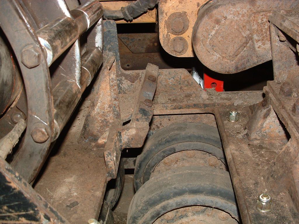

Try looking just in front of each sprocket on the top of the undercarriage frame toward the inside close to the machine. You should see a bracket welded in there that looks like a saddle with two bolts holes on each side to mount the brake cylinder. Mine has one of these brackets on both sides but only a brake cylinder on one side. So I guess if you haven't missed the brake then it must not be too necessary. Do you ever trailer you machine? That is where I would think being able to lock up the sprockets would be good. I might just make a solid sprocket locking device that bolts into the same spot and can be manually moved to engage the sprocket when needed. That way I can lock the sprockets when I want to.

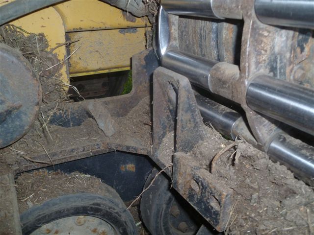

I noticed that the brackets holding the Park brake on my machine was torched off on one side completely and partly on the other.
Cant find no plugged ports though ?.
I was lucky to go back to the PO and obtain a partsmachine after i had bought mine.
It has 2 complete sets of good axles and wheels, so i'll be good for a while ;).
Tracks where gone though.

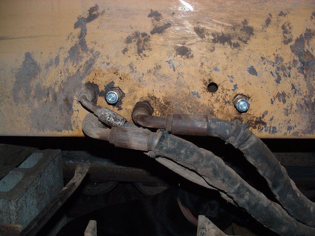

I was at the dealer the other day and inquired about the plugs I would need to plug up the hydraulic lines to the brake. They did not know what size plugs to sell me so we went out and looked at a used 4500 machine they had on the lot. To my surprise it did not have ports on the side of the machine like mine does. The motor drive hoses and the brake hoses were routed into the machine via an opening in the frame down inside of the track. My machine does not have an opening like that but rather all the hydraulic lines exiting from inside the machine frame are accomplised via bulkhead fittings fastened into the side plate of the machine. So on each side there are five bulkhead fittings, three for the hydraulic motors and two for the brake. So they showed me the different sized JIC plug fittings and I bought the ones that looked the right size, they were #8 size and they fit perfectly. Does your machine have the hoses running into the frame via some kind of opening like the 4500 I saw? If so those hoses must have been removed from somewhere inside the machine frame and capped off in there.
I have a question regarding the hydraulic lines to the drive motors. There are three lines. From the schematic it looks as though the two large lines are pressure lines, probably one for forward and one for reverse rotation. The third line is called the "case" line. Do you know what that line does? I'm thinking that the two large lines act as pressure and return to tank alternately depending on whether you are going in forward or reverse. If so, what is the smaller third line. Is it just case drain back to tank for any internal leakage in the motor? Does it have much pressure in it?

The parts machine i negotiated that thing in when i found out the machine i bought had a bunch of dry(no oil) axles and bad brgs,when i had been asured that the machine was 100% "gone trough" ,Okayed and field ready.
Lying A-hole:mad:
Dumb F i was,i wanted to gave the thing back instead,but he wouldn't take it,and i wasn't interested in going to court.
As usual pics are worth a 1000 words.
Drivemotor hoses(yes i'm pretty sure the small hose is just a case drain/press relief line.
Both sides of the brake supports(one cut off)(looked for but can't find plugged ports.
In the cab there a parkbrake switch(wonder if mine was equiped with electr park brake.(nothing to be found on the parts machine either but the switch)

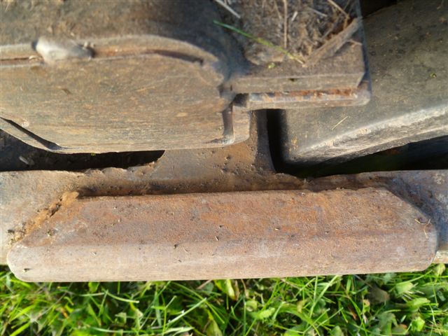

Repair patch (3/8" plate) on front track frame,i did this on all 4 rails

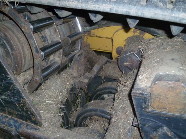

Your first pic looks like the right side showing the motor hoses. Looks just like mine (see pic) exept I have two more bulkhead fittings sticking out of the side wall for the brake. My pic shows the left side and you can see that silver colored caps I installed on the fittings. The right side is identical except only one bulkhead fitting for the brake (pressure hookup). The return line fitting is missing on the rights side but there is a hole in the machine where it would be if you needed one on that side. My second pic shows the brake mounting saddle that you are showing as torched off on your machine. Looks like you have the entire brake saddle on the rights side. Your sprockets look in really good shape too. Regarding the parking brake switch. What that switch is for is to override the automatic safety switches that engage the brake and allows you do manually engage the brake even if you are still in the seat and the machine is running. My manual says it activates an optional solenoid that engages the brake (i.e. cuts pressure to the brake). I forgot about that switch, my machine has one too. Obviously if I remove the brake I'll never use the switch.
Regading your track rail repair. Looks good but it's not where I imagined. I thought the cracks would be in the inside corner radius of the cross beam going from outer frame to inner frame. It looks like this repair was to fix cracks in the bend radius of the frame. Correct? I wouldn't expect a failure there.

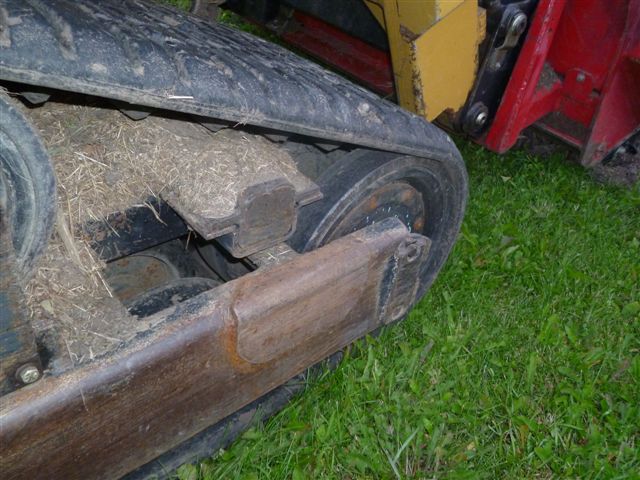

Here an other angle of the frame repair.
Frame was cracked from the inside corners of the crossbrace right behind the frnt wheel and extended trough the round corner halfways down the side.
Its hard to try to strenghten the frame on the inside without taking the whole frame off the machine and turning it over. I felt by thorouhgly rewelding the cracked aea on both in and outside and putting a patch over the re-weld it would stiffen the frame so it won't crack ever again.
I did this on both frames in and outside.
