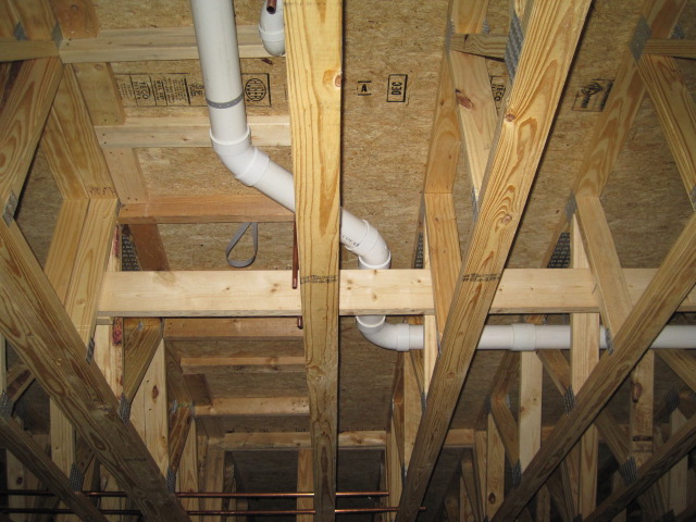

This drain line was placed where the basement fireplace flue will run. The 90 degree elbow is right where the flue needs to go.
attachment.php
The plumber rerouted the pipe to miss the flue. He first tried to use two 45 degree turns but couldn't make it fit through the trusses. So we ended up with this.

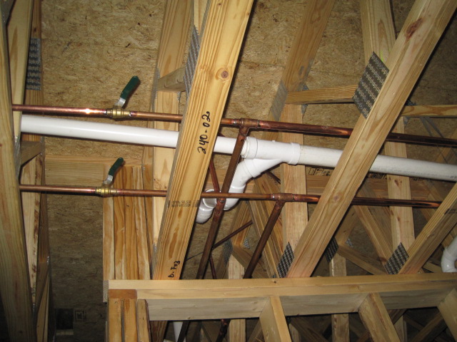

These inline ball valves will cut off all the water to the kitchen. We will also have cut off valves on the supply lines to the hall bath and have cut off valves on the supply lines to the master bath. In addition, we will have cut off valves for the laundry sink and for the washing machine. The goal is to be able to work on plumbing in any area without having to turn off water to the entire house. Thus, if we get a leaky shower fixture, we can turn off water to that bathroom and still have water for the other bath, the kitchen, and the laundry. Then fixing the leak would not be an emergency.
attachment.php
Our main supply lines that run almost the length of the house are 3/4" copper.

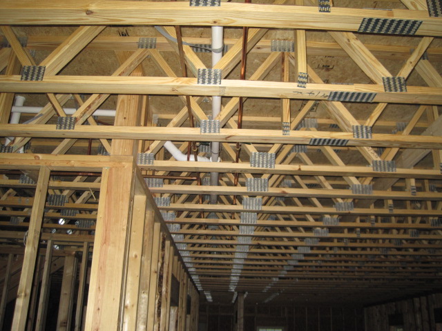

We are trying very hard to get all the plumbing and H&A ducts to be run inside the 24" high floor trusses. We would rather not have to lower the basement ceiling if possible. The bottom of the trusses are 9' above the basement floor. We have room to lower the basement ceiling if needed and could still have an 8' ceiling but are trying to avoid doing so if possible.
The H&A guy and the plumber know each other. They seem to be working well together to try to route the plumbing and H&A ductwork in ways that won't interfere with each other. Today the plumber lowered the drain line shown here because the H&A guy asked him to do so to make room for a H&A trunk line.
When interviewing the potential H&A subs, some of them didn't give us much confidence that they would do their best to keep the ductwork inside the trusses. They did not get the job.
