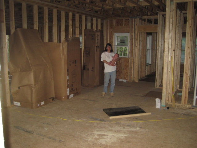

Today the wife put boxes in the kitchen to simulate the kitchen layout to help her make sure the cabinets and layout will be something she will like.
The first box on the left is where a pantry will go. The box to the right of the pantry is where the refrigerator will go. The box to the right of the fridge will be a cabinet that contains an oven and a microwave. The stovetop will go where the cardboard is sitting on the floor to the right of the wife and baby. The felt on the floor is where the sink and bar will go.

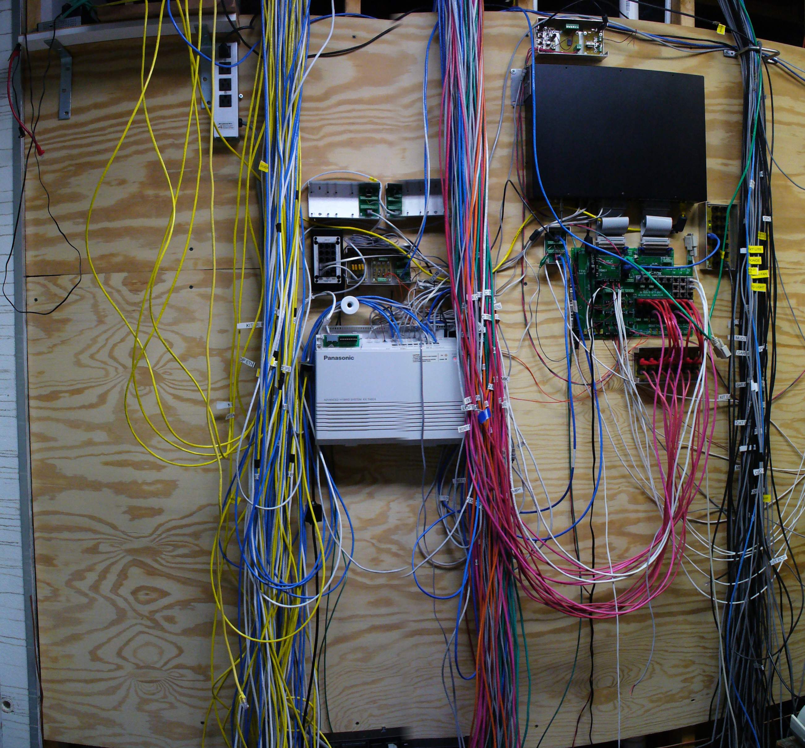

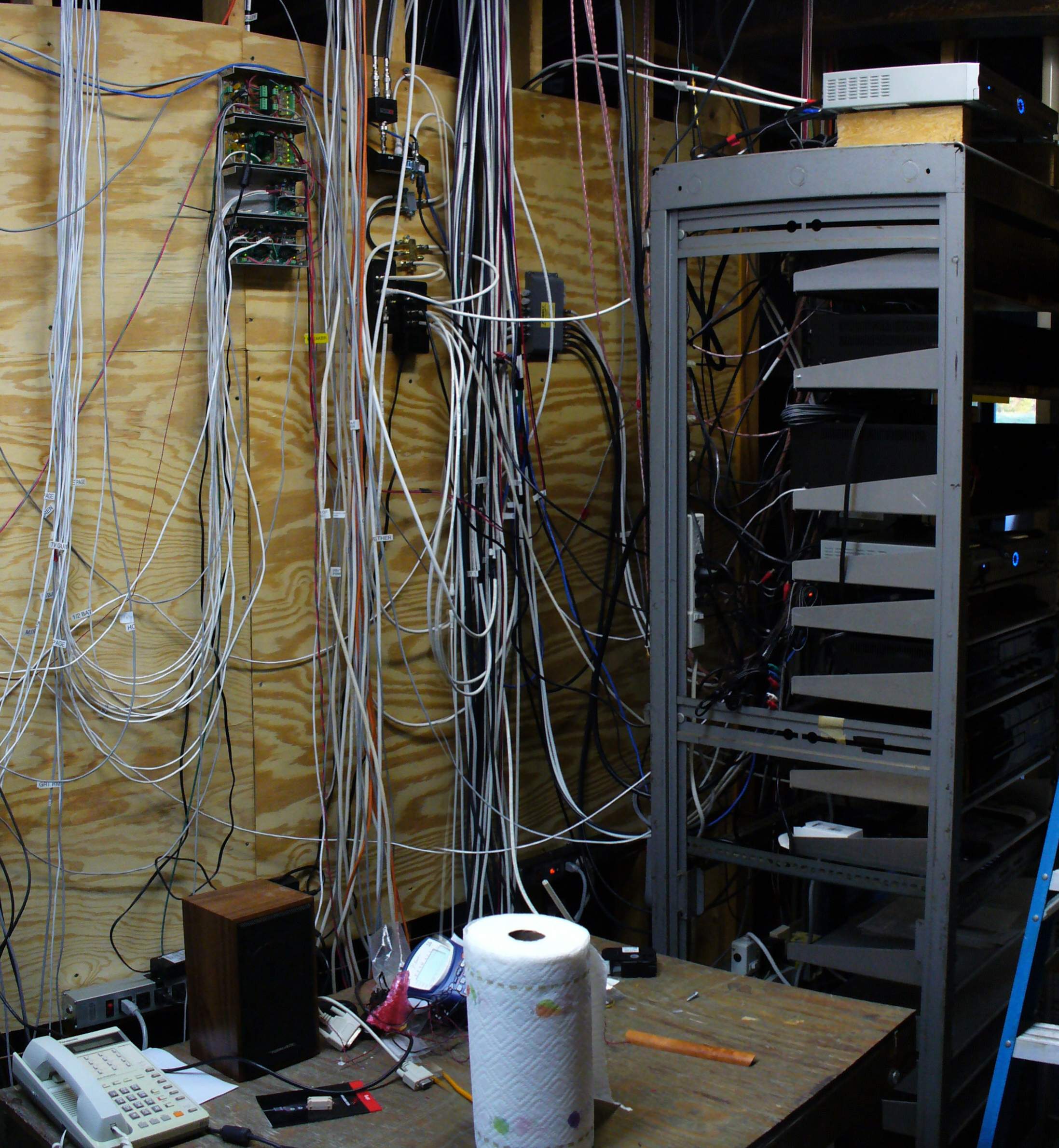

Enclosed are pictures that show that I know about going nuts with wiring, and have thought about security when you have cats.
In our previous house, I wired every window. It was very time consuming and nerve racking when drilling the holes for the plungers. The current house has Anderson windows, and it looked even harder to work them. So I tried a different approach. I have all my interior doors wired with magnetic sensors, the plunger type you can't see. You you don't need to do all, but here's the thinking. I'm more concerned with someone breaking in when I'm gone than the whole place going nuts if someone breaks in while I'm there. So think about your house layout and a bad guy looking around. Are some some doors he'd have to open, like closet doors or doors to rooms you'd normally have closed? If so, then wire them. I also have all outside doors wired and the automation system announces when they open.

Use as many colors of cat5 as you can, you can order far more colors than the box store has. Label every wire as you pull it! When you plan all this, buy a few cans of different colored spray paint and hit where you'll put all these boxes. That way you can walk through the house and think about your design and you won't forget things when you doing the actual wiring.
I've left some advanced ideas out, but this post is too long as it is. Yell if you want more data or pictures.
