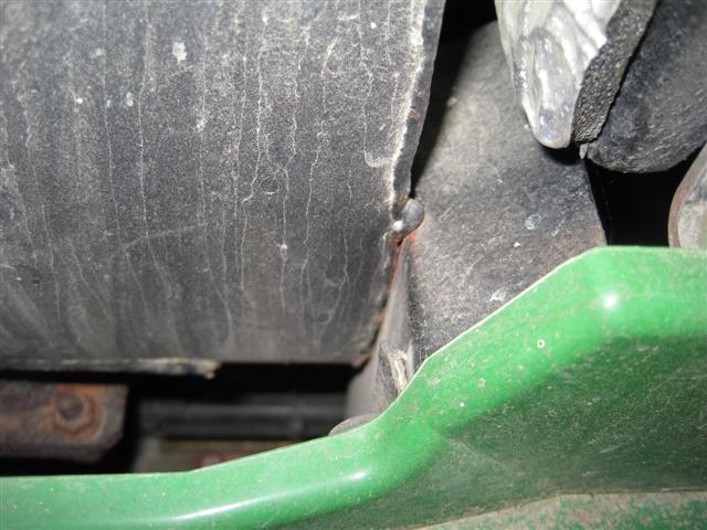

Dead Tractor Battery

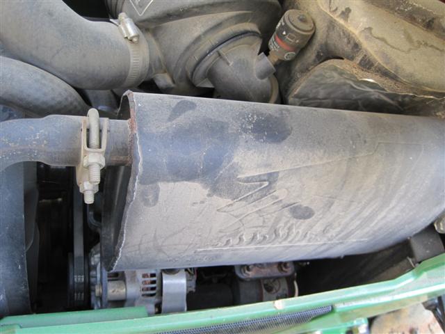

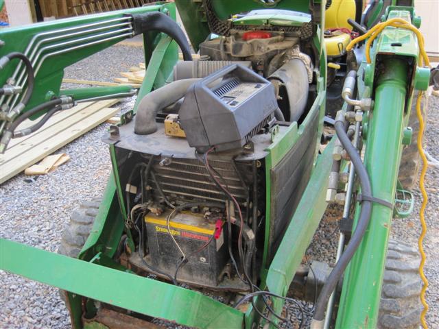

When I tried to start the tractor in order to pull the "visitors'" truck out of the mud on Saturday, the battery was dead. We had to jump start the tractor. After starting the tractor, the battery never charged even though the tractor ran over an hour.
attachment.php
This evening I put a battery charger on the battery to see if the battery will take a charge. I really hope it's just a bad battery and not a bad alternator.
attachment.php
Look where the alternator is. It appears that the muffler will have to be removed if we have to replace the alternator.
attachment.php
And check this out. The muffler is tack-welded to the frame! Yuk. If the alternator is bad, I'll have to take the tractor to the shop and get it replaced. Alternators should be easy to replace, even for amateurs like me.

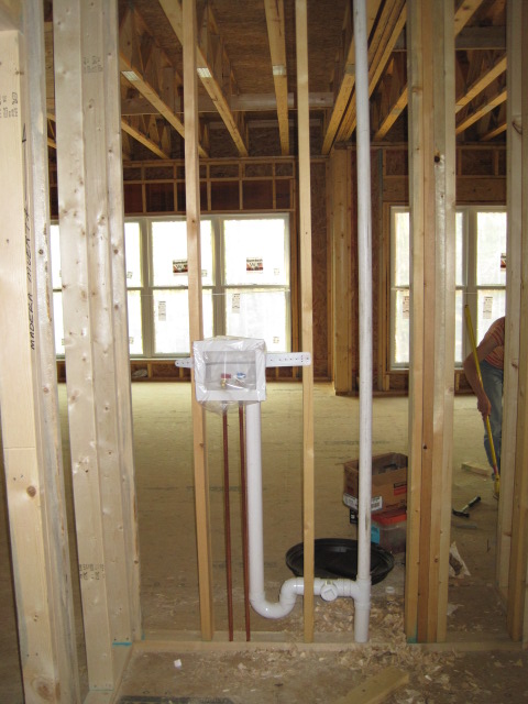

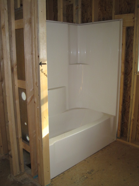

Plumbing installation has started this week.
attachment.php
Here's where the washer and dryer will go.
attachment.php
Here's where the laundry sink will be.

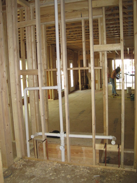

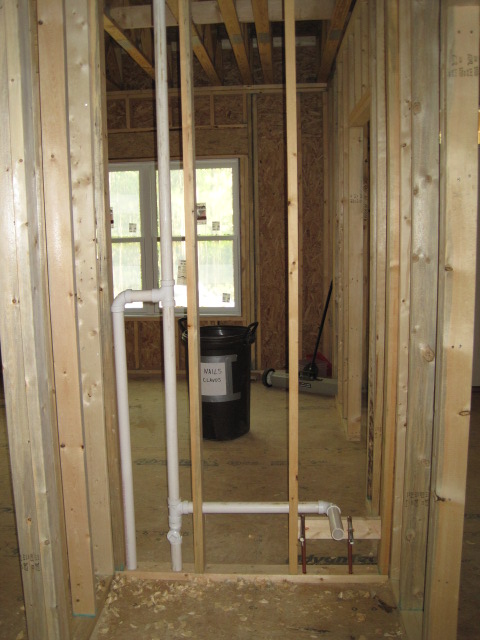

Hall Bath Plumbing
attachment.php
attachment.php

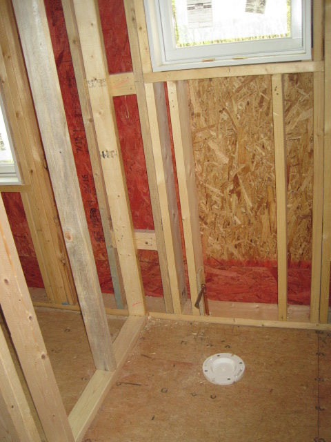

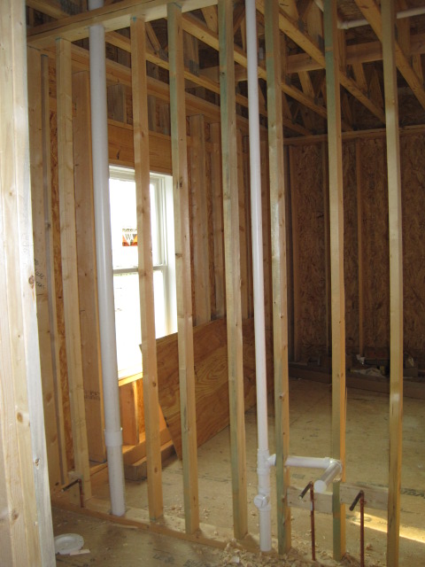

Master Bath Plumbing
attachment.php
Master vanity
attachment.php
Master toilet
attachment.php
Shower
And check this out. The muffler is tack-welded to the frame! Yuk. If the alternator is bad, I'll have to take the tractor to the shop and get it replaced. What a horrible design. Alternators should be easy to replace, even for amateurs like me.
If you have a volt meter, you can start the tractor and then remove one of the battery terminals and test across the terminals for voltage. This should tell you if the alternator is working or not.

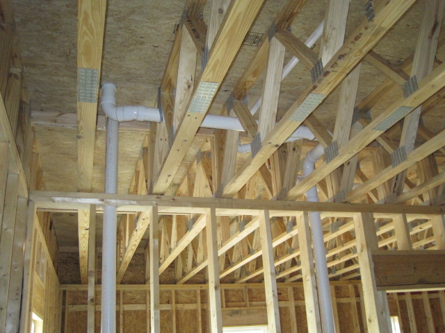

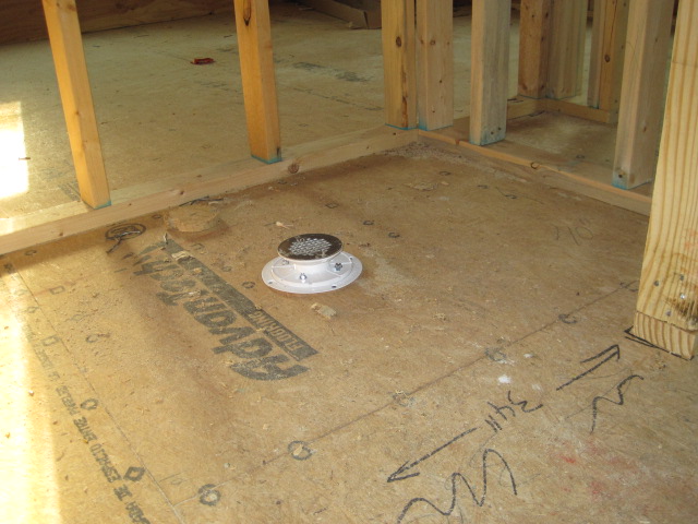

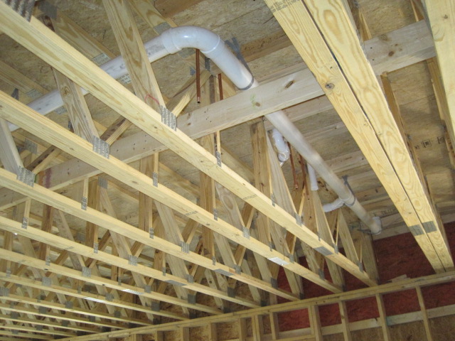

Plumbing Drains Under the Main Floor
attachment.php
attachment.php
The stack on the left in the picture is the radon vent. The stack on the right drains the hall bathroom.
attachment.php
I'm no expert by any means, but shouldn't there be a trap on that drain that comes through the floor for the bath/shower? Or is that the drain for the toilet (after thought)?

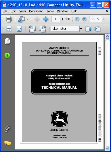

I just looked at the technical manual. The manual says to remove the side panel on the left side in order to access the alternator. That's good news.
attachment.php
If the charger is able to charge the battery, then I'm guessing the alternator is bad so I'll have to replace the alternator. If the battery charger won't charge the battery, then I'll replace the battery.
attachment.php
Don't rule out something simple like a loose or broken wire - it happens and causes some inconvenience.
Jim
