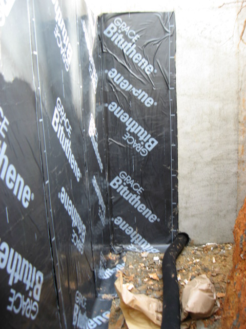

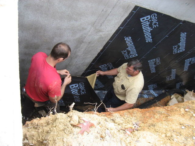

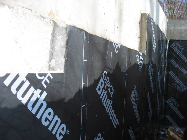

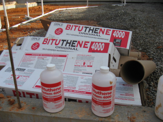

The walls are sealed with Bituthene. Drain tile wrapped in fabric is at the bottom of the gravel for drainage.

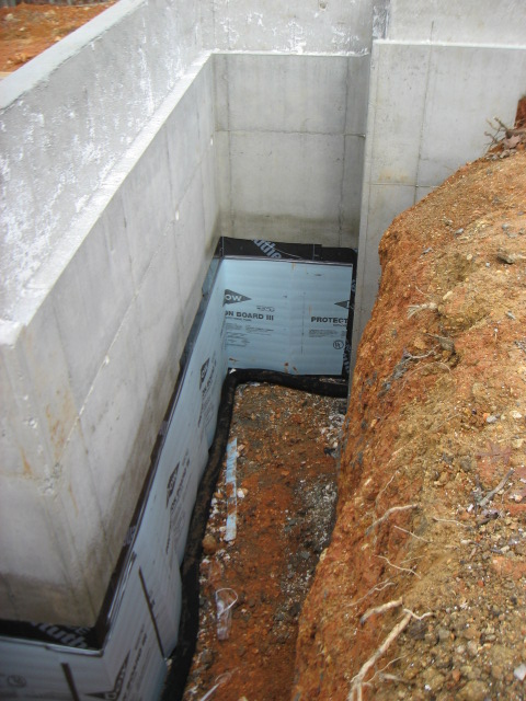

Here's the waterproofing for the basement walls. You can see the drain tile with the fabric sock over some of it.

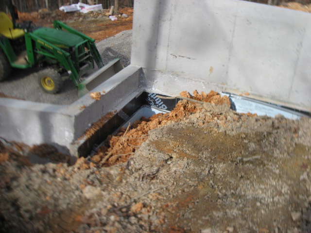

   / At Home In The Woods
#120

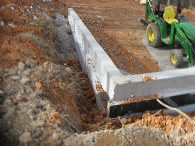

After installing the waterproofing, the walls were backfilled with 4 feet of gravel. The remaining depth was filled with dirt. We were told that we could backfill with 2 feet of gravel but we went with 4 feet as an extra precaution against leaks. The extra 2 feet cost $1000 in gravel.
