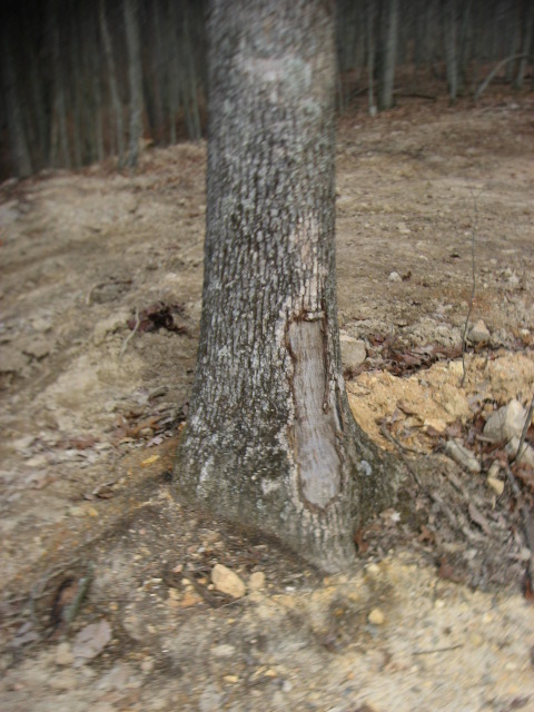

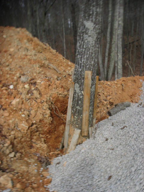

Here is a picture of what has happened to more of our trees than I like to think about. Before backfilling began, I nailed some scrap 2x4s to a couple trees in the path of the backfilling equipment in the hopes of preventing the bark from getting skinned off of them too. As soon as possible, I want to get the dirt off of the roots of the tree in the picture. We have a number of other trees with roots that have also been covered with dirt. We love the trees and don't want to lose them.

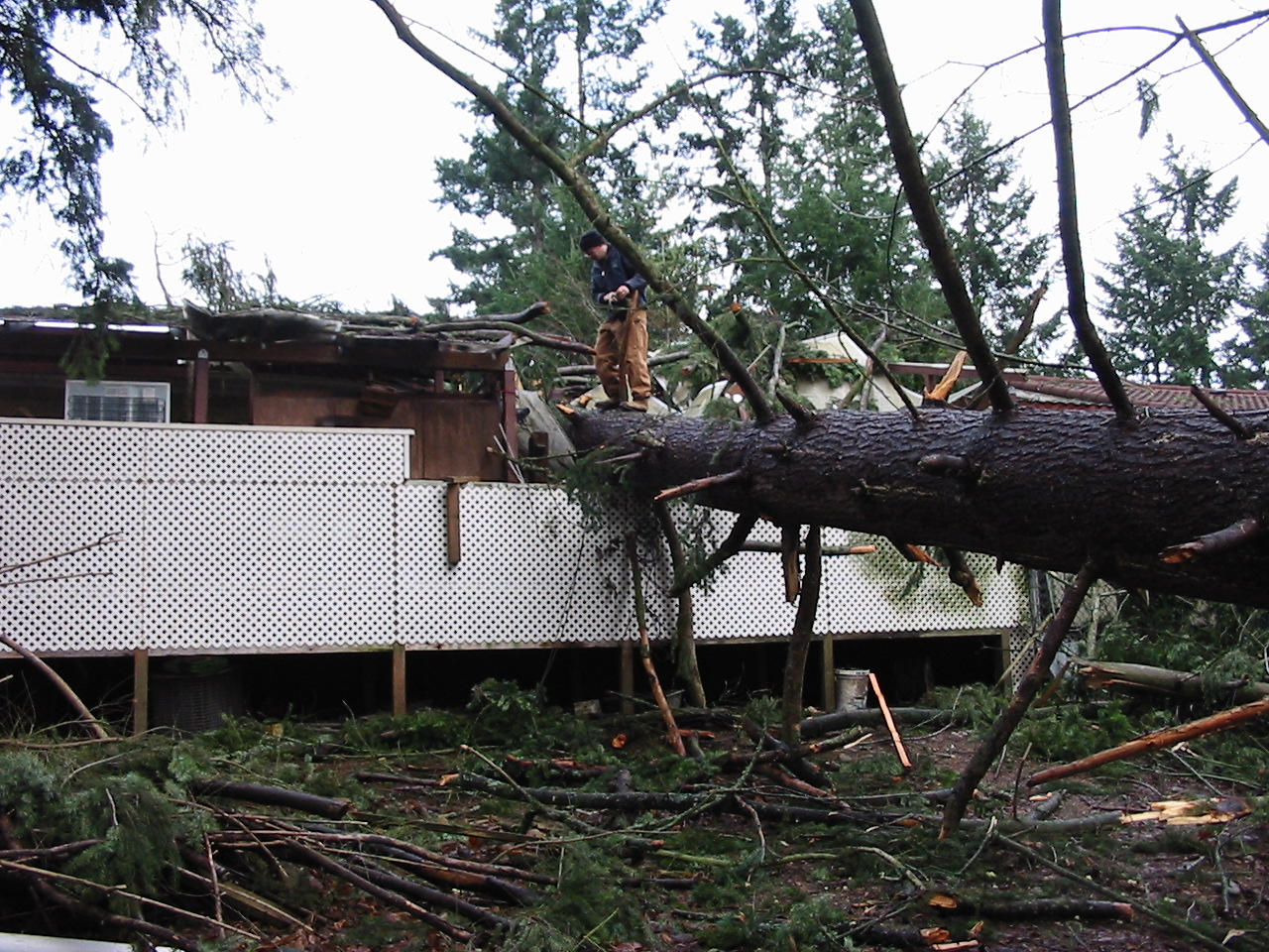

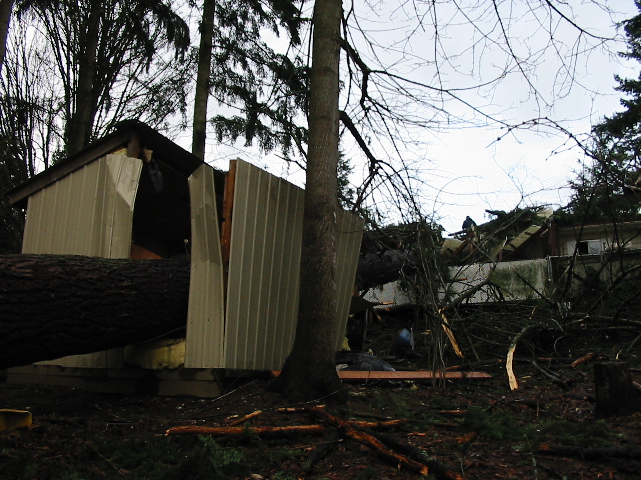

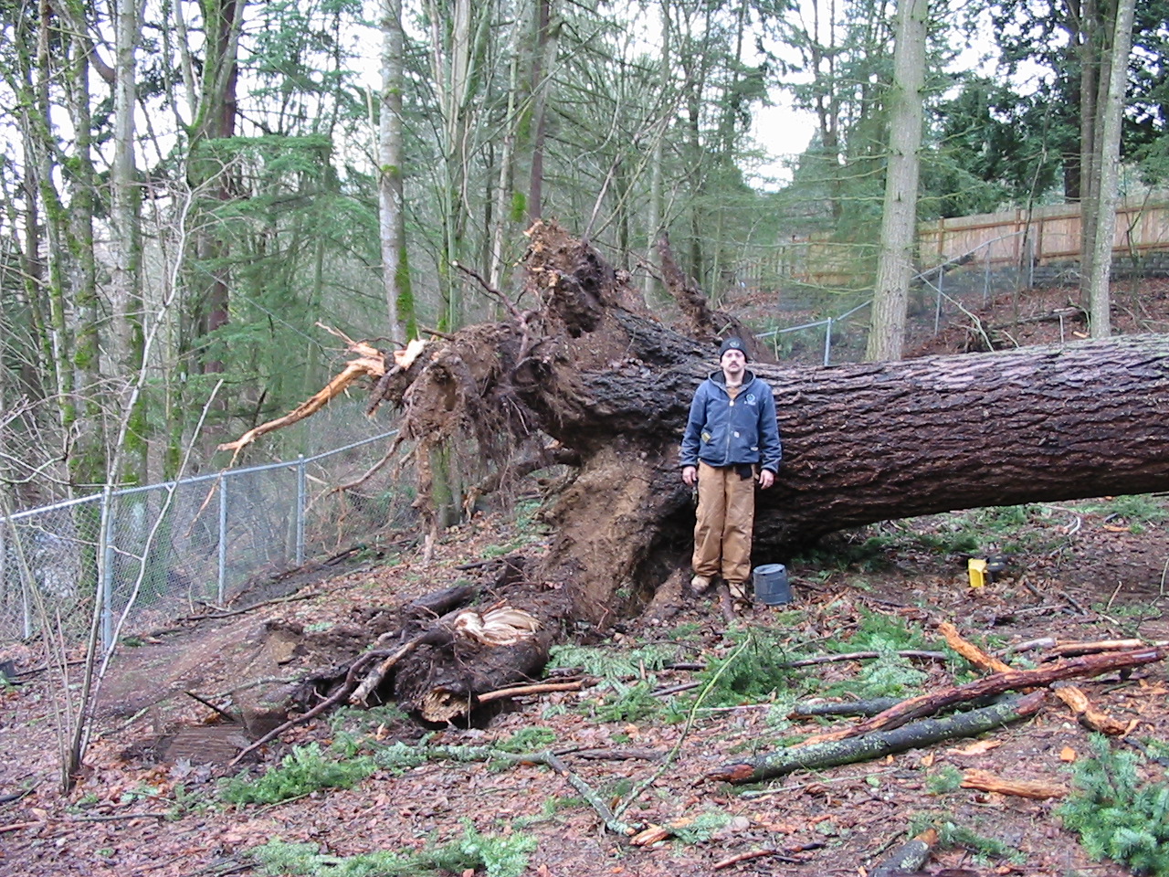

Sadly, here is a picture of what has happened to more of our trees than I like to think about. Before backfilling began, I nailed some scrap 2x4s to a couple trees in the path of the backfilling equipment in the hopes of preventing the bark from getting skinned off of them too. As soon as possible, I want to get the dirt off of the roots of the tree in the picture. We have a number of other trees with roots that have also been covered with dirt. We love the trees and don't want to lose them.
Trees are great, but if they start having problems - take them down. You can always replant.
Cyril, that's a huge tree. Did it hit your house?
