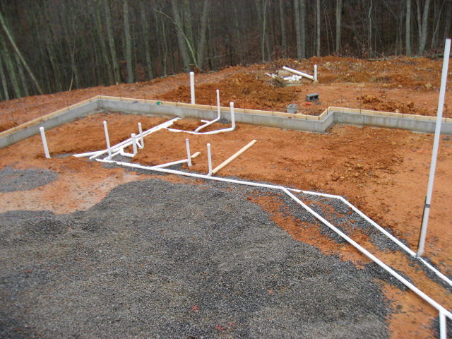

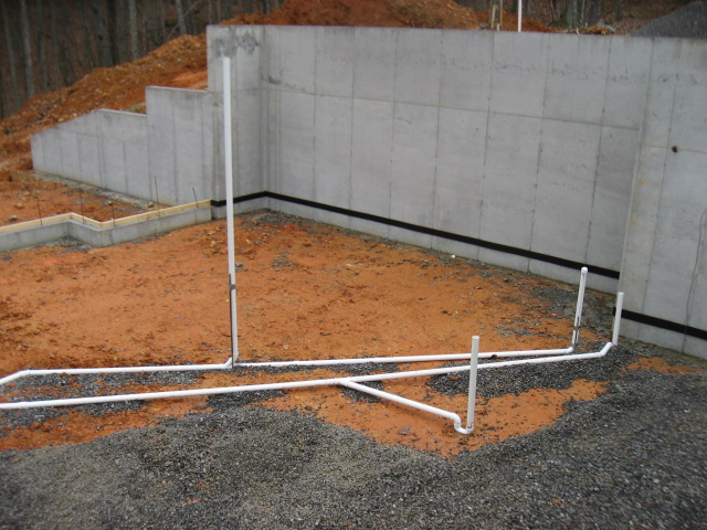

Plumbing drain test question The plumber and construction manager tested the basement drain lines by capping all the pipes except for the tall vent pipe. They poured water in the tall vent pipe to the top. They checked the levels and felt like the leak was fixed. An hour later, my wife checked the level of the water in the pipe, the level had dropped far enought that she couldn't feel the water with her hand. We don't know exactly how far the water level had dropped. The wife refilled the pipe. 45 minutes later the level had dropped another 3 inches.
The construction manager tells me that since there is air in the pipes that the water level in the pipe will drop as air gurgles out. Is the water level dropping like that normal? I want to know that the pipes do not leak. How can I be sure?
I think he is trying to get you to accept a small leak. I have tested many a line and have never heard that excuse. In my house, we capped the line just before the septic and filled the drain line with water. It held its level for a day and we called that leak-tight.
Tell him that if air is "gurgling out" slowly you want to wait for it all to come out and see a constant level for 24 hours. From what you describe, you will never see that and he will have to fix the pipes again...

The water level in the vent pipe dropped overnight. My wife went out and looked at the pipe this morning and could not see any water. I called the construction manager afterwards. I told him after the leak is fixed that I want an air pressure test done on the line and that I want to personally see the test performed.
   / At Home In The Woods #139
I think an air test is the way to go and pretty much the standard. You are on the right track with that approach.
Your waste lines seem to have a lot of pieces and partially parallel runs. In a stretch I could see where you might have some air pockets trapped, but an air leak down test will remove any doubt.

I agree with Dave, you have a leak and they are trying to convince you otherwise so they don't have to fix it. This is scary in two regards. One, they don't want to do what's right. Second, they are willing to do substandard work. This is where the General Contractor is worth his price. You are on top of it, and your decision to force an air test is valid. I wouldn't budge on this, and I wouldn't accept their word on doing it if you are not there. My concern is that even though you told them that you want to be there to see the test, they will do it when you are not there, with some lame excuse that it was the only time they could get the eqipment, or person to do it. You can do this yourself by gluing on some caps and air fittings.
I've only done air tests on gas lines. I've never had a water line or drain line fail a water test. I'm wondering why it's leaking. Did they prime the pipe before putting on the glue? The primer is mis named. It's not really a primer like most people think of primer for paint. It's really a two part chemical that softens the PVC before applying the glue. The glue isn't really a glue, but the second part of a chemical reaction. Once the primer has done it's job, the glue will actually melt, or weld, the PVC together. It is because of this, that the pipe can withstand the water pressure, and not leak. Done right, it's fool proof. Cut a corner, and it fails.
My Water Department will only allow purple primer and clear glue. They said that all the other colors of glue have failed on them. What color glue did they use?
If the air test fails, which it will, then fill it up again with water and add the air to it again. This should allow you, or them, to find the leak. Make sure they replace those parts and not try to patch it. You want brand new fittings in there.
