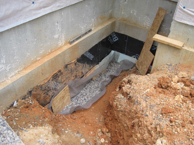

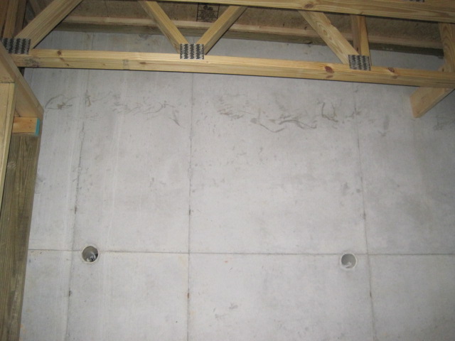

Today I worked on putting a drain tile below the spot where the electrical runs will go through the basement wall. You can see the two holes in the basement wall here.
attachment.php

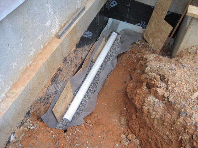

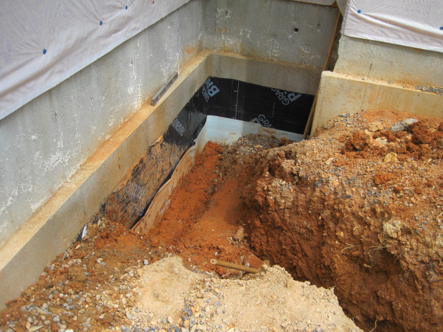

I dug down about a foot below the holes in the wall. Seven feet below this point at the footers there is another drain tile for the basement. I just want to make sure that water won't seep through the holes in the basement so that's why I'm installing another drain tile. The holes are covered by the Bituthene so you cannot see them. I put down some landscaping fabric and added some gravel. My internet search revealed that there are many different methods of installing drain tile. I chose to use this method.
attachment.php
I got this far when the rain stopped me. I capped off the pipe on both ends. On one end I primed and glued the cap. Yes, I use primer on drain pipes because I'm not a professional plumber. On the other end I put on a temporary cap. After the electrical lines are installed, I will fill in the trench so I can get to this area better with my tractor and will extend the drain tile.
