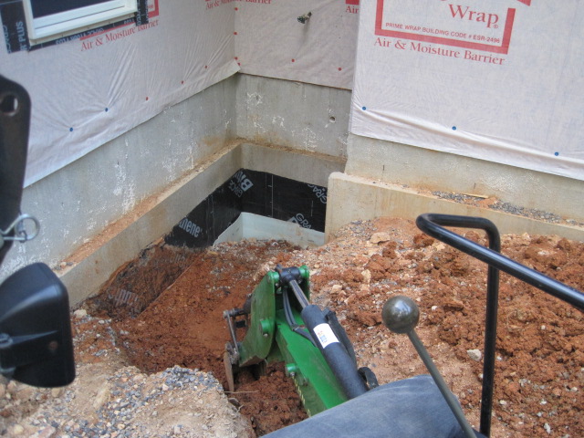

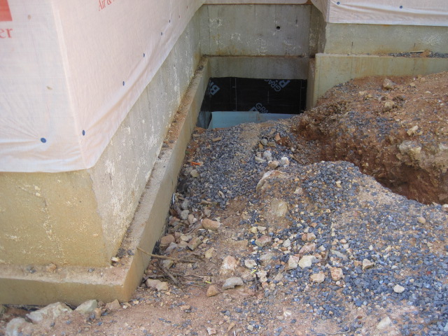

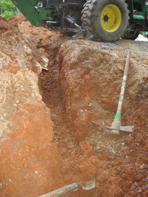

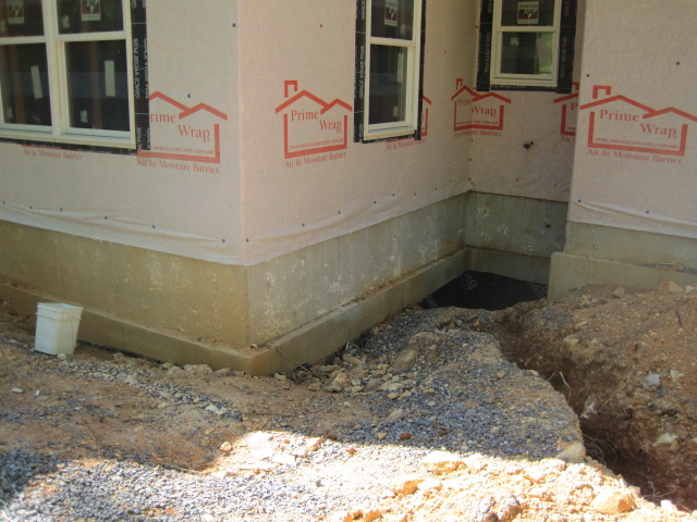

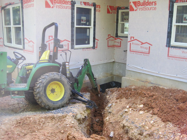

I dug some more this evening next to the house where the electrical will enter the house.
attachment.php
We will have two 200 A electrical runs entering here 4 feet apart. There are two holes behind the Bituthene 4 feet below the house sheathing. I didn't make things easy on myself by digging the trench a few weeks ago before digging next to the house. The trench made it very difficult for me to maneuver the tractor beside the house and also made it hard for the backhoe to reach the dirt pile.
attachment.php
I was able, with difficulty, able to position the tractor so I could reach most of the digging area. I seemed like I spent more time positioning the tractor than the time I spent digging. There was some hand digging required. It got dark when I was 95% finished. I have a little more hand digging I need to do up next to the concrete.

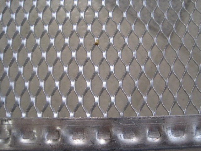

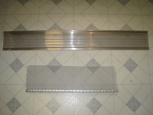

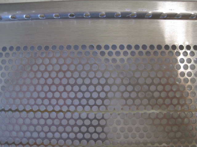

Gutter Guards
We don't know much at all about what are the best type of gutter guards for preventing leaves and other junk from clogging the gutters. With all the trees around our house, we will need really good gutter guards.
A gutter guy came by today.
attachment.php
Here are pictures of two gutter guards he can install. Here are close-ups (gutter guard 1 and gutter guard 2).
Can you tell me which guard would be better? Or do you have some other gutter guard suggestions?

The longer sample looks to be stainless steel which should last longer, but cost more. Not sure that using stainless would be much of a benefit for gutter guards.

Go with the gutter guard with the biggest holes. While both look to be pretty good, I've had some serious issues with those using smaller holes, and not as many. When the water comes down too fast to go through the gutter guards, it goes over and ends up inside of the soffits. I've had several clients with water damage inside of their sheetrock because of this.

Another suggestion. When you get gutters installed go with the larger or "commercial" size gutters and downspouts. I had them installed on my house and never had an issue. They handle a larger volume of water much easier.
Also if you plan to put underground drain lines in for the downspouts do not use the black plastic flexible tubing. With them small sticks and debris can get caught inside them and they dam up. Go with smooth white PVC type pipe, either schedule 20 or schedule 40, very little chance of stuff getting hung up inside them.
I agree on the size. I think ours are are like 4.5 by 2.25 but not sure. Much larger than the smaller size I was use to. It really help with the toad stranglers we get here in NW GA. On the guards, I have not used them but the gutter guards look good to me. We use something like the smaller one you show and I don't like their appearance much. Thy also like to catch pine needles which often fall as a two needle pairs and invariably fall into 2 separate holes.
