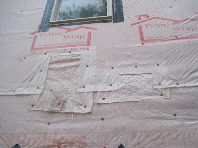

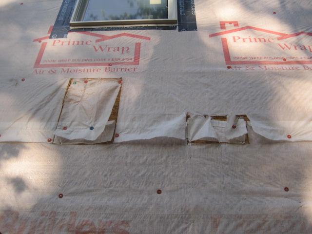

The HVAC guy had to cut through the house wrap and sheeting to install the solid H&A ductwork in the trusses. He patched his holes using the same sheathing and house wrap pieces that he cut out.
attachment.php
Unfortunately, these patches were not be very water tight. He made 4 holes. The picture shows 2 of the holes.
attachment.php
So this evening I got some scrap house wrap pieces from the scrap pile and patched the house wrap to make sure everything overlapped for water protection.

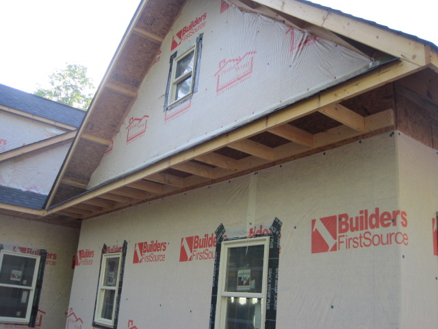

Eyebrow Question
attachment.php
Brick will be laid from the footer to the eyebrow shown here. After the brick is laid, the vinyl soffit will be installed under the eyebrow. The vinyl soffit will be attached to the brick using J-channel. One of the vinyl subs said the horizonal ledger board that attaches the bottom of the eyebrow to the wall will cause a problem. The other two vinyl subs said they don't anticipate a problem with the ledger board. We don't intend to have a frieze board or any trim below the eyebrow soffit as we think it would look bad on our house.
Do you guys see this setup as a problem? Will we end up with a gap between the brick and the eyebrow soffit? What's the solution.
Thanks in advance,
Obed

Obed I was looking at your picture where you patched the house wrap. Do you have any house wrap tape? You really should tape those seams. The house wrap not only keeps out the water it keeps air from infiltrating the house. The tighter you can make the envelope the better off you will be when the wind blows.
Rick
