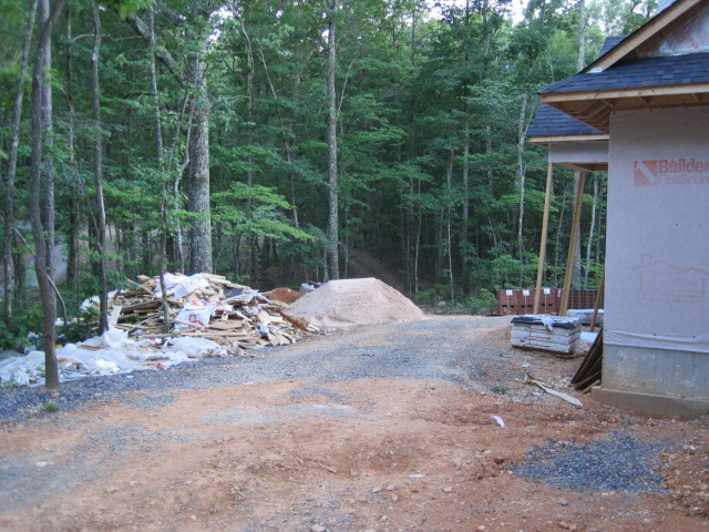

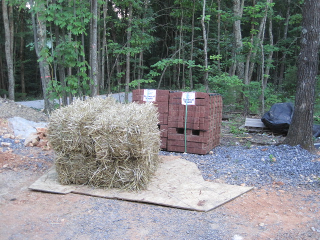

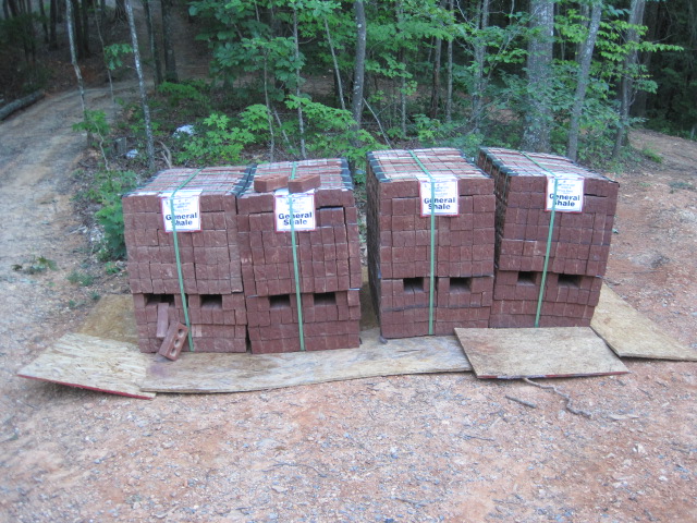

Brick materials including sand were delivered yesterday. We placed the brick pallets on scrap sheeting to protect them from being stained by the red clay. Brick work starts tomorrow.

Cover up that pile of sand with a tarp. When the masons leave cover it daily. You don't want the sand getting wet. I know it will get wet when they mix the mortar, but you want dry sand to mix with.
