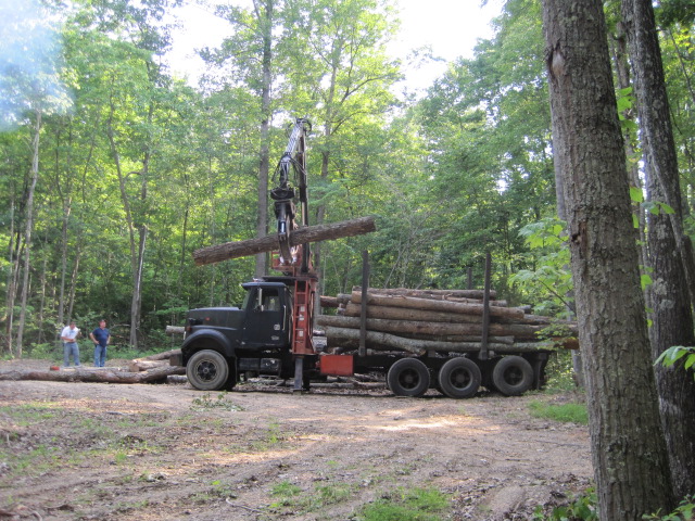

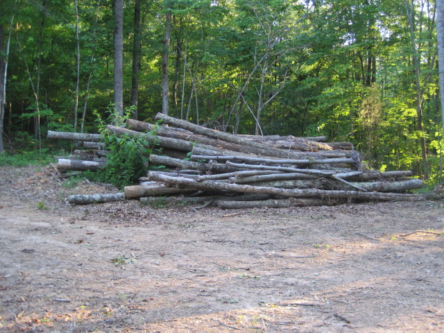

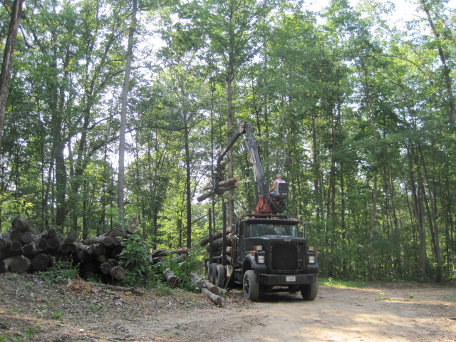

Tuesday the tree guys cleaned the rest of the hickory tree and took down this pine tree that was leaning against an oak tree. They started at the bottom of the pine tree and cut off 4 foot sections at a time. Each time they cut off a 4 foot log, the remaining section of the pine tree would fall 4 feet to the ground. Eventually the pine tree was almost standing straight up but was still leaning against the oak tree. The tree guy then pushed the pine tree over with his skid steer then cut it up will it was on the ground.
They loaded the large hickory logs and several of the logs lying here onto this logging truck. The remaining parts of the hickory were piled and burned.

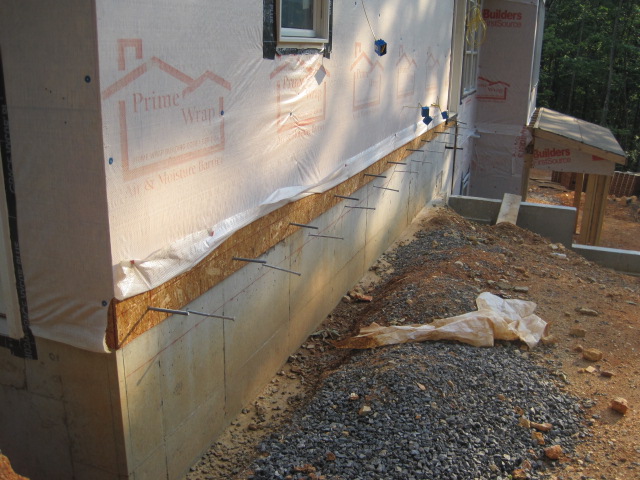

Here's where the back porch and deck will go. You can see the 2 rows of bolts that will attach the ledger board to which the the floor joists will be nailed. Two of the blue boxes hanging on wires will contain electrical outlets. I hung the third blue box; I will run at least two cat 5 or 6 wires to this box for computer network and/or phone. There is a similar setup on the front porch.

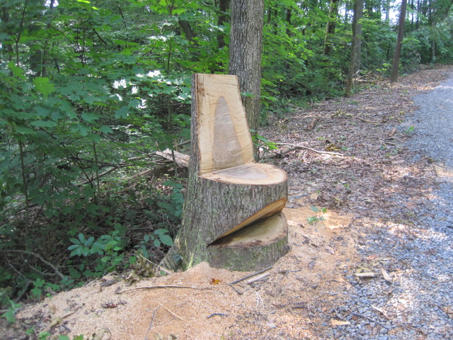

The tree guy made a chair out of the hickory stump.
attachment.php
The wedge cut out in the bottom is a foot rest.
