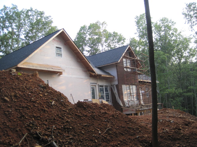

Here are the latest brick pictures. Some of the new brick is covered with plastic to protect it from the rain.

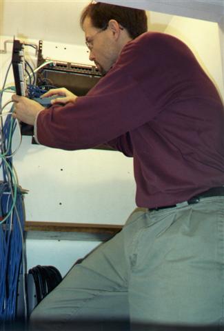

How are you going about terminating all the wires? Are you going to use an 'home structured media panel' or are you going with a 'backboard'? We have a structured media panel so all the wires just run inside the walls into the panel. Sits in the wall just like an electrical panel. One thing they did do that I really like was to stub out some low voltage conduit (flexible plastic stuff) from the panel to the attic and crawl space areas. This allowed me to easily additional cables when I needed them. I have a wireless internet provider and had to run CAT5 to the antenna location. Make sure you have some outlets there for hubs/wireless routers etc etc
I won't use a "home structured media panel"; I prefer to just make my own system using network patch panels and attach them to a piece of plywood mounted to the wall. I plan to terminate the wiring like I did in our last house. I'm assuming the home automation controller will also be attached to the plywood. All the Cat 6 wiring will be terminated at a patch panel. I can then run patch cords between the patch panel and the home automation controller where needed. The security wiring for the sensors and door contacts will most likely be terminated directly into the security controller panel.

   / At Home In The Woods #1,674
What we call a backboard then. You can run those D rings like you have in your pics, there are smaller sizes available, down to the floor. If you lace the cable neatly it looks pretty good. Here is what a properly laced cabling system should look like (random pic off the internet but shows what I mean)
Can also run plastic cable duct down to the floor: Wire Ducts, Wiring Duct, Cable Ducting, Cable Routing That stuff is pretty expensive and you don't get the covers unless you order a full case. I would have to look but I think I have had some 2x2 grey with covers laying around... might send it to you just to get rid of it ;)
BTW if you are really paranoid you can either buy fire resistant plywood for the backboard or paint regular plywood with fire resistant paint.
