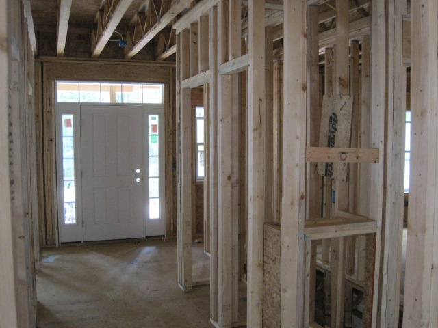

Today I put a second low voltage box in the MBR as an alternate location for phone/computer. I also re-ran the Cat 6 cables going to the front porch and the back porch because we changed the location of the network patch panel.
We finally decided on a location for the low voltage patch panel. In our foyer area, we have 2 closets right beside each other. I'm not really sure why the wife designed 2 closets in the foyer but that is coming in handy. One closet will be a coat closet. The other closet is partially filled with a H&A return duct. We are going to put the patch panel in this closet which I am calling the vacuum cleaner closet.
I was originally thinking I would put the patch panel in the office/DR closet or in the basement below that closet so the porch cables ran to that area instead. To re-run the wires, I had to totally re-run the back porch wires because the length of the cables would not have made it to the new network closet. The wire run for the front porch was a little easier to redo.
I'm still trying to figure out a good way to bring my Cat 6 cables from the floor and ceiling trusses into the network closet. You can see a hole in the back left corner of the closet that we have cut for running the wires through the floor. I may have 40+ wires coming through the floor. The wife doesn't like having an open hole in our floor. The electrician suggested enclosing the hole in the floor with a "boot" used to run a vent pipe through a roof. I'm just trying to figure out how to prep this area before drywall and sheetrook.
If any of you guys could post some pictures of your security panels and Cat5/6 network panels, I'd appreciate seeing them to get some ideas.
I have renamed the closet from "vacuum cleaner closet" to "network closet". You see, as soon as the wife suggested we put the patch panel in this closet instead of the DR closet, this closet became MINE; the wife just doesn't know it yet. Yes, I will have to share this closet with the vacuum cleaner. But calling it the "network closet" makes it sound like mine.

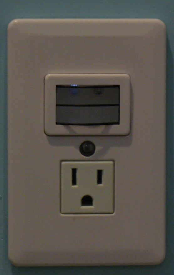

Here are some pictures of the night lights that go into standard single gang boxes. Having the in the hall might be good for using the vacuum cleaner- no worry about where furniture is in the room. These are LED lights, so hopefully they will have decent life to them. I got them at Lowes. They turn off it it's bright enough, but some of our have been on all the time since they are in low light areas.
We put two out in the hall (opposite sides) that goes from the MBR to Master Bath. Master bath has two, the one you see in the photo and another.

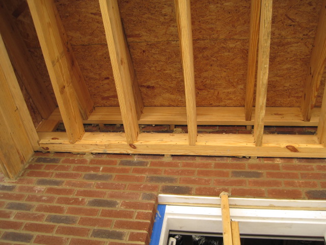

Brick work looks real good! Hey i'm curoius about how the brick was laid behind the porch roof. Would love to see a couple of pictures, if you have a chance.
Thanks Rick

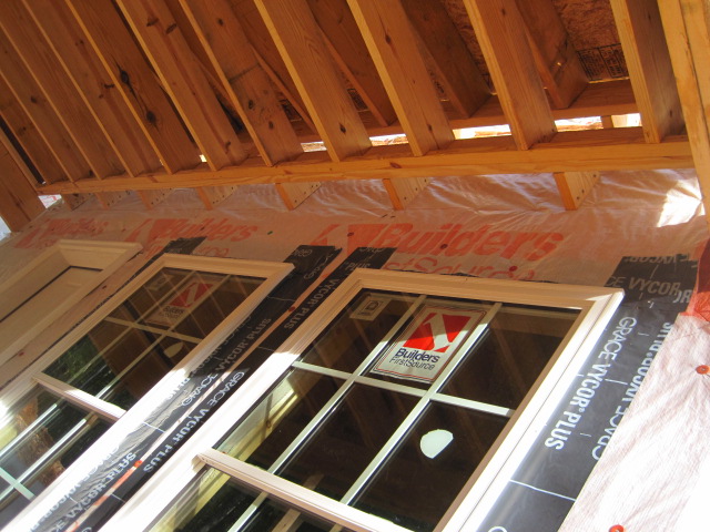

We had lots of discussions with many people about how to connect the basement back porch to the house and negotiate the brick. Here's how we did it.
We put ledger boards about 6" from the framed walls, with spacers between the ledger board and the wall. The brick guy just put brick behind existing ledger boards and around the spacer boards.

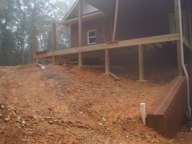

Friday we found out we were missing 3 long steel lintels that support the brick over the living room quad-windows and over the main floor garage doors. Although we had ordered the lintels, they were not part of the original brick delivery because the lintels were out of stock. The undelivered lintels fell through the cracks; the brick supply company forgot about them and we had not done a good inventory when the brick supplies were delivered. Lesson learned. Unfortunately, we can't get the lintels delivered until Thursday.
So the brick workers started working on retaining walls today. My wife went out to make sure that they use brick ties to tie the bricks to the poured concrete retaining wall. They normally use ties about every 7 or 8 courses of brick and were almost to the point where the first ties would be needed. So my wife just stood around and waited to watch them attach the ties to the concrete wall. Well, they couldn't drive the nails into the wall. The nails would bend or the concrete wall would just chip. So they tried to see if my wife would let them brick the retaining wall with out ties since that wall is only 6 feet tall. When the wife called me to ask, I told her that we wanted brick ties and that the brick workers needed to figure out how to attach the ties to the wall. The brick mason was not there but he has a nail gun that can shoot the nails into the wall. So the brick work stopped and will have to resume tomorrow when they have the nail gun. My wife strongly suspects that if she hadn't gone out there, that they would have bricked the retaining wall without using any brick ties.
