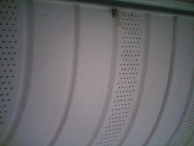

My wife has been researching attic ventilation needed for our house for cooling efficiency, prevention of ice dams on the roof, and for moisture prevention. According to her calculations, the vinyl soffits that all the vinyl subs normally use would not provide adequate ventilation. If that is the case, then almost no house being built in our area meets the ventilation requirements based on the fact that our soffits are 2 feet wide which is at least double the width (and therefore potentially double the ventilation) than most of the houses that are being built. We needed double the ventilation than what the vinyl installers would provide by default.
The vinyl subs who gave us estimates were recommending that 1 out of every 3 vinyl soffits be a vented soffit (i.e. has holes in it for air movement). However, we need at least 2 soffits out of every 3 to be vented to meet the ventilation requirements put out by The Home Ventilation Institute. However, if 2 out of every 3 vinyl soffits is vented, we may have issues with sagging since our soffit area is 2 feet wide. The vented soffits are not as stiff as the non-vented soffits and are thus more prone to sagging. One of the vinyl subs is getting us a quote on how much he will charge to add 1x3 blocking along our eaves in order to support the soffits and prevent sagging.
There is a part of me that wonders how important it is that we meet the attic ventilation requirements put out by HVI since most of the homes in our area only have 1/4 of the ventilation that HVI recommends.
Are they using perforated vinyl soffit? The soffit we use has 3 sections with the center being perforated. I do not see how it would be structurally weaker. The soffit is placed pependicular to the house. I also am not sure if this meets the "hvi" flow requirements. This is used everywhere but the gable ends. Sorry for the picture quality, it looks like it the soffit is sagging but it isn't. This picture is from a 2' overhang that is about 7 years old.

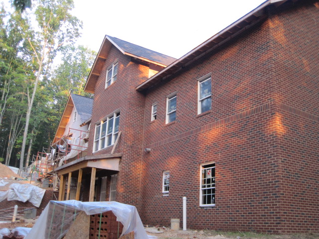

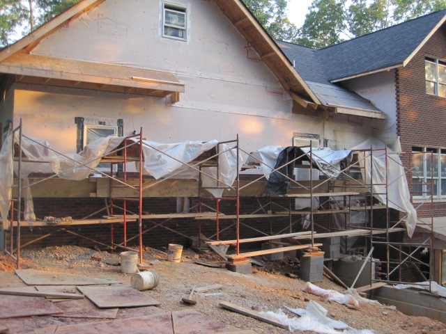

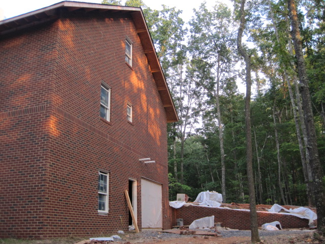

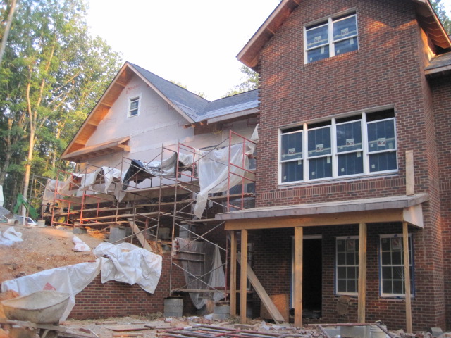

More brick pictures.
Based on the picture of your soffit, it appears to be installed the standard way they are installed here. 1 out of every 3 soffit pieces has holes in it (i.e. ventilated). My wife called one of the manufacturers and was told that the ventilated piece is not as sturdy/stiff as the the non-ventilated piece. To get the HVI recommend ventilation, we would need 2 out of every 3 pieces to be ventilated.

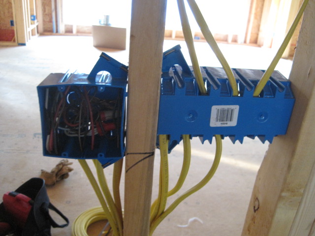

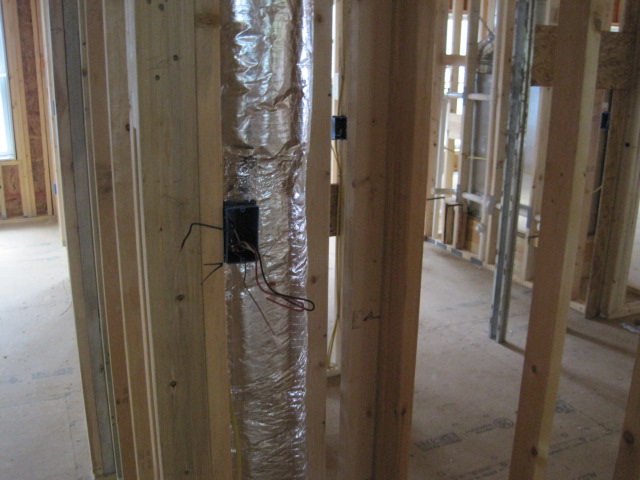

Hall Night Light

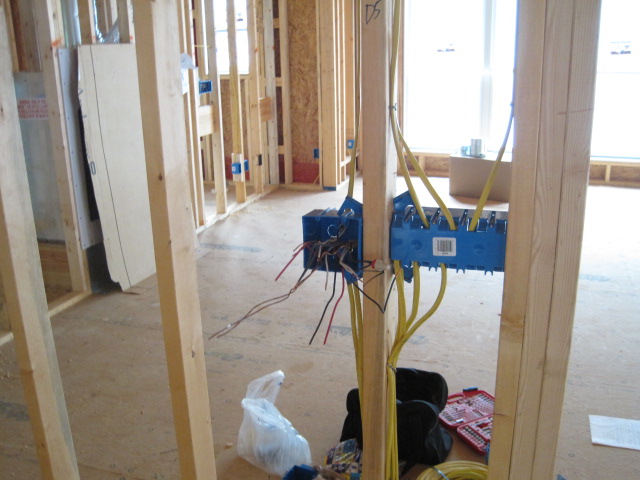

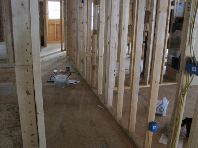

Thanks to the great input provided by TBNers, I decided on the hall night light design. This weekend and yesterday evening we worked on roughing in wiring for a night light in the hallway. I may use a night light similar to what eepete suggested. Since I want to be able to turn the light off, I decided to put 3-way switches on each end of the hallway so we can turn the night light on or off just like a regular hallway light. If we have guests, we can leave the night light on at night.
At one end of the hallway, we had a single gang box for the hall light 3-way switch. We replaced the box with a double gang box that will house 3-way switches for the hall light and the hall night light. At the other end of the hall, we had a double gang box for the other hall light 3-way switch and the foyer light switch. We moved the foyer switch to its own single gang box and roughed in the wire for the hall night light 3-way switch.
We also installed a single gang box in the middle of the hallway to house the night light. Above the night light box is a single gang box for the whole house fan. We replaced that box with a double gang box that will hold 2 switches for the fan. We also moved the fan switch box up extra high on the wall so that someone doesn't accidently turn on the whole house fan when intending to turn on the hall light.
While it doesn't seem like much, I ate up several hours reworking/rerunning the existing wiring and re-wiring the boxes plus adding two boxes. However, I believe I will really like having the hall night light on switches. I also want to add a switch in the night light that will be located in the master bath. It'll be nice to be able to go in the bathroom without having to fumble around in the dark or be blinded by a bright light.
Just to clarify a little, that is actually one 12" wide section cut from a longer piece with 2 solid sections and 1 ventilated section. I am curious to the sturdy/stiff comment as the strength seems to come from the ribbed area between the solid and ventilated and the lips that overlap with the next piece. I do know that from installing it that the last piece without lip on the end will sag if not properly supported by facia. Has she checked into metal alternatives?
