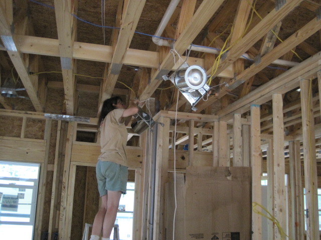

The wife decided that she didn't like where the can lights were located in the kitchen so we started moving two of them this evening. She also wants one more can light installed directly above the sink and wants a switch that turns only that light on/off. Near the sink, there is a 3 gang electrical box that was roughed in for an electrical outlet and two light switches. I re-routed the outlet to its own single gang box to make room for the wife's sink light switch in the 3 gang box. We are not finished moving and wiring the lights. I surprises me how long it takes to do such small tasks. I don't really have a problem hiring the electrician to make some of these changes but he has not shown much interest in coming out to do these small things. I don't mind doing electrical work. I just wish I had more time. Don't we all?

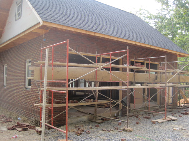

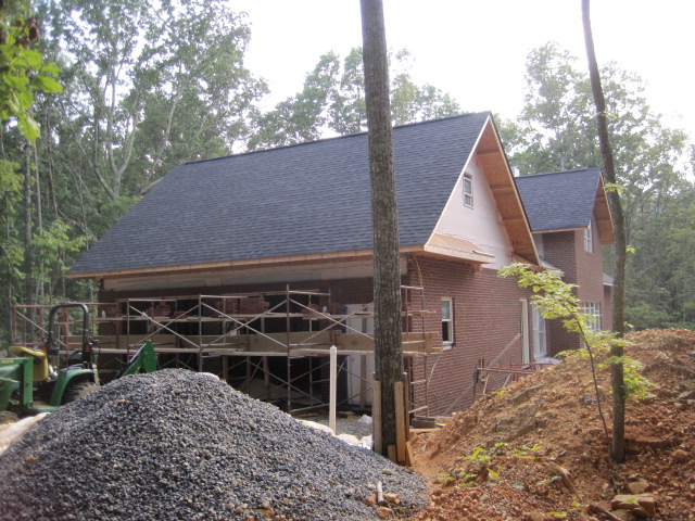

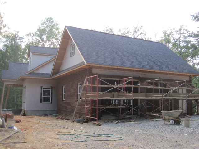

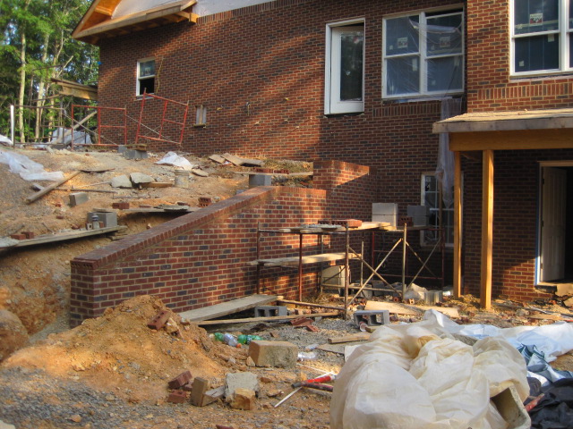

The brick work is almost done. There are a few windows and doors that need roll lock installed. The last brick on the ends of each of the retaining walls need to be laid. Our brick supplier does not have any solid bricks for our type of brick so the workers will have to cut bricks at the top ends of the retaining walls to cover the brick holes at the end. If you look closely at the top row of brick on the end of the retaining walls, you can see bricks loosely sitting on their sides and see the the open holes. You might need to zoom in on the picture.
Tomorrow the brick workers will lay the block for the front porch. We are being very involved in the making sure the block for the front porch is laid in a way that will satisfy us. There will be rebar tying the block to the house foundation. I'm not certain we would have gotten rebar if we hadn't specified we wanted it.
I've instructed the wife to not pay the mason the last check until the property is cleaned up to her satisfaction. The property is a mess with all the wasted brick, etc. lying around.
