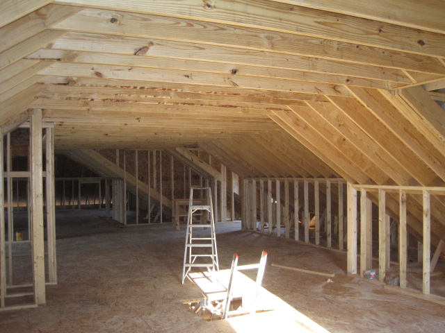

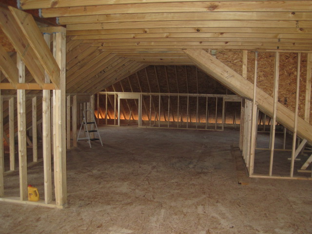

Vinyl work started today. I don't have any pictures yet. It started raining late this afternoon.

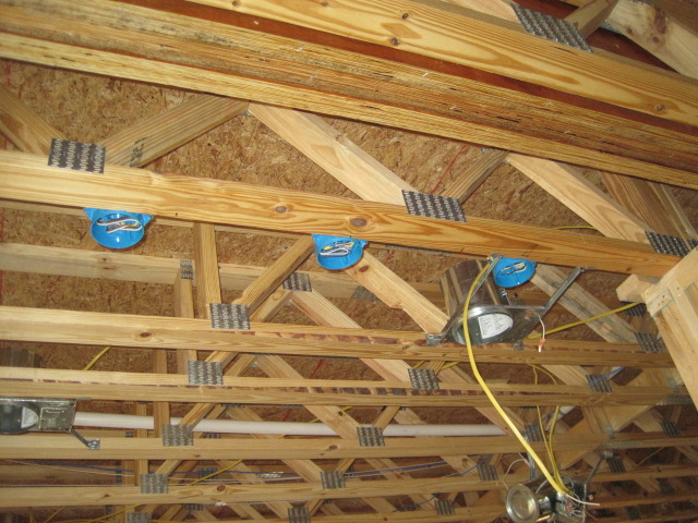

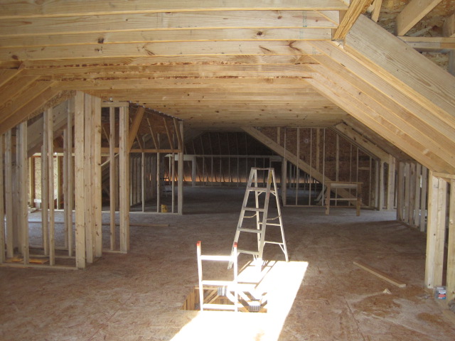

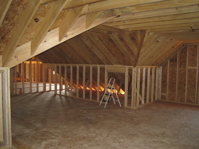

Getting an insulation company we liked was a struggle. We want to insulate the ceiling between the main floor and the attic. We have 18" high trusses between the main floor ceiling and the OSB that covers the attic floors. The trusses are at 19.2" O.C. Insulation companies were actually giving us quotes for laying 16" wide batting between the trusses. They were not going to put any insulation on top of the 2x4 bottom cord of the trusses. So for every 19.2" of ceiling we would only get 16" of insulation. Over 15% of our ceiling would not get insulated if we insulated it that way.

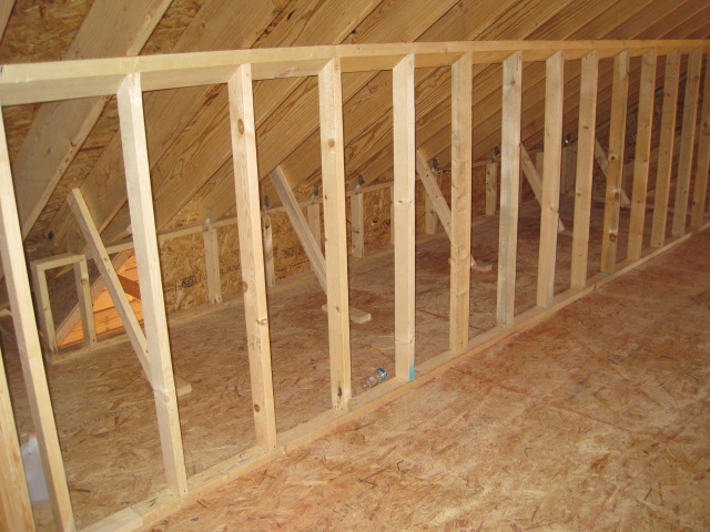

We found a company who was willing to work with us. The ceiling insulation will be blown from the attic. We will have to remove a bunch of the OSB off the floor in the attic so the insulation company can blow the insulation. In the middle/open sections of the attic, we can remove every other row of OSB. It gets trickier behind the knee walls. To remove the OSB flooring behind the knee walls, we will have to cut the OSB because the knee walls and roof braces are sitting on top of the OSB. We have a lot of space behind knee walls.

I'd skip that particular process and instead spray foam the underside of the roof and its joist areas and the same with the inside of the exterior walls from the soffit area up to where the roof rafters meet. Then install fireproof rated sheetrock on the rafters underside, as well as the knee wall areas. Put enough solid (closed cell) spray foam in these areas and you won't need to do anything else to insulate/ keep the attic and rooms below heated or cooled.
   / At Home In The Woods #1,735
The great thing about spray insulation is it seals air leaks. Which is crucial to getting the full rated R value from fiberglass batts.

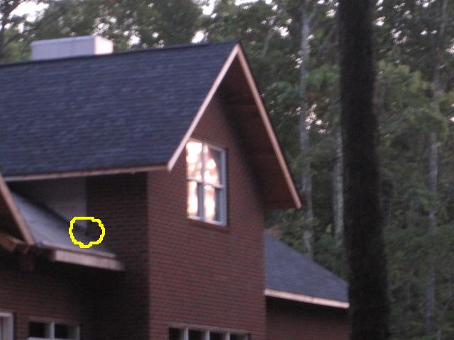

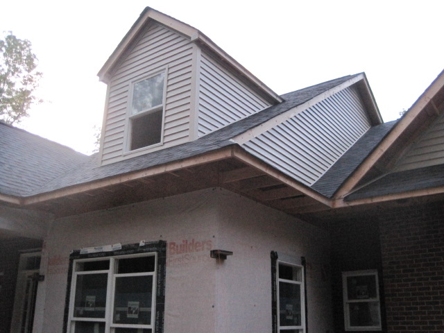

Flashing/Siding/Brick/Roofing Question
We are trying to figure out a good way to keep water from running behind the brick at the spot in the picture that is circled in yellow. Does anyone have any good suggestions?

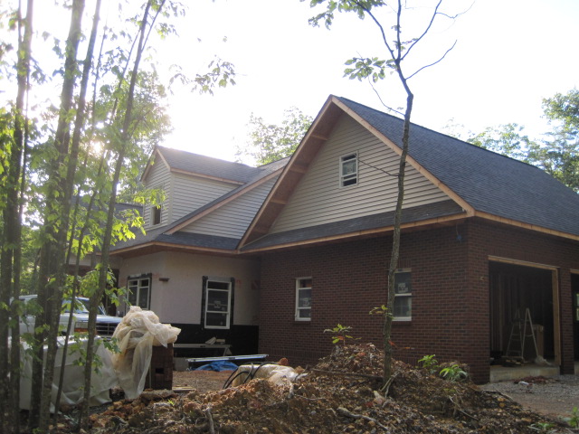

Siding Pictures So Far ...
The siding guys are Russian; their English is ok but not great. They put aluminum around the bottom of the front porch beam and slid the temporary roof support poles under the aluminum.
Not much work got done today. The siding guys got here mid-day, ate lunch, and left. The framers did not make it. The stone guy worked a half day today.
You can also see the new brick work around the porch. The brick cleaners finished cleaning the brick in one day. They used a muriatic acid solution with brushes and scrapers.
Kickout flashing, both on the wall and the roof at the joint. Given the short distance you are dealing with, taking the brick all the way to the top may have been easier, but obviously that isn't realistic at this stage.

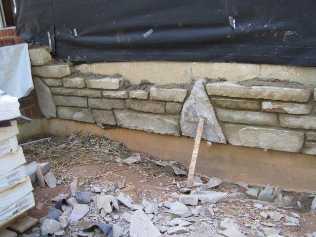

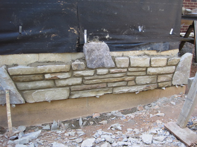

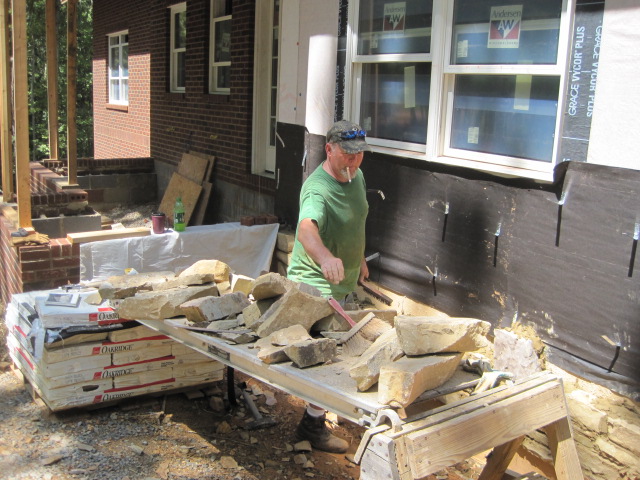

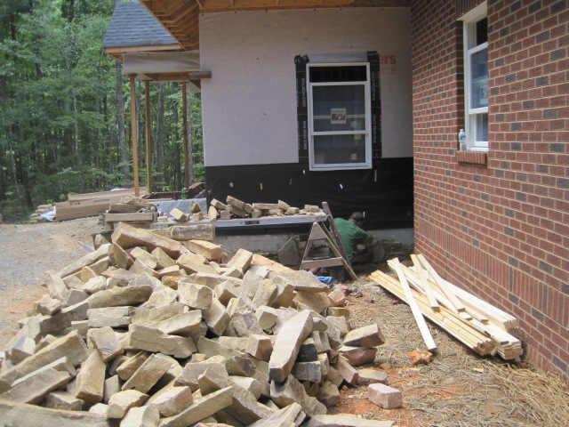

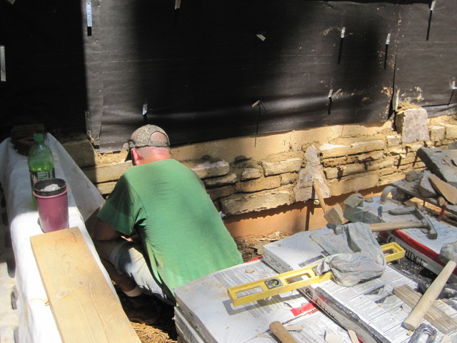

Stone work started today.
Dave,
We did consider bricking the dormer sidewalls but doing so would have required additional framing support to that section of the roof. In fact, the brickies accidentally laid brick on one side of the dormer and we had to make them tear it down.
What is kickout flashing?
Thanks,
Obed
