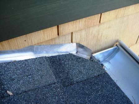

Dave,
What is kickout flashing?
Thanks,
Obed
It's basically exactly what you think it is. Here is a pic of one variation (search google for pics of kickout flashing)that should give you the idea:
attachment.php
You want it to "kick-out" the water away from the wall to get it past the joint.

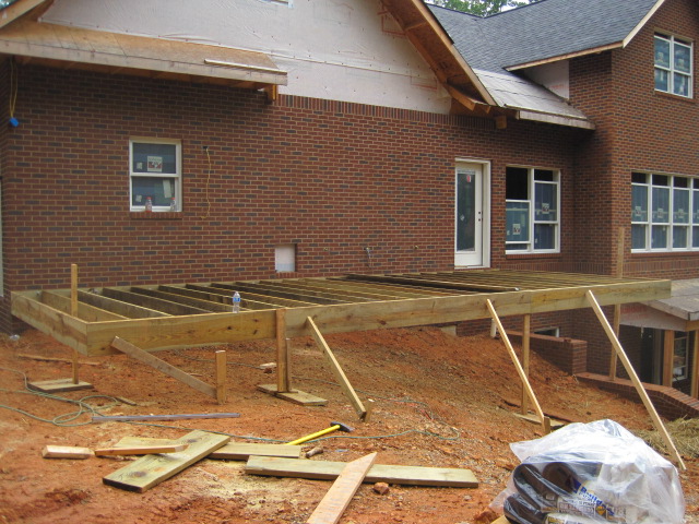

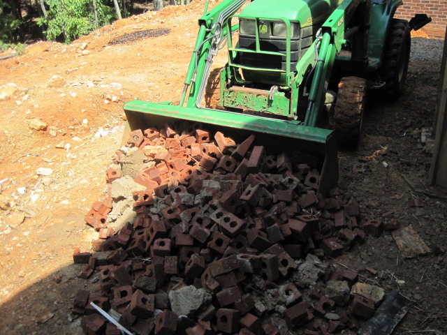

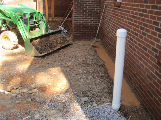

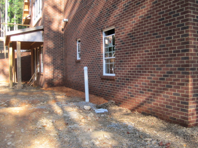

   / At Home In The Woods
#1,749

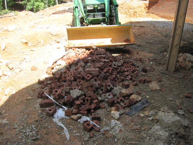

Two Long Hard Days
Now that the brick is finished, we need to backfill the footers so that water doesn't collect on them. So we started that job Saturday. Around 8 AM Saturday it rained long enough to make everything muddy and not fun to work in when you are doing digging work.
Since we don't have much depth between the framing and the footers around the basement foundation walls, I worked on cleaning all the junk left on the footers by the brick workers, mortar, bricks, sand, etc. Cleaning the footers was hard labor; my back is very tired. At about 7 PM we got caught by a heavy rain shower and we got drenched. I worked through the rain and stopped working close to dark.
My wife worked on gluing together the drain pipes shown at the end of the retaining wall. It was very tricky getting all the pipes put together and glued just right. My wife glued the contraption together the first time with the cleanout-T put on backwards. She was very frustrated at that point. However, I did that once a few months ago myself. She had to throw away her work and start over. After a lot of measuring and cutting, she got it right.
Today I worked again on cleaning the footers and backfilling. Tomorrow I get to go to my regular job and get some rest. However, this week after work I will be doing more the same stuff I did this weekend.

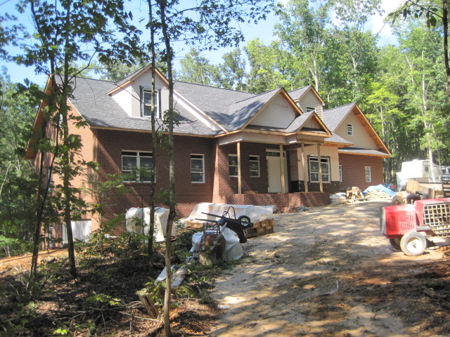

#1,750
The work on the back porch and deck started yesterday (Saturday).
In addition, all the main floor walls got insulated Saturday. I'll have to post pictures later.
I'm pleased with the brick cleaning. One big concern we had when picking a brick mason was that we might get sloppy brick work. When the brick work was going on, we had no feel for how clean the "dirty bricks" would get. The bricks are very clean. Yay!
